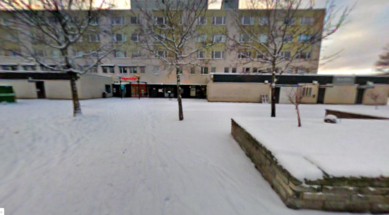

Somebody had to do it. 360 degree panorama:
http://www.lysator.liu.se/~john/qtvr/irpano/irpano.html
(Worlds first?)
You can choose flash or devalvr viewer in the pulldown menu at right bottom, and I highly recommend devalvr if you have windows, although it requires a small plugin (very easy to install).
Fullscreen is best of course (with devalvr). You can zoom with the mouse wheel.
It consists of 126 stitched images, and since it was a pain in the *** to do I wish in retrospective I had chosen a more more intresting subject, but I think it turned out ok anyway.

VERY nice!!!  You can even see the path that people have walked.
What time of day was this?  Is the dark area where the foot prints are, grass?
Thanks!

It was in the middle of the day. It was cold (-10 degrees Celsius) and the ground was covered in new snow. That's why you can see the foot prints because the ground is warmer than the snow. The brick walls nearby are also warm. Just a day ago it was +5 degrees C.
Offline john19
  • Posts: 17
Re: Flir E4 Thermal imaging camera teardown
« Reply #3092 on: January 18, 2014, 08:05:07 pm »
Here is a part of the panorama in normal light:
http://www.lysator.liu.se/~john/visible.jpg
Offline pomonabill221
  • Posts: 252
« Reply #3093 on: January 18, 2014, 08:46:14 pm »
(Worlds first?)
Thanks!
Well... BBRRRRRR!!!!
Oh really??? +5C!  a REAL heat wave!  ha!
Thanks for posting!
