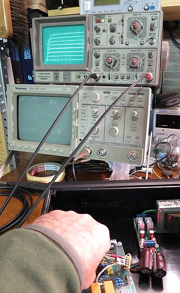

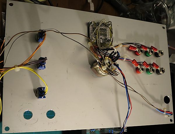

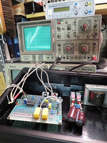

I have built one of these kits and it works fairly well but I'm having a problem I cannot address.

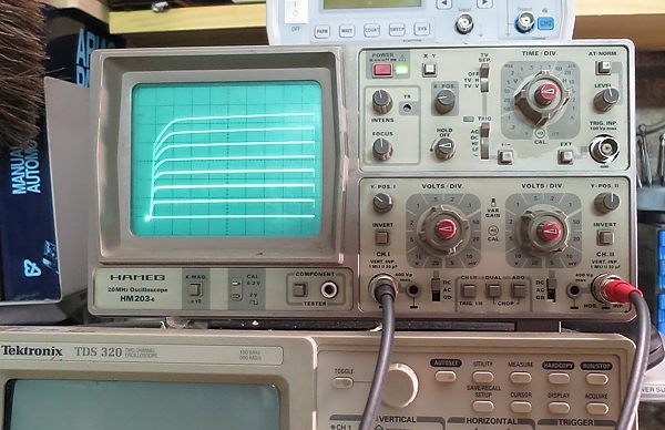

I can get quite clean curves out of this but only if I plug the transistor in its own board socket:

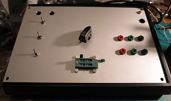

So far, so good, but I have added an outboard 3P4T switch and a ZIF (Zero Insertion Force) socket in the project box to allow four transistor matching easily, very much like Wirehead's project in this same thread, plus a couple of banana socket trios to test external power transistors:
The problem I'm facing is that this setup requires some cabling:

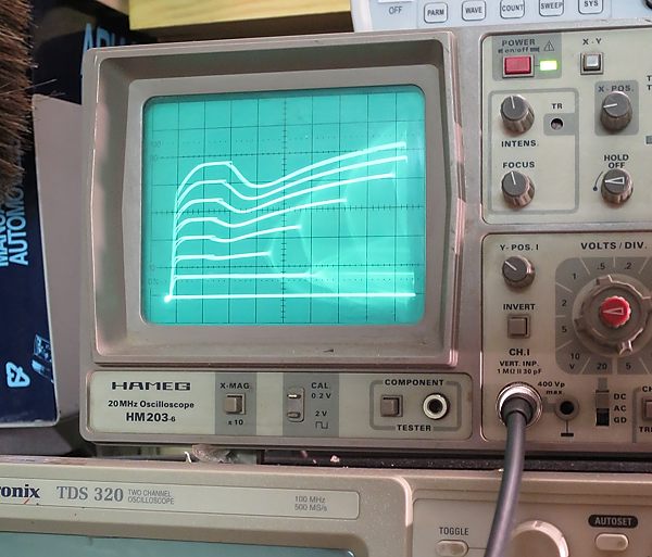

and once I take some wires out of the supplied testing socket, the curves in the scope distort big time:
I have tried using coaxial cables from the 4-pin socket to another 4-pin socket just to see if this could improve things but the distorsion is even worse:
It is courious that if I firmly grab the coaxial loom with my hand, the distorsion disappears completely:
I assume there are some stray capacitances in the external wiring but I have no idea what to do to solve this problem.
Any ideas?

« Reply #47 on: January 18, 2019, 01:36:35 am »
The thing is oscillating. Try putting a few EMI supression ferrites over the cable bunch. A few of them.
Try to use twisted wire pairs for each of the lines. Connect one wire from each pair to ground on the board side. Leave these ground wires unconnected on the remote socket side or connect them together, see if one or the other way works better.
Edit: BTW the original article posted at the beginning of this topic says connection length should not exceed 10cm, they knew long wires will create problems.
Edit: the twisted wire should have a few twists per inch, not just loose twist like in network cables. You can use a drill to make a length of twisted wire.
Also what else you can try is putting small EMI chokes right on the legs of the transistor being tested.
