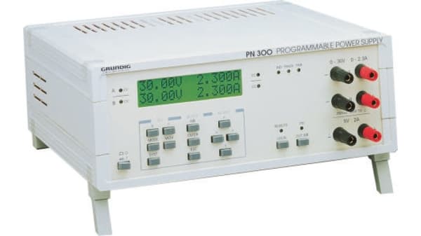

  • Posts: 4534
« Reply #121887 on: June 05, 2022, 11:29:48 pm »
That digimess stuff is Chinese rebrand garbage. Not even decent Chinese garbage but rock bottom stuff  :--
Some of it might be, idk I've not had any in my hands. This however, does not look like Chinese made, it looks low volume, low R&D budget, low design budget, mid-quality euro-tryhard. In fact, it reminds me of early TTi stuff.  https://www.ebay.co.uk/itm/234578724312
It's from rchaudio so it's overpriced. Just to prove the Grundig lineage: https://www.farnell.com/datasheets/104629.pdf
I'd pay £50 shipped.
Hmm, I had a Grundig satellite box a few year back and that was utter crap, so I'd expect this to be no better, it has a certain rarity value and that's it.
Now I know, about what that design of the front is remininding me: The Grundig PN 300 powersupply.
The Radiomuseum has some more details about it: https://www.radiomuseum.org/r/grundig_programmable_power_supply_pn300.html
Looks like, RS had the Digimess rebranded in their sortiment: https://de.rs-online.com/web/p/labornetzgerate/1590504
Rosenkranz electronic (surplus dealer) has it and is asking 199 Euro for it: https://www.rosenkranz-elektronik.com/de/messgeraete/261928/grundig-pn300
As always: nawts
Alba plc and Beko jointly took over Grundig's consumer electronics business in 2004. Since then the Grundig name has devolved to being a badge on Alba or Beko products when they want a name with a bit more class to it. At the end of 2007 Turkey's Koç Holding (the parent of Beko) took over the whole shebang, but Alba still have licence to use the name. I can't trace what happened to the bit of Grundig that made professional equipment.
People outside the UK have probably never come across Alba, but if you wanted the lowest quality consumer electronics equipment then Alba is your go-to brand.
