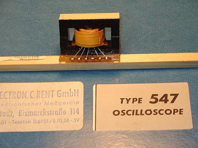

More experimentation and checking voltages on the Type 547 HV issue and unfortunately it has led to one dreadful conclusion. The HV transformer is toast. It's a very solid conclusion based upon my individual results as well as the experiences of others on the Facebook Tek Group.
I'll run through the set up and results.
Ref schematics.
The set up monitoring the HV with HV probe at the HV Test Point at the cathode of the CRT. Monitoring the grid voltage at Pin 8 of V800 (6AU5). Should read approx +90V nominal. Monitoring the +350V from the main PSU. The screwdriver is on the HV pot adjust just in case.
Upon power up here's what we got. The 8800A is on the +350V. The SDM3055 is on the grid of V800. The 8060A is on the HV. The trace is sharp, in focus, and no "blooming" or expansion.
After about 20 minutes the grid of V800 rose to the nominal +90V. The HV rose approx 70V. The trace was still normal.
10 minutes later the grid of V800 was up to +100V. And then it began to rise rapidly and I shut it down. In this pix it's at +112V. By the time I got it shut down it was +114V and rising. The HV had risen perhaps 100V and the trace was still normal.
From what I've read and seen on the Tek Group this is a toasted HV transformer. The grid will soar as high as +150V and then the HV will shutdown. But you risk damaging V800. That's probably what was about to happen when I observed the trace bloom the other day. I'm going to put the other Type 547 on the same experiment and see if the results duplicate. I suspect they will.
So what to do? The transformer needs to be replaced (unobtainium) or rewound. There's a member of the Tek group in OZ who managed to get a hand winding device and he successfully rewound a 547 and a 556 HV transformer and they perform perfectly. But here's the issue. He won't perform that work for anyone else UNLESS they fork over a pristine Type 1A4 plug-in. He says the rewind takes hours and he doesn't want to get swamped with requests. But then he flaunts over and over his repair and is being somewhat of a dickhead about it. I got a damp rope for him.
There's member in the US who claims to be working on a rewind device but haven't heard anything from him lately. There is a company in Michigan called "Heyboer Transformers" who can build and rewind transformers. You can request a quote. I can just imagine how expensive that might be.   :palm:
<snippage>
I haven't tested my 547 (got it in late spring after an unknown amount of time - doubtless a LONG time - in a damp storage unit), but am pretty sure its transformer will be even wetter than those in the scopes you have, Mike.  I've been contemplating getting a vacuum chamber and leaving the transformer in there under partial vacuum for who knows how long in a warm spot to try to dry it out.  Seems like something that might be worth a shot.  Knowing how you instrumented yours, perhaps Ill get ambitious while snowed in this weekend and run a similar test on mine and see how it behaves (assuming I can even bring it to life).  If, as I suspect, it fails, I'll try the vacuum chamber thing.
<snippage>
<heads off to look for something to use as a vacuum chamber...>
-Pat
Many applications for that in drying, curing etc. of parts and modules. How are you going to evacuate it? I think that it can be done intermittently if you can achieve a good seal. That would make it feasible using a venturi ejector coupled to a water tap, which seems to be the cheapest device.
<snippage>
-Pat
Rotary vane pump.  Bought it a few years ago (used a work project to justify it to myself) and knew it would come in handy for other things eventually.
-Pat

@med6753
I've found this article where someone used a vacuum chamber and beeswax to seal a HV transformer of a 547:
https://richardsears.wordpress.com/2015/08/23/tektronix-547/
HV Transformer, disassembled:
Vacuum chamber, evacuated:
To me, the transformer does not look that complicated. Perhaps I'm naive, but if it is toast anyway,
I would give it a try and rewind it. This time, using PTFE band as an insulation layer.
Eventually trying it first with a HV transformer from another 547 (parts mule).
Perhaps this could become a new part of your hobby ...  :-/O   ;D
and if it works, making some money just for fun.  ;)  8)

@med6753
Sadly the guy in his article also updated his blog entry to warn people that this method did NOT hold up with time... so rewiring looks like the only real good long term / reliable option, sadly  :(
But as you say, nothing fundamentally impossible, and others have already doen it before, so I agree.. it could be just a new part of the hobby !  ;D
Get good at it and I will send you mine to redo, have two 547 in my queue !  ;D

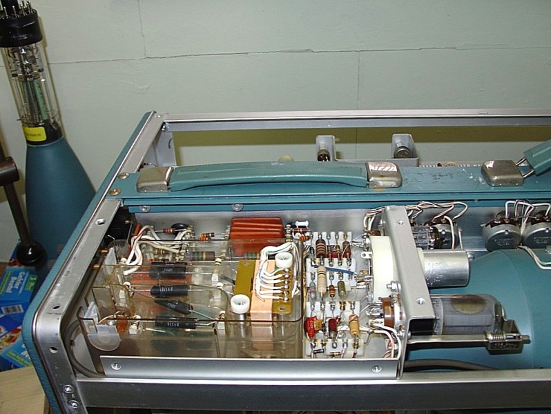

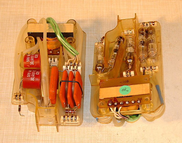

@med6753
Here in Germany is somebody selling HV parts for a 547 but one has to request a quote for them:
Edit:
This guy is also offering a repair service. He is doing this as a part of his hobby, not as a business:
Quote:
"Defekte HV-Unit, ein Reparatur-Beispiel
Bei Rückgang der Bildschirmhelligkeit mit gleichzeitiger Bildvergrößerung bis zum Ausfall des Bildes ist meistens der HV-Trafo defekt. Sie schicken mir zum Beispiel beim TEK 547 die aus dem Plastikgehäuse ausgebaute HV-Unit und ich repariere den HV-Trafo in einem speziellen Verfahren. Lässt dieser sich nicht mehr reparieren, schicke ich eine Austausch-Unit, soweit der Vorrat reicht. Das ist ein Beispiel für eine Reparatur durch Sie mit meiner Hilfe!"
Translation (via DeepL):
Defective HV unit, a repair example
If the brightness of the screen decreases and the image is enlarged at the same time, the HV transformer is usually defective. For example, with the TEK 547, you send me the HV unit removed from the plastic housing and I repair the HV transformer using a special procedure. If it can no longer be repaired, I send a replacement unit, as far as stocks last. This is an example of a repair by you with my help!
Let me know if you are interested and if I can assist you.
