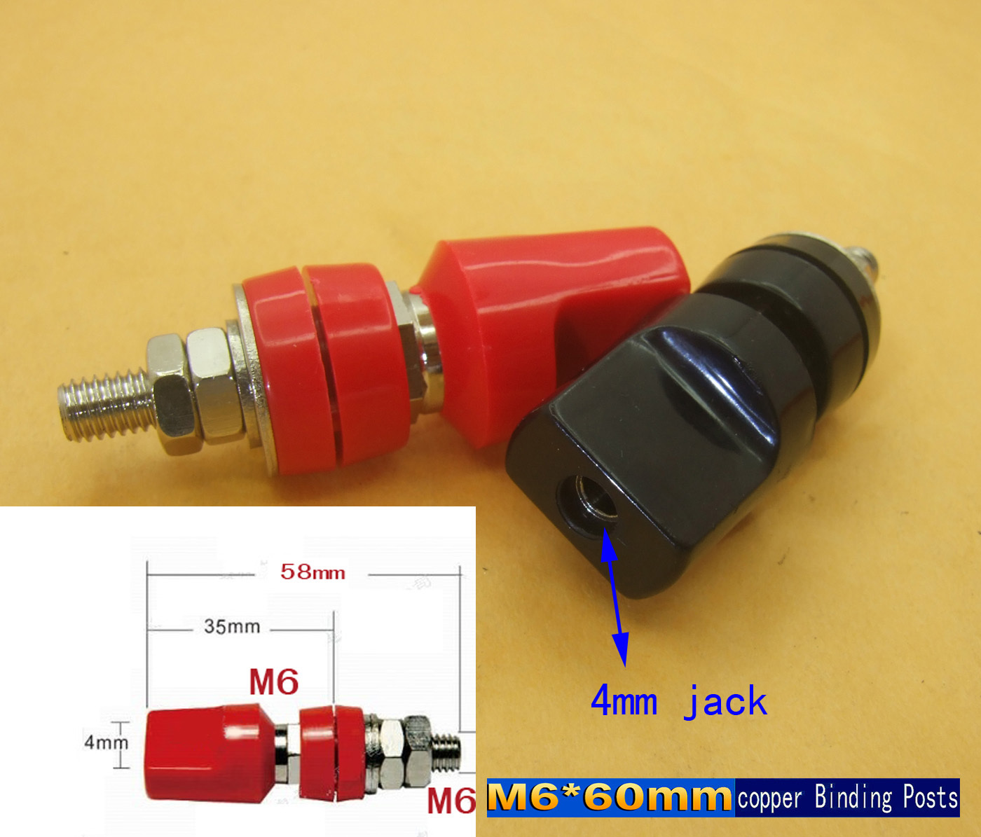

« Reply #83089 on: February 19, 2021, 08:58:33 pm »
Anybody an idea where to get these nice 4mm banana adapters for the input jacks?
There's an Aliexpress link in the SDL1000X thread for them.....bit busy to dig it out ATM.

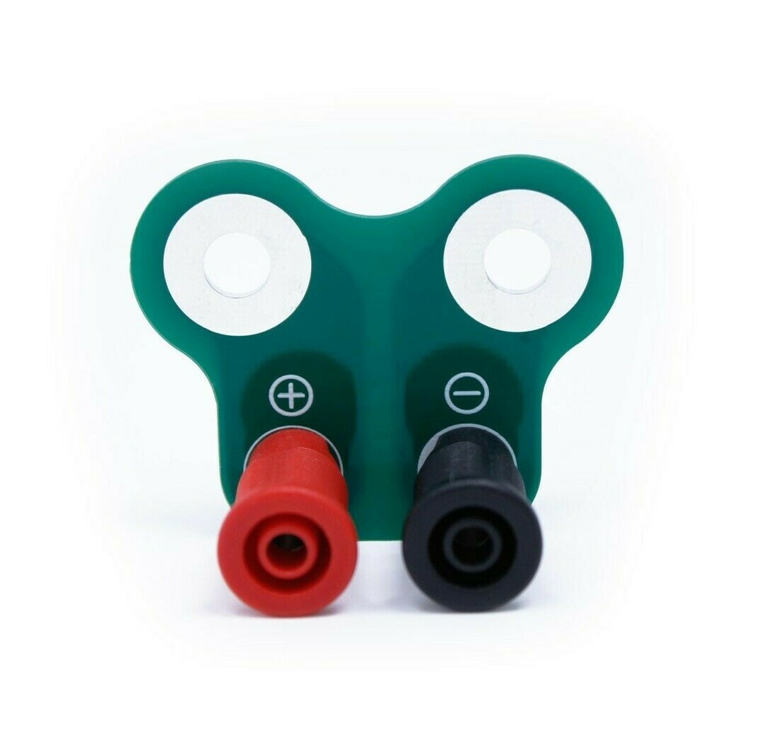

  • Posts: 4534
« Reply #83093 on: February 19, 2021, 09:12:53 pm »
You mean this one?
https://www.aliexpress.com/item/32778229464.html
Similar ones on ebay:
https://www.ebay.com/itm/2pcs-M6-60-copper-40A-Binding-Post-for-Speaker-Cable-Amplifiers-power-supply/222096799349
I meant more the PCB adapters with the 4mm banana inputs.
Like this:
https://www.ebay.com/itm/DC-Electronic-Load-Banana-Jack-Adapter-Board-/154246499734
Edit:
I've found a seller in Germany on tindie:
https://www.tindie.com/products/labshack/dc-electronic-load-banana-plug-adapter-pcb-only/
