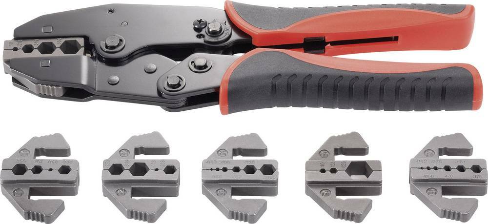

@Neomys Sapiens:
Are these crimping pliers any good? I want them for crimping BNC connectors on RG316 and RG400 cable
TOOLCRAFT PZ-505 818645
https://www.ebay.com/itm/392718039113
Plan B would be a Knipex 97 52 50:
https://www.ebay.com/itm/353127955942
R U kidding me? Tooolcraft? Blech!
On the other side, that Knipex is not cheap. For that price you could score a M22520/5-01 with a fitting insert, if you forego cosmetic perfection.  I even saw one (without insert) below 100.- on ebay.de.
One of the few SUCCESFULL aquisition in the last month were the fixed-die Suhner crimp pliers for both 50R and 75R BNC/TNC. The seller did offer one again, but I can't say whether there are still more. I payed around 10.- for one and 20.- for the other.
If you need the BNC/TNC inserts for the M22520/5-01 or the M22520/10-01 identified by Mil and Mfg. ID, just drop me a note.
I already thought that you will pull me by the ears because of the toolcraft.  ;D
But in my defense I was left unsupervised I liked the flexibility of it.
I had a look at the pliers from Daniels, very nice! Thank you!
But I think I'll go after the Knipex because I can use it for RG58/59/400 RG174/316 the same time without changing the crimping inserts.
Dammit, now there's another 'spensive tool I want!   |O
-Pat
