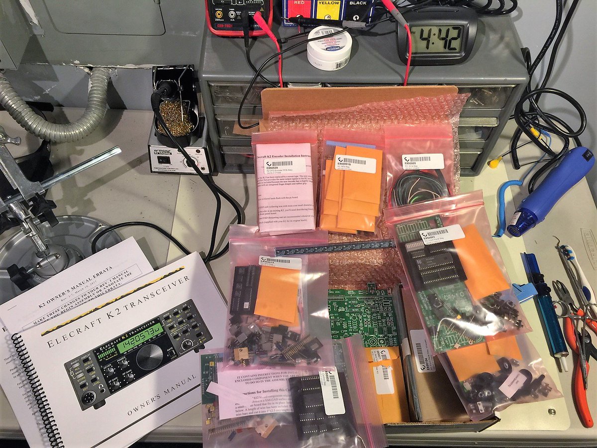

Edit: still considering the "fuck it" option and buying this K2 kit. This is what you get for your money:
« Last Edit: February 12, 2019, 08:55:56 pm by bd139 »
Is it an actual "kit" that you assemble or are you just using your generic British "kit" term?
It's an actual kit of parts you have to assemble and align yourself:
Should be fun...go for it!  :-+
