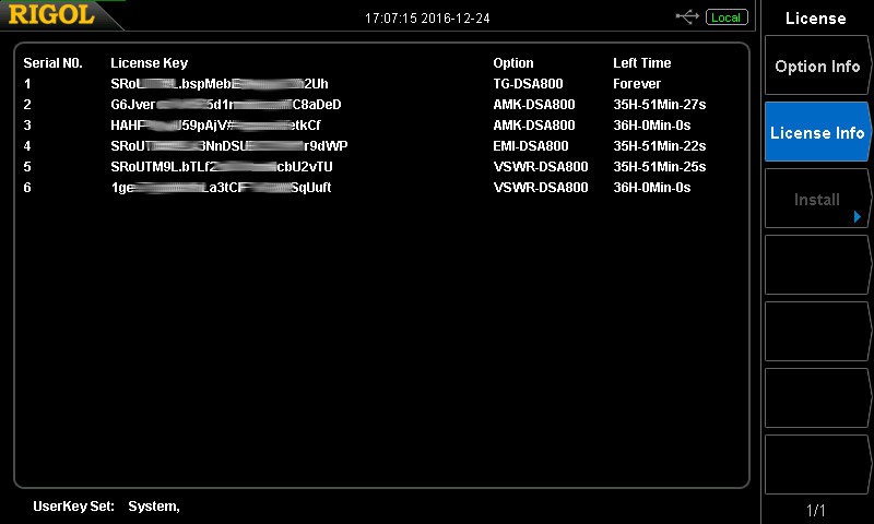

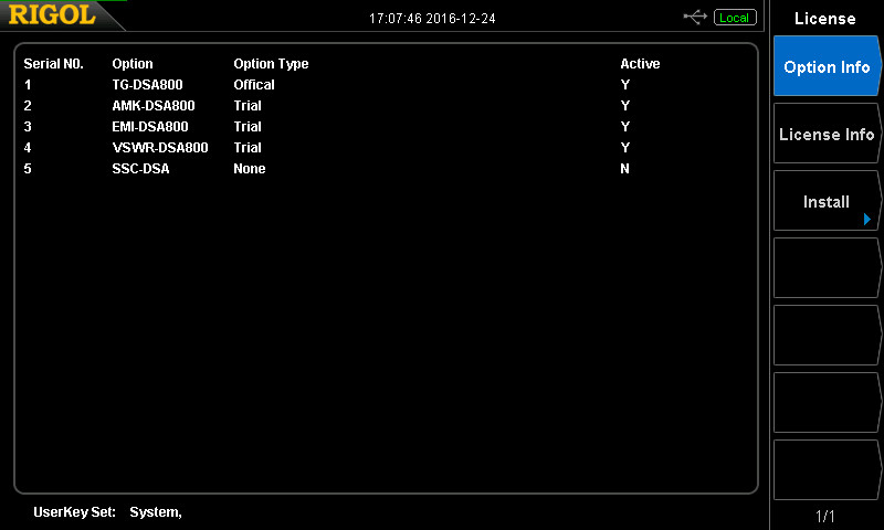

« Reply #842 on: December 07, 2016, 06:45:19 pm »
I have a DSA815 with old Bootverision 01.02. With firmware version 01.07 all licenses with the key generator were entered. I have not used the write protection of the FRAM.
The firmware was updated step by step up to current firmware 01.18.
Now I have entered a trial license for the SSC-DSA option, and then activated the write protection of the FRAM.
After switching on, the trial time is counted down, but after a new start the time starts again with the time of the write protection activated.
Peter
Good day All
First I would like to thank all the members here who have dedicated their time to furthering the hackability of the Rigol DSA815-TG.
I just purchased the DSA815-TG and wanted to say that it came with All functions operational as Trial with 35 plus hours out of the box, except for the SSC-DSA option.
I have attached photos of the license screen.
My questions is; since the wanted options are enabled now, should I do the FRAM write mod.?
I see from the above that the mod. does indeed work with  the 1.18 firmware, but what about the *new* hardware that this model has?
All ideas and opinions are welcome, as I really want to keep the VSWR option functional.
Thanks
take care, peace
lost_bro
EDIT: added firmware photo.

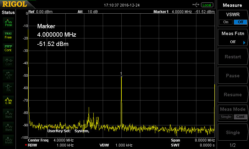

Hello everyone,
First of all, let me thank you all for all the precious informations shared in this topic. I will try to do my part now, as much as possible from me. I just finished reading all 35 pages of posts in this topic and I must say that I learned a lot. Thank you all!
Now, I own one DSA815-TG since February and so far, I am happy with it; although, I have not given it much use until recently.
Right now, my SA has the latest firmware available (1.18) as shown below. Also, this SA hasn't been hacked, opened or modified.
One thing I read in some topics (page 22), is about the "missing steps" in the power sweep. So, I tried to replicate this function and I think the thing has been solved as you may see in the picture below:
If anyone would like me to do some experiments, please feel free to ask. Also I need the experiment procedure detailed so I can do exactly what you want (as long as it doesn't imply to open the instrument).
Now for the down side of updating my SA to the latest firmware version. Before the update I had firmware version 1.12 and about 23 hours of trials left. The update process went smoothly without a problem, except that, at the end, my trial timers were set to ZERO. I contacted the SA vendor (in Europe) and they provided me some new trial licenses for some of the options I still wanted to try. I installed the licenses as per normal procedures, they got installed, but the option aren't active, as one can see in the following screenshots. The final result is that I have the trial timers with 36 hours but the options inactive... |O
Contacted the vendor again (as a pivot to reach Rigol) and the answer was that Rigol said that there may be some incompatibility between the hardware and the new trial licenses... I will try to contact directly Rigol Europe or whatever to try to solve this issue. Any feed back I have, I'll post here just in case it may be useful to someone.
Best regards to all,
Emmanuel.

Offline airlomba
  • Posts: 22
  • Country: pt
Re: Spectrum Analyzer - Rigol DSA815
« Reply #846 on: December 22, 2016, 08:11:13 am »
I had exactly the same issue with mine. Funny thing is: After some time of use (must have been 10 to 20 hours), the original trial licenses magically reactivated themselves with full 35 odd hours

Well, that didn't take too long.   :phew:
Having my SA turned ON since my last post (plus a few hours on the other day), I've been using it to play around with a Colpitts oscillator... The result is as shown in the pictures below: I have my trial periods back on time! :-+
The first picture below shows the Option Info page, exhibiting that the options became active, again.
What is curious about this, is the comparision between the two following pictures.
The first one shows the License Info page before the timer restarted counting down. The second image shows the same page, after the timer restarted counting down. The curiosity is in the fact that only the old license codes (2, 4 and 5) are counting down and not the last installed ones provided by Rigol (3 and 6).
Finally, I publish a last image showing the Measure menu with working colors (instead of grey).
