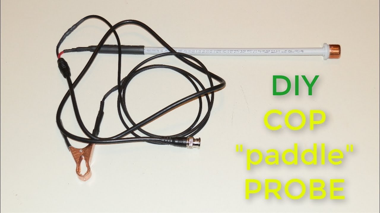

Do not attempt to monitor the secondary of ignition coils via a directly connected anything. Monitor the primary side which mimics the waveforms of the secondary.
Here is a typical spark event captured on the primary side the ignition  coil;
The 250 VDC spike is what is required of the coil's output to ionize the plug gap--on the secondary side this would be 12 to 15 kVDC. THe flatter and lower voltage portion is the actual plug firing event, 600 V to 1.5 kVDC on the secondary side.
This capture is the primary side of a COP on a 2003 Mustang GT V8;
Note that the engine control system fires the plug three times in rapid succession. It does this to ensure a full and complete burn at idle, and up to 1100 RPM or so.
THe Hantek HT25 is an inductive pickup probe, it's output to the scope is < 1.0 V -- BTW, you can make one of those with a copper pipe cap and a piece of PVC pipe.
Here's A YouTube video of a fellow making that pictured above.  There's not one bit of magic involved.
