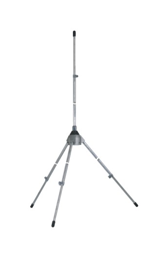

SWR shortened antenna, image as above.
SWR as above, wider span with marker on frequency of interest.
I'm fairly sure this monopole is gunna need a ground plane to be effective......now to find something around here that's suitable. I might have some shielding mesh somewhere.......

« Reply #120 on: July 20, 2018, 08:49:23 am »
SWR still looks bad, is this what you are measuring?
If so, that does not look like a DIpole (2-pole) but rather just a 1/4 wave whip, or what should be a quarter wave. A dipole does not need a ground plane (because it has 2 poles already) but this one does. It looks like it is mounted on a metal box, that could be enough for a ground plane. Anyway, looking at the SWR and the picture I think there is some metal behind the antenna isn't it? That is why your SWR sucks, the metal is reflecting the signal back to the antenna.

So this one?
Do you have a better picture of the actual antenna or is it just a piece of metal sticking upright? Where is the coax shield connected?
You can easily convert it to a groundplane antenna by using 3 or 4 equal length wires connected to the coax shield and pointing down like this:
I still think your SWR sucks…

Yeah I know, it's shit.
The copper rod is pressed into the turned nylon bush and the coax center connected below.
I'll turn another step on the nylon bush and connect the braid to some mesh that sits on the step.
Not sure what I have for the mesh and that will entail a rummage around in the morning. I have heaps of 1/4" copper rod but setting ground plane 'fingers' up so they'll withstand the weather is troublesome in my mind.
I think it'll be easier with mesh....I'm sure I have some perforated mesh somewhere as I'd rather not use the 3/4" chicken mesh that I've got plenty of.
I made all this years ago and now with a SVA I have the chance to get it right.
The short length of stainless sitting in the BNC socket works so well as the control cabinet provides the ground plane and it still receives transmissions even though it's in a tin shed.  :o The hockey stick monopole is just LOS from where we send the signal from inside the house.
Thanks for the pointers, I'll sleep on them.  :)

One more thing: the angle of the radial(s) should be about 45o for an impedance of 50 Ohm.
