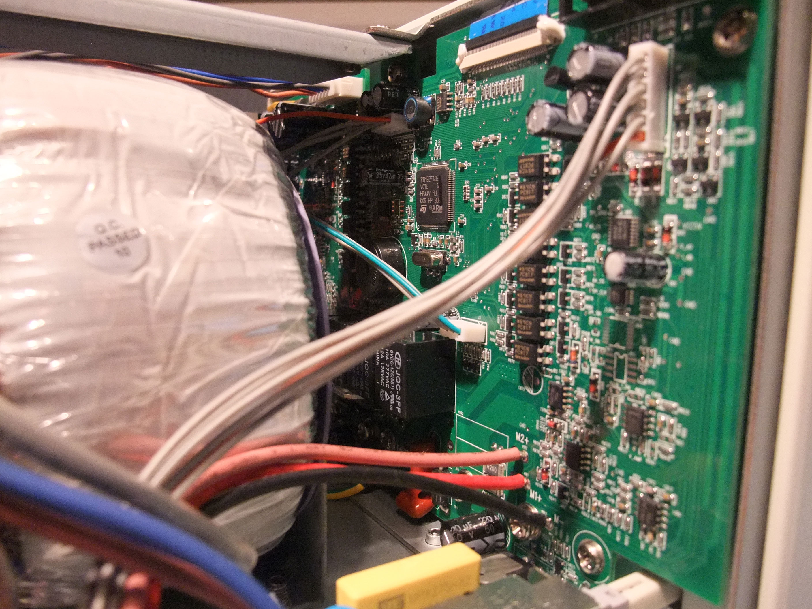

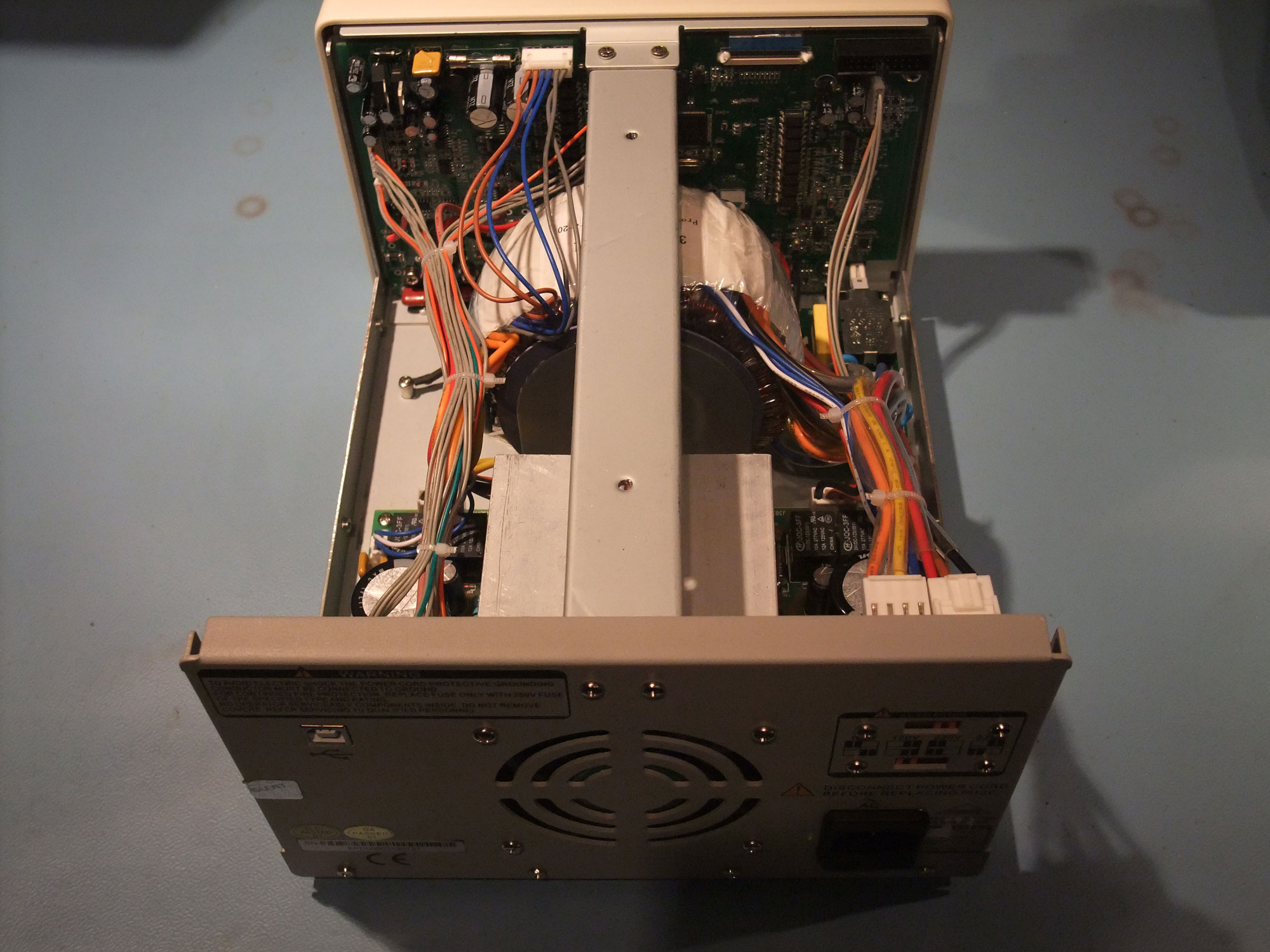

My short review of the SPD3303D:
The test in the video starts with a serious problem on channel 3, with the fixed voltages output: there are big voltage spikes (up to 7V), even with load, if you turn it on or off. And it overshoots, if you short the output. UPDATE: see here how to fix these problems.
But there were no problems on channel 1 and channel 2 and it can be even used for a hand drill.
I opened the case at the end of the video, but it is not a full teardown and very short, because I don't know much about analog electronics anyway.
Not shown in the video:
  • one hour load test with 8 ohm on channel 1 and channel 2 each, and 2 ohm on channel 3. The fan starts, not too loud, and the power supply survived it
  • if you want to use the PC software, you have to instal the NI environment first: http://joule.ni.com/nidu/cds/view/p/id/4230/lang/en (the registration doesn't need eMail confirmation, so enter what you want)
  • I've tested the channel 3 a bit more, and on the 5V selection there is a voltage of 82mV when turned off, 48 mV for 3.3V and 46 mV for the 2.5V selection. Can be loaded with 2 ohms, still there.
  • problem with "all on/off": if e.g. channel 1 is on, channel 2 and 3 are off, and then I press "all on/off", it turns all channels on. I would expect that it turns any channel off, which is on, but maybe it is just me who is surprised by this feature :)
  • lock-key: in lock-mode, it is still possible to change the voltage from the PC
  • parallel and series mode: in parallel mode, channel 1 and channel 2 are parallel (and available at the terminals at channel 1), for currents up to 6.4A, and in series mode channel 1 and channel 2 are linked in series (and available at the negative terminal of channel 1 and the positive terminal at channel 2), for voltages up to 64V. Unfortunately it is just a relay internally, the display doesn't sum the voltage or the current and it is the same, as if you would link it externally (which is possible, too, because the channels are all independent of each other)
  • wave display: this shows a waveform of the voltage and current. Can be enabled individually for each channel. It is difficult to read, because there are no scale lines and it has no auto-scaling.
As said in the video, my conclusion: the power supply is not perfect, but it is nice for the price and I would buy it again.

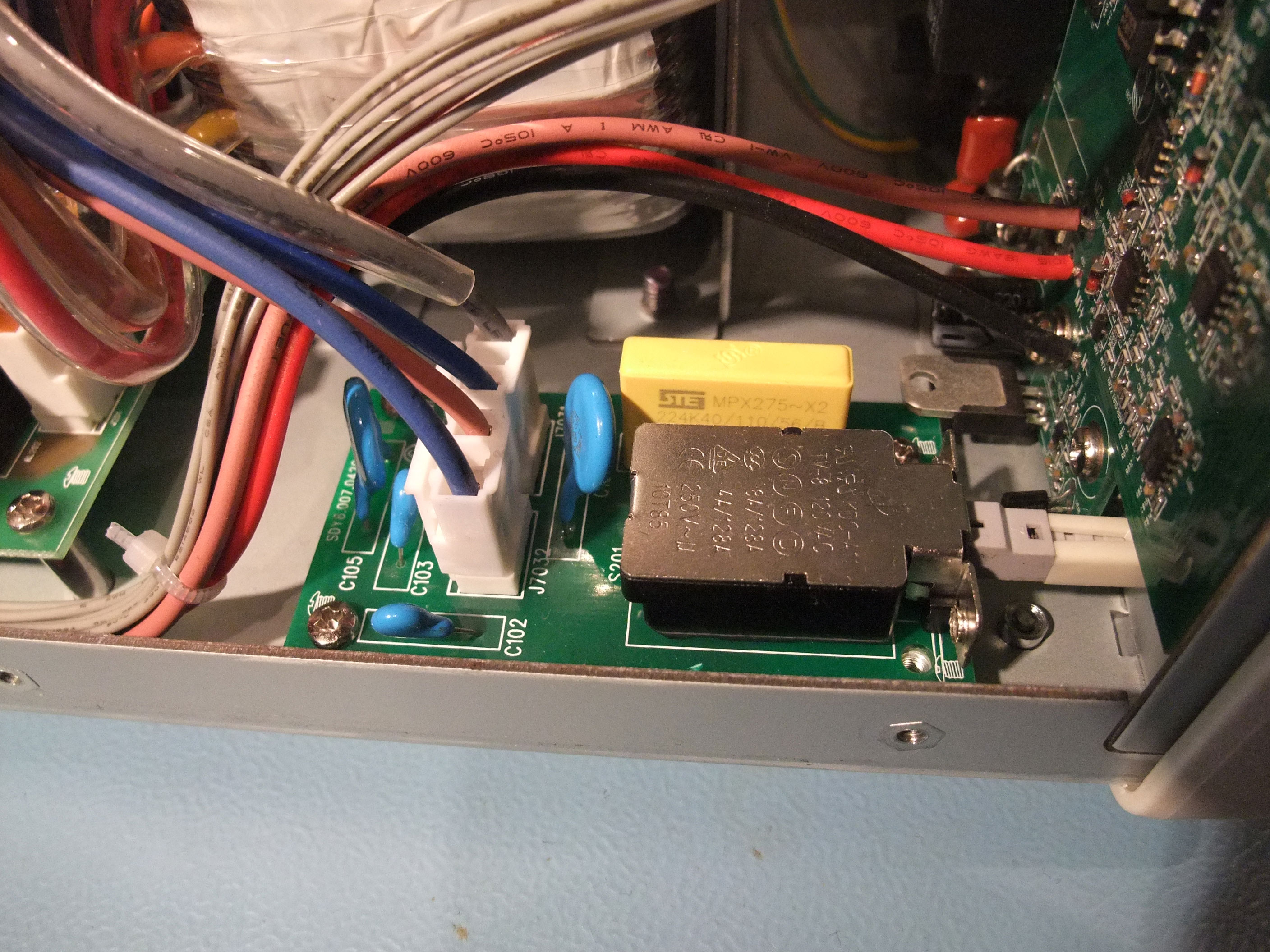

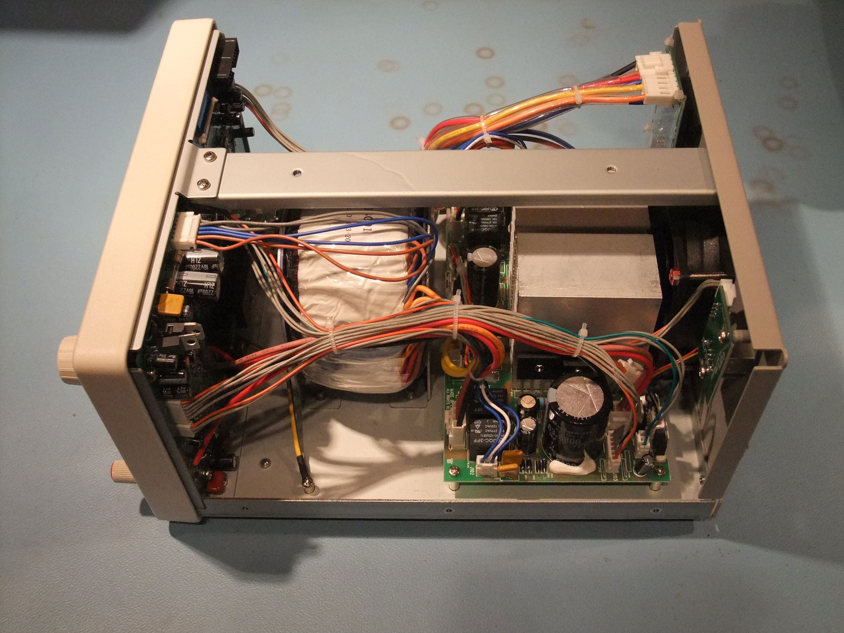

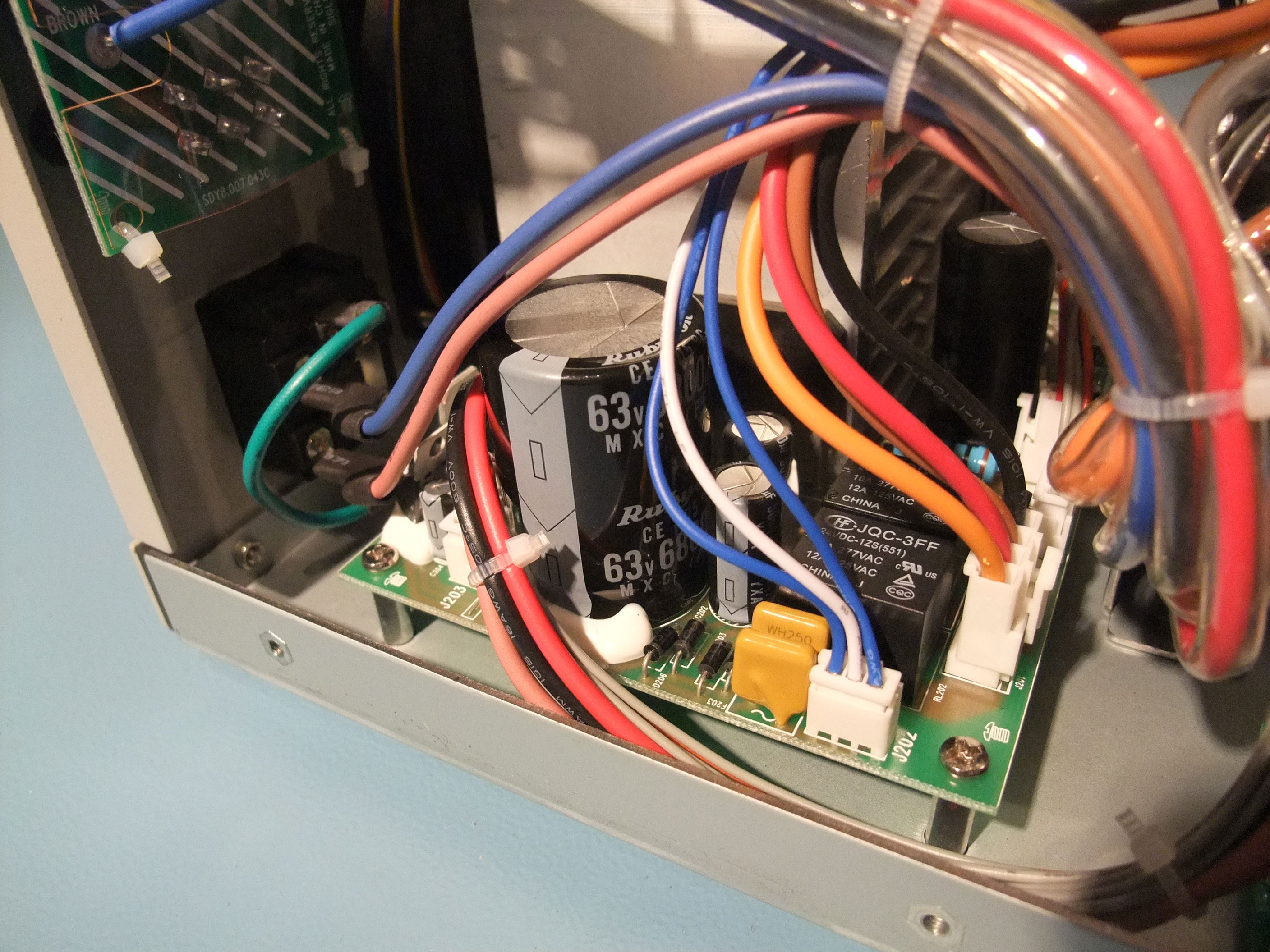

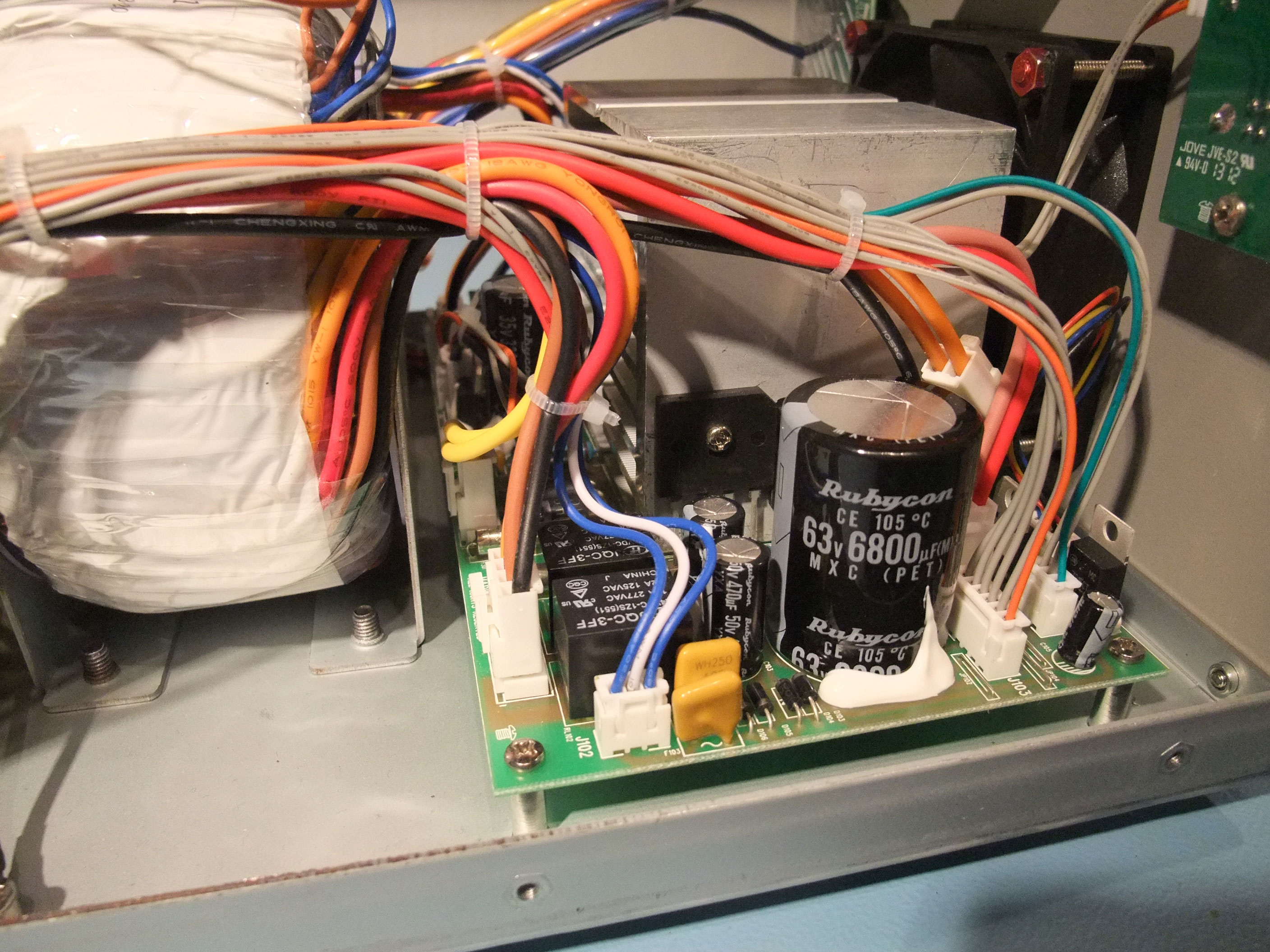

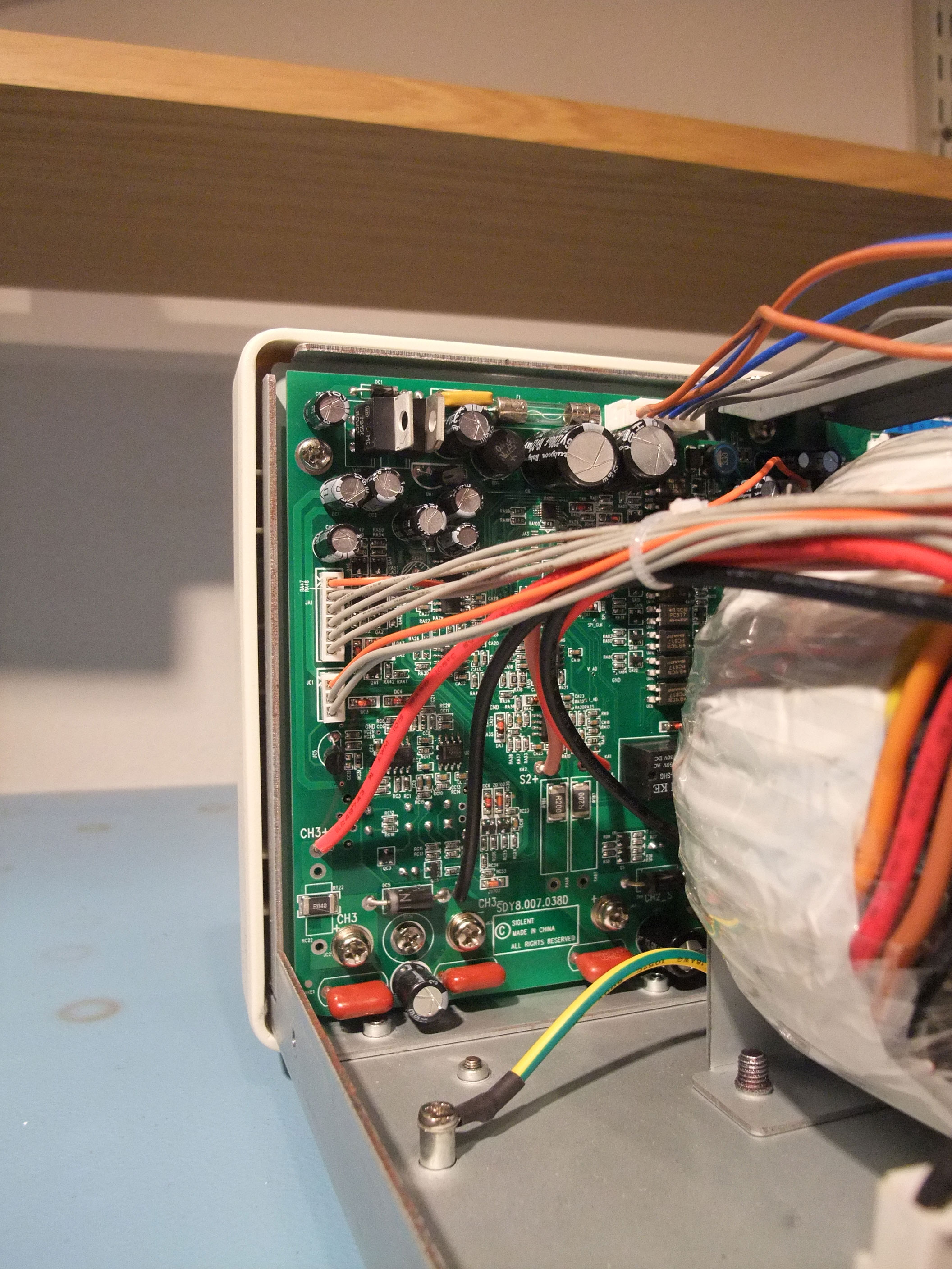

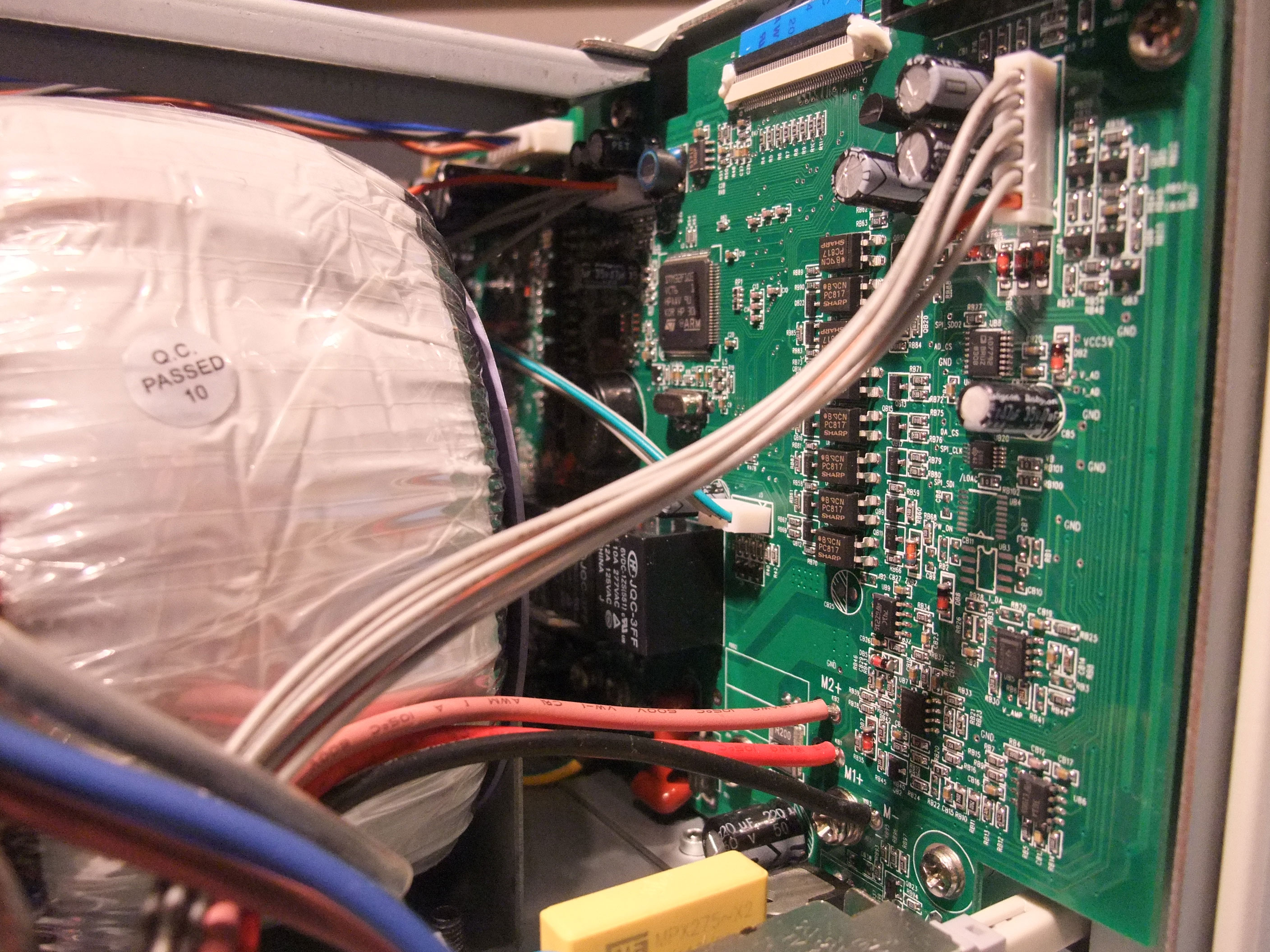

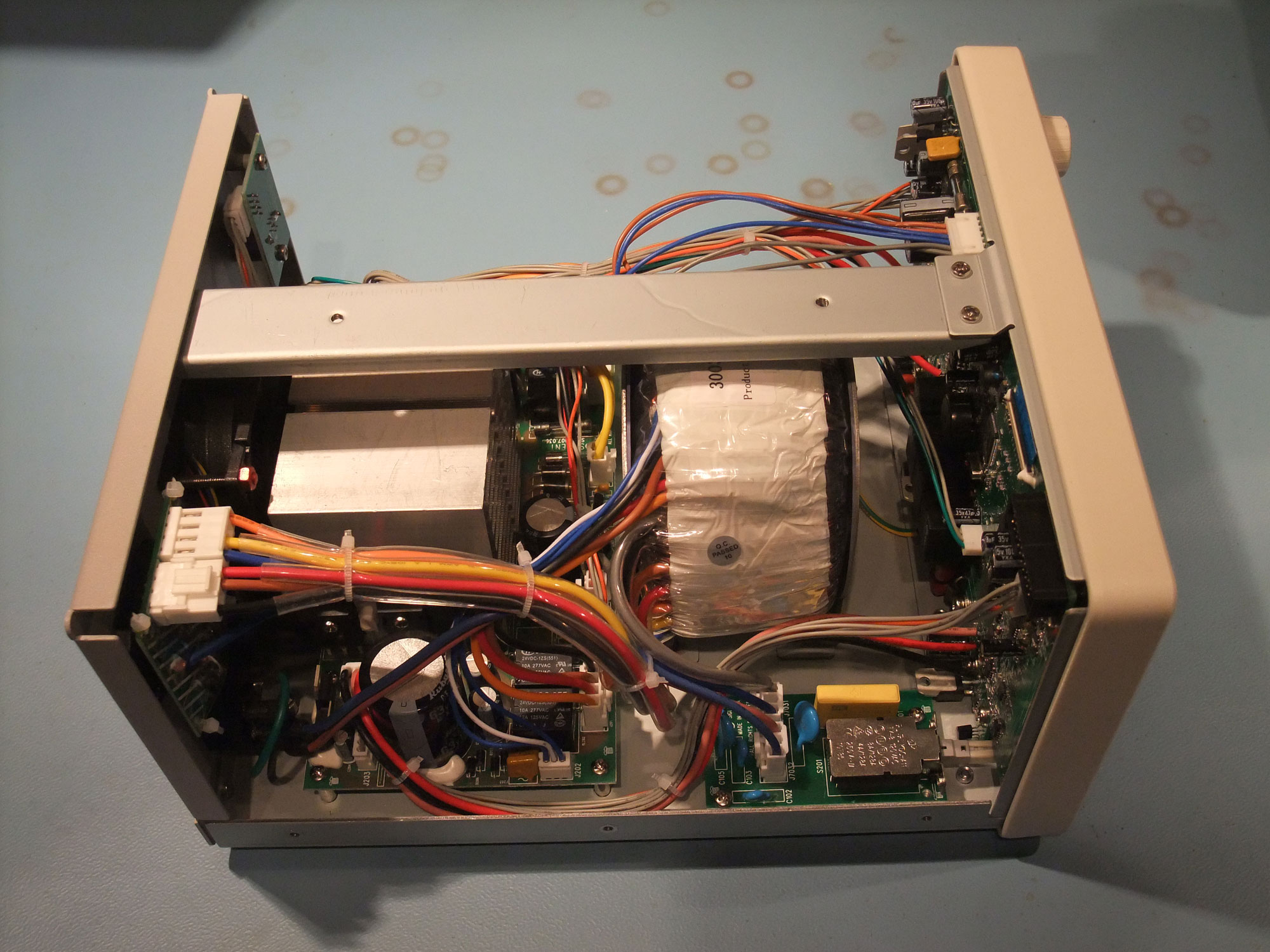

High resolution photos:
logic board, left side
logic board, right side, far focus
logic board, right side, near focus
mains switch
regulator board, left side (there is some rust)
regulator board, right side
top view, back
top view, front
top view, left
top view, right
The mosfets on the heatsinks are IRFP150N. There are two of them on the right heatsink, but only one on the left heatsink, and looks like a temperature sensor is mounted instead on one heatsink. And there is another big 4 leg IC on each heatsink, which has no label (doesn't look like it was sanded, just mounted the wrong way on the heatsink). On the logic board the main microcontroller is a STM32F103. There are some PC817 photocouplers and some JQC-3FF relays.

The warranty seal is broken anyway, so I've updated my first posting with some photos.

« Reply #10 on: September 08, 2013, 02:35:13 pm »
I think that would be the rectifier bridge.

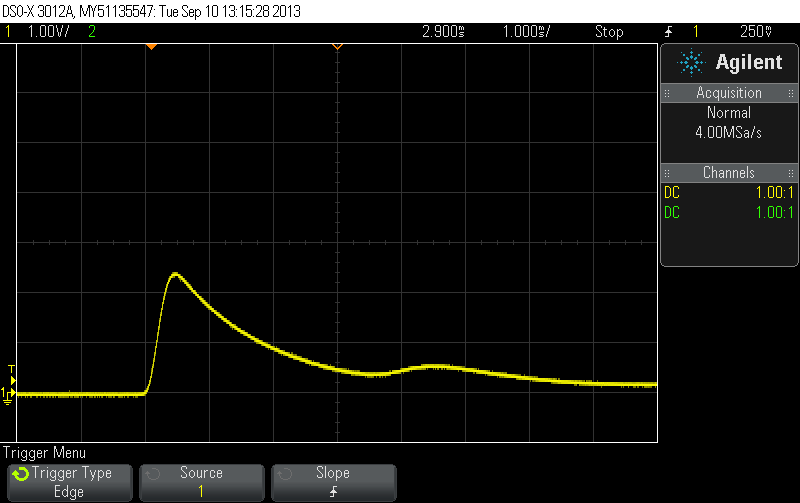

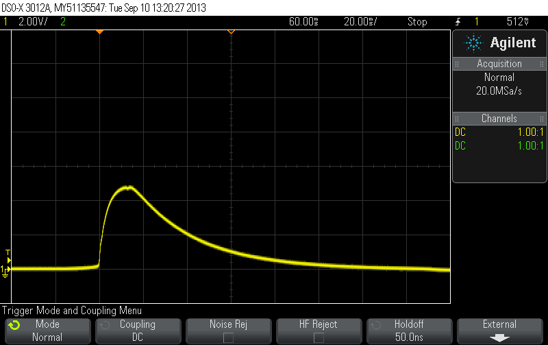

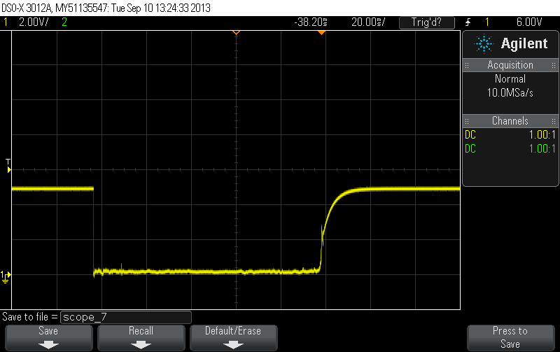

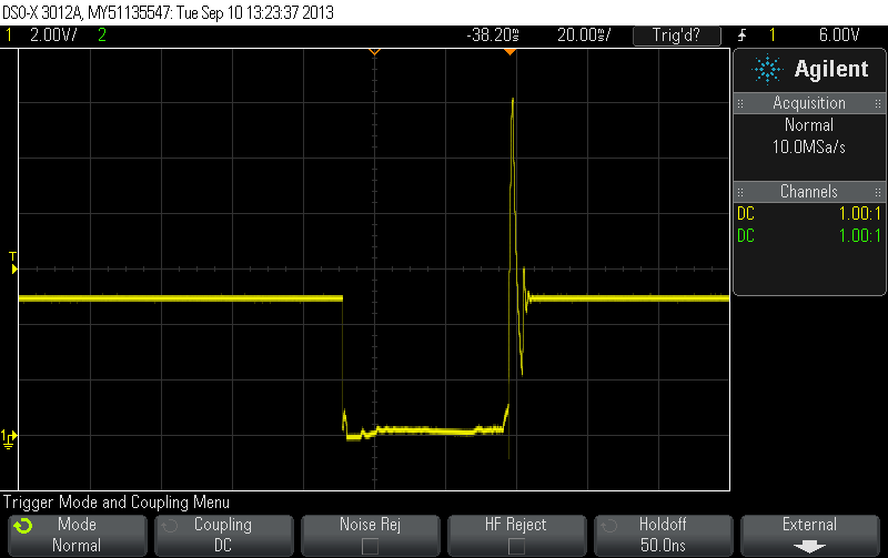

I've done some scope plots for the problem on channel 3 and sent it to the support. It doesn't need to be a problem of the PSU in general, maybe my unit is just broken, but I doubt it. Maybe someone can verify it with his/her unit, if you have the same PSU?
I loaded channel 3 with an 8 ohm resistor, then I turned the PSU on with the power-switch (the PSU was turned off a few hours before). As you can see, there is a 1.5V spike, falling down over some milliseconds (1V and 1ms per division). The voltage selection for channel 3 was on 5V. If I turn it off for just a minute, and then on again, the spike can be even higher, I've measured up to 7V. There should be no voltage at all, because the channel is turned off initially when I turn on the PSU.
Same setup, this is what I see when I turn it off with the power-switch, and channel 3 still not enabled. A big 5V spike, falling over 100ms. And this is at 0,6A, because of the 8 ohm load. A sensitive DUT could be destroyed by it.
Same setup, channel 3 loaded with 8 ohm, the channel output was turned on with the CH3-ON/OFF switch, and then I shorted the output. As you can see, there are some serious overshoots, up to 12V! If I have a sensitive DUT attached and accidentally short the power supply outputs momentary, it could be destroyed by such overshooting. I don't trust this output at all anymore, because maybe there are some other overshoots, depending on the dynamic behavior of the DUT.
Just for comparing this with the other channels and to verify my measurements: same setup, but this time for channel 2 (8 ohm load, turned on). I shorted it momentary, as with the test for channel 3. As you can see, nice regulation without overshooting. Same for channel 1, no problems.
As I have already reported in some SPD3303 threads before, I too have a voltage spike on CH3. I have SPD3303S HW ver. 1.0. It goes up to 12V on mine. I haven't tested the overload recovery overshoot. I can post some oscillograms later.
  • Posts: 2368
    • Frank Buss
Re: Siglent SPD3303D review
« Reply #13 on: September 10, 2013, 02:13:59 pm »
Thanks, so my unit is not broken. I hope they know a fix, or we have to reverse engineering the circuit and try to fix it ourselves :)
