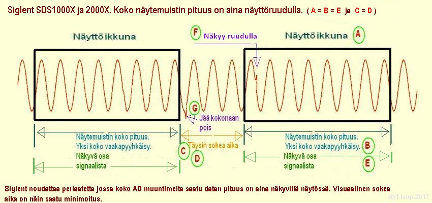

As told previously. It looks like for automatic measurements SDS1000X/X+ use 70k data.  (tests made using SDS1102X+)
If 1 channel is in use real time one shot samplerate is 1GSa/s if t/div is 1ms/div or more fast.
If in this case t/div is 5us/div sample buffer is 70k aand every separate samples have own place in buffer.  Display waveform length is always on the screen 700 pixel. Independent of time base.
If t/div is 1ms/div sample buffer length is 14Mpts. Whole buffer length is (always) same as display screen widht. All sample points are mapped to display. It do not never drop out samples. But when there is more than 700 samples then group of samples are collected to one time position on the screen pixel map. In attached example image there is 70k sample buffer. Display have  700 pixel colums (in wfm area) so there is 100 sample for one display column.
If sample buffer length is 700k then 1000 samples and so on. In this case,Measurement Buffer Legth is still 70k. What happend now. Now need push 10 samples to one place in measurement buffer. And how it do this - I do not know and I have no evidence if it just do raw decimation or something more clever. When time base is more slow, sample buffer lenght is more (if user have not set limit) This means of course that horizontal (time) resolution for measurements drops. For 700k memory 1GSa/s effective resolution for automatic measurements is 10ns.
In image there is used dot mode and slow acquisition so that every screen refresh have only one wfm. This is because I want see rising and falling edges separate sample points.

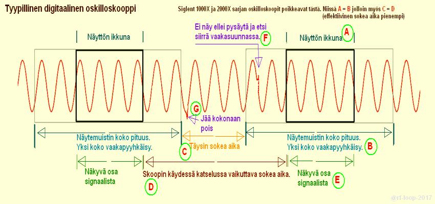

So many times there is claims that Siglent decode only from display.
If people is not familiar with oscilloscope what use:
What ever acquisition memory length is, it is always same as displayed waveform length on the screen.
Siglent do not never hide part of acquisition length outside of display window.
When Siglent decode it decode active display width, only. Yeas only. But dispplay width is whole length of acquisition memory. If it is 14M or 1.4M or what ever, whole memory length is mapped to display.
Sorry these images are by finnish language. But perhaps they can give some help.
Noname usual DSO.
Note what is blind time and real user visible blind time.
With some settings visual blind time may be lot of, due to fact that diplay width is very very narrow related to true acquisition length.
A = Display window
B = Acquisition length
C = Really blind time (user can not see, oscilloscope can not see)
D = User visual blind time is same as really blind time.
E = visible part of signal is same as whole signal what also oscilloscope can see.
G = This random peak oscilloscope can not detect at all
F = This random peak is also in displayed area.
       I
Siglent SDS1000X, 2000X
In Siglent A=B=E  and  C=D
A = Display window
F = This random peak is captured but user can see only if he stop and scroll this area to display
       (if you have good luck it exist in this acquisition when you stop, typically these scopes also
        do not have history buffer)
Example if sample memory length is only 1kSa  and 500MSa/s is in use and horizontally 2ns/div.
If display is 10 div width there is 10 sample period on the display and 990 sample points invisible outside of scope screen and what ever there is you do not see it. You are blid for there. Also between every aacquisition there is time what oscilloscope do not acquire and do not even wait trigge. This is real blind time if think oscilloscope. User visual blind time is this + this part of signal what is not displayed.
With Siglent you always see all what is captured. Even if memory length is 140M it is mapped to display width. There is not any reason for overlapp signal outside display. Hw based Zoom is for it.
With this kind of scope user need lear bit different practice. If you want long acquisition but still want look narrow window to some signal detail. Just use Zoom. Using Zoom window scroll function you can easy and fast move to different places in whole acquisition. Just push forward or backward button and toggle for speed. (FW 13R5)
