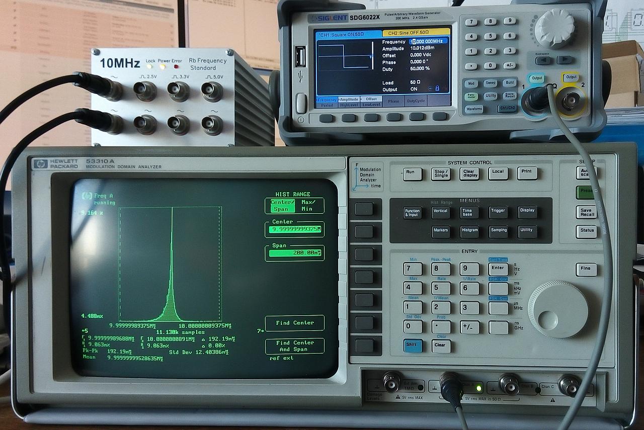

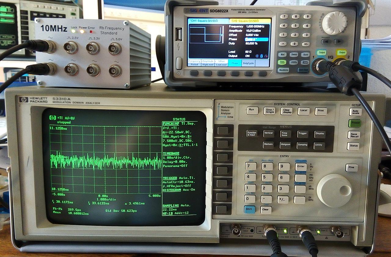

Today I conducted several more tests with the SDG, among them also an attempt to "liberate" the instrument differently with apparently better results than before. Still I find some peculiar characteristics of which I'm not sure if they are correct. But let's start with a video clip of the instrument in its original configuration. My main objective was to decouple the output waveform from triggering of the oscilloscope. Fortunately, the SDG6000X features an AUXiliary connector at the rear that provides a sync signal if configured that way.  Unfortunately, the disappointment followed almost immediately after connecting it to the scope and powering it up -- there's considerable jitter between sync and the output phase and the sync is only available up to a frequency of 10MHz   ::). Anyway, here's the first clip, me demonstrating the sync / output jitter and some other strange stuff:
http://www.turbinemuseum.de/files/SDG6000X/SDG6000X_org2.mp4
After that I decided to have another go at "liberating" the machine, this time utilizing a different method. I won't go into detail here since I'm still not sure if it's a good idea to try this but whatsoever, apparently it worked a little better this way. At least the malfunctions of the waveform buttons have disappeared. Still, I find considerable "undulation", especially in pulse mode with 1ns rise/fall times and short pulses (< 10ns). At rise/fall times >= 2ns, the undulation almost disappears. I'ld be glad if someone could try to replicate this experiment with a fast scope. Regarding the scope that I use I've got to add (to eliminate any abiguities right from the start) that it's an "improved" Rigol MSO4014. Since Rigol themselves offer these bandwidth upgrades for this model, we can safely assume that the hardware is capable of the "liberated" bandwidth. It's upgraded to the full 500MHz, reporting the improvement as "official" . Here's the clip:
http://www.turbinemuseum.de/files/SDG6000X/SDG6000X_lib3.mp4
I'ld be really glad for some feedback regarding this test since it will help me to understand if my SDG6022X has got a problem or not.
After that and after having seen all the jitter and wiggles and whatnot, I thought to myself that it's time to pull the HP 53310A Modulation Domain Analyzer from the basement and have a go at the SDG6022x...  >:D
To cut a long story short, in general the SDG is performing quite well IF an external reference gets used. The internal reference -- well, let's put it that way -- could be better...
The MDA basically is a very fast, very accurate frequency counter with integrated digital processing to provide a graphical representation of the measurements (especially histograms). It's primary display mode is frequency vs. time but it can sum up the results (just like a multi-channel analyzer) to provide a histogram that somewhat resembles a spectrum, yet it's not the level on the vertical axis but the quantity of the measurements that fall within the limits of that channel.
Most of the measurements I did are close to the limit of the MDA since the performance of the SDG6000X is quite good. But anyway, it shows some interesting details of the instrument.  Please bear with me for the many large photos I attached:

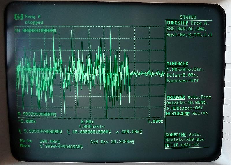

Here we start with a measurement of the reference generator itself. It consists of an Efratom LPRO-101 rubidium oscillator, a five channel isolation amplifier and a pulse shaper with three square wave outputs of 2.5, 3.3 and 5V. This reference is fed to the MDA as well as for some of the tests to the SDG6000X. This initial test is meant to show where the limits of the MDA are.
This photo shows the same setup as before but now the 5V square signal output is tested. It's amazing how much better 9.6mHz vs. 23mHz (this is millihertz!) the standard deviation of the frequency is. This basically is the result of the steeper edges of the square wave and hence the lower jitter of the input trigger / digitizing stages. We are right at the edge of the instrument's performance.

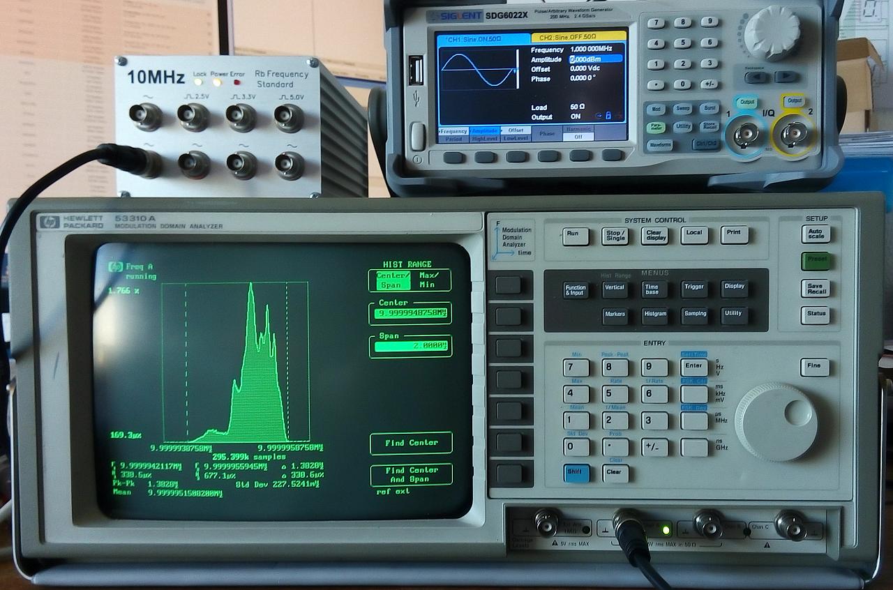

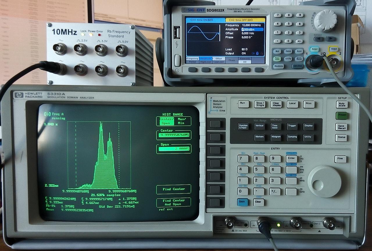

That's the first test of the SDG6000X, utilizing its internal reference oscillator. I decided to adjust amplitude of the sine wave to be 7dBm since the Rb reference outputs the same level. The histrogram looks pretty "how-you-doing" and the standard deviation is almost tenfold of what the RB source provides (this means jitter or phase noise).

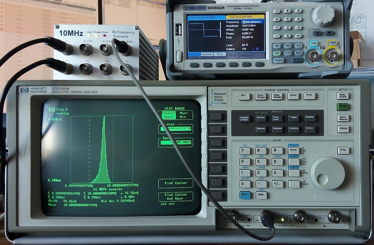

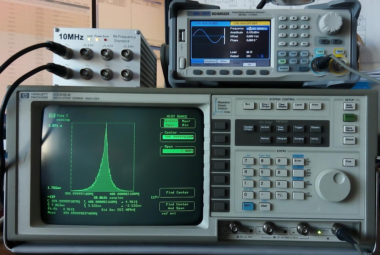

For this test, I connected the external REF input of the SDG6000X to the RB reference. It's quite amazing how the figures change --  the standard deviation now is only slightly worse than the one of the reference itself. A more than eight-fold improvement...

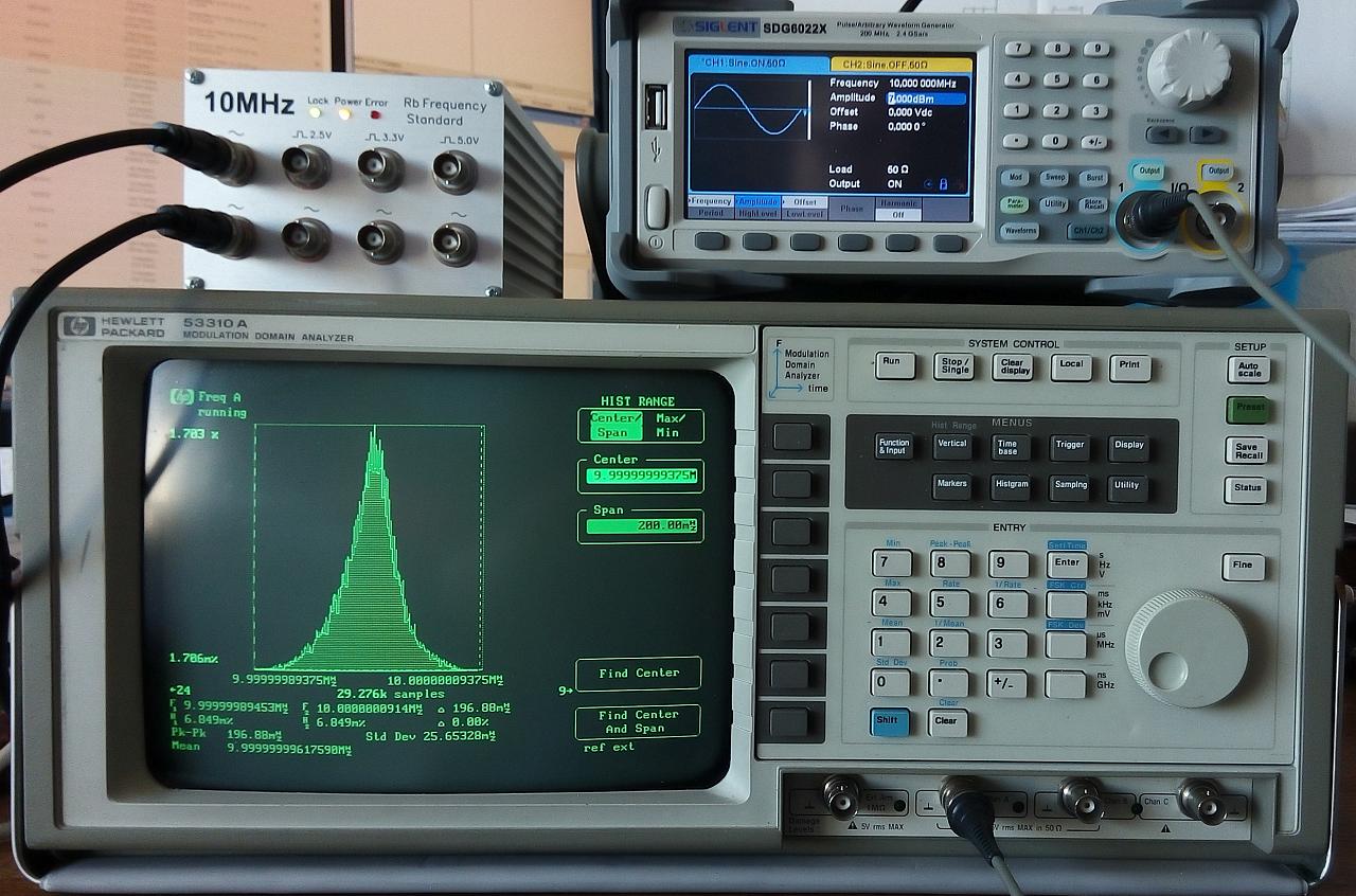

For direct comparison with the reference, I also tested the SDG with a 10MHz square -- once again, the difference to the reference is neglible.

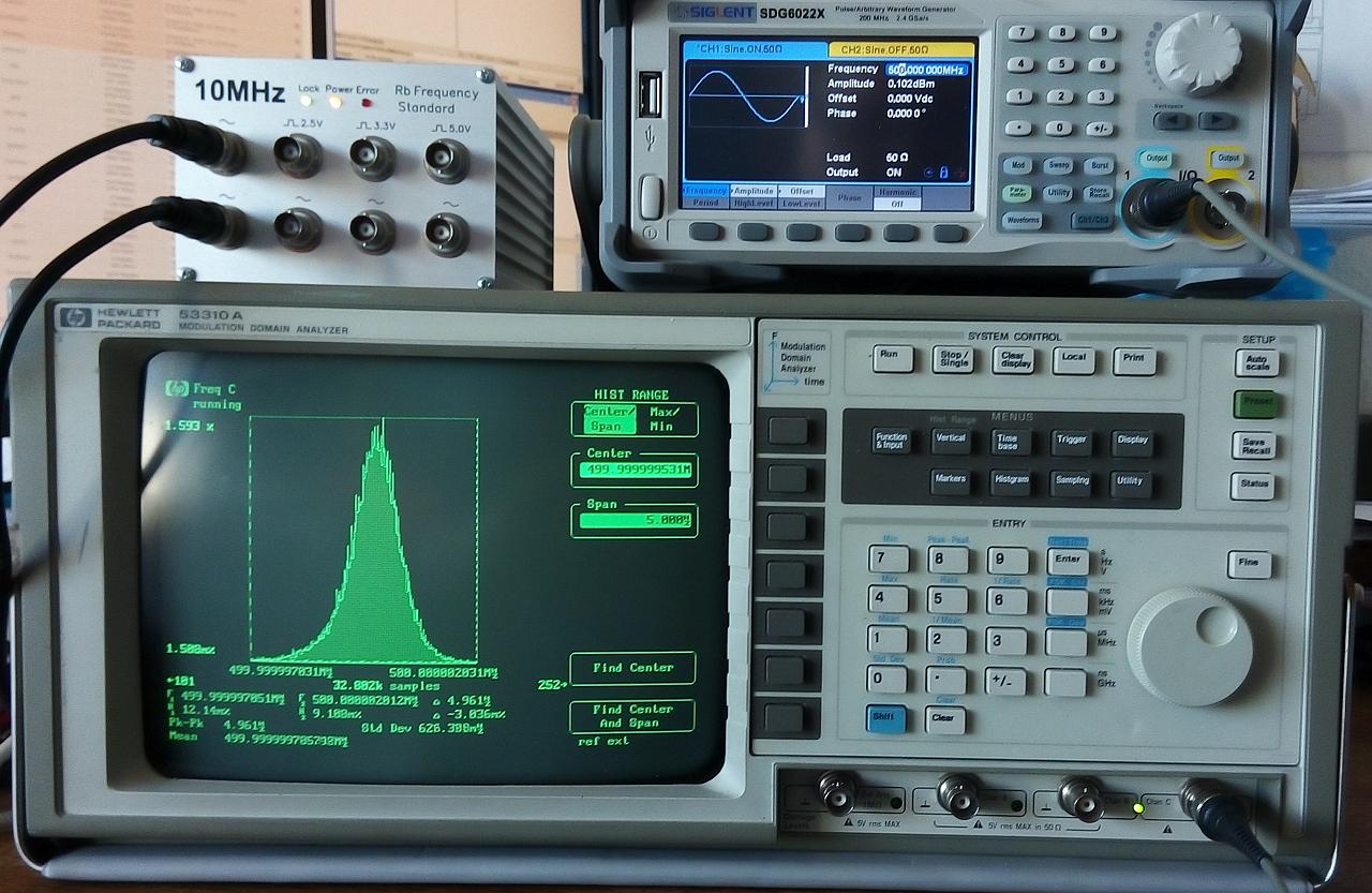

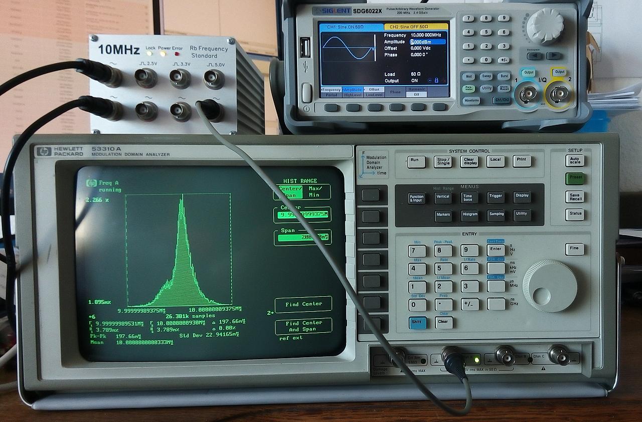

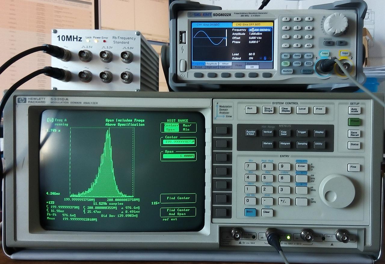

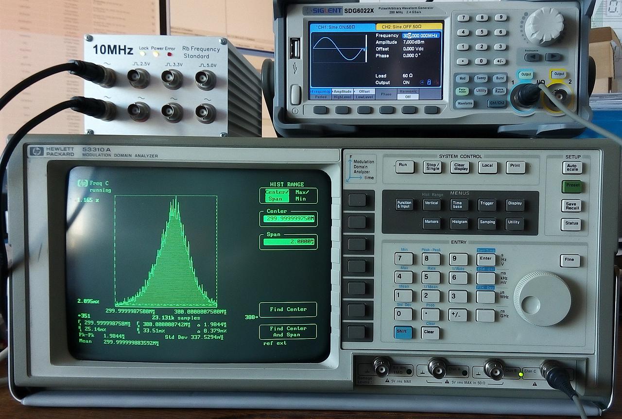

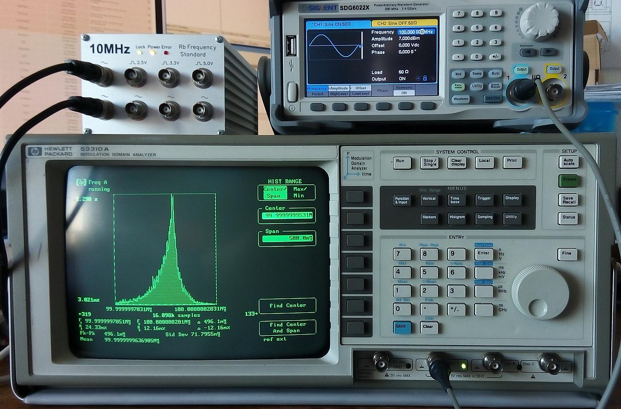

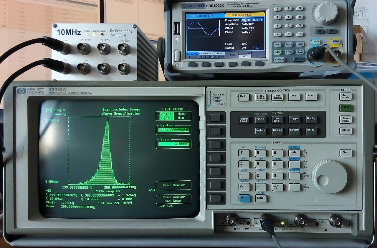

In the following tests, I step up with the frequency in 100MHz steps, initially to 300MHz:
Here the frequency limits of channel A of the MDA are already exceeded, yet it still appears to work okay. Moreover, at 300MHz the SDG cannot sustain a level of 7dBm anymore which may also contribute a little to higher trigger / digitizing jitter. Hence I did the same measurement on channel C of the MDA again:
This channel is equipped with a down converter. Since it requires its own local oscillator (PLL), it adds to the total jitter with some 100mHz in this configuration.
Finally at the limit of the SDG... It's amazing that at 500MHz -- provided the proper reference is used -- the generator produces less than 5Hz of total peak-to-peak jitter with a standard deviation of just a little more than half a hertz! Center frequency inaccuracy is just about 0.3Hz. For comparison, 500MHz with the internal reference:

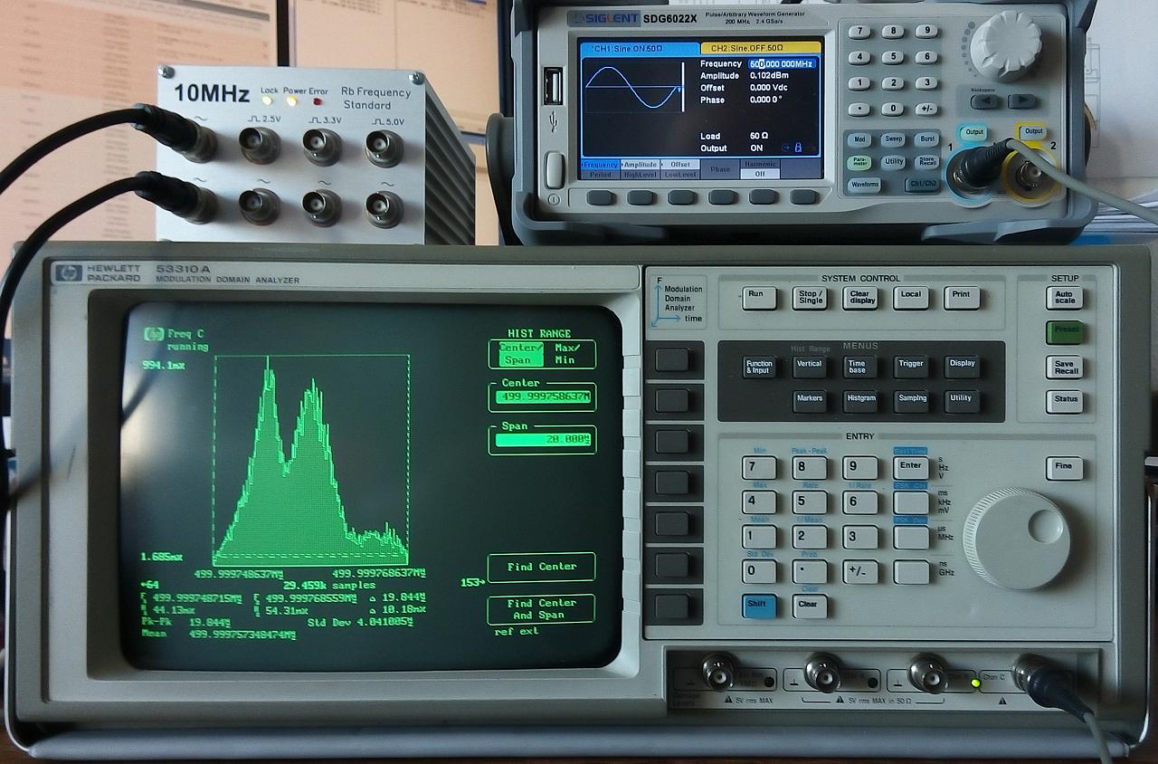

Funny how much worse the SDG's internal reference is: an absolute error of around 240Hz, almost 20Hz Pk-Pk jitter and 4 Hz standard deviation.
Finally, I had to have a look at the internal reference of the SDG. Fortunately, it' got a reference output. Voila:
I guess that's not bad for a TCXO but the histogram is far from the ideal gauss profile. Probably it's okay for everyday's tasks but for some really accurate jobs, the SDG6000X's performance will improve a lot if a decent external reference is used.

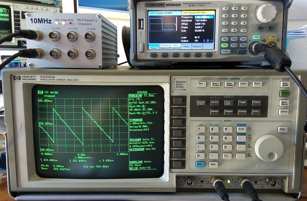

@dpenev - Thanks a lot for testing that. Your matching result probably confirms that my SDG6022X isn't defective and the observations at the edges of it's operational range are the result of the design and operation principle. It's good to know this since now I don't need to worry about a potentially defective unit and can decide to keep or return it just upon my findings. I guess now we know why Siglent has limited the over/undershoot specs in their datasheet to rise times of 2ns and above...  :o
By the way, the single AUX In/Out port that is shared between Sync CH1 / CH2 Trigger In CH1 / CH2, Trigger Out CH1 / CH2, Modulation In CH1 / CH2 and Data In in I/Q modulation mode. That's a whole bunch of stuff that's all mutually exclusive. I can very well imagine situations where I would need more than one of these functions. At least combined Sync/Trigger/Modulation ports but separate for CH1 and CH2 would be desirable. I'ld rather do without the frequency counter or have this function shared on one of the ports.
@ Jim - Please have a look at the following photos:
This is the freq-vs-time measurement of the Sync output. It appears there are more or less periodic changes between high and low jitter that alter rather abruptly. Since the jitter levels are rather low already, I'm not too sure if this is really something that's present at the SDG's sync output or if it may be some interference picked up from somewhere else. The maximum time base available on the MDA (1s/div) isn't long enough to pick up a complete period of this trace. Since I found that just using a different BNC cable may change the standard deviation of the jitter by 10mHz, I guess we're really searching here the needle in the haystack.
That's an interesting one: I reconfigured the MDA to operate as an ultrafast timer with high repetition rate. The time delay between input A and B of the MDA is measured and graphically displayed vs. time. Input A is connected to CH1 of the SDG6000X, providing a square wave of 1MHz, and input B is wired to the Sync Out on the rear of the SDG. Now the "walk-through" of the Sync signal vs. the output is clearly shown and also the approx. 3.5ns span of the "jitter" can be directly measured. It also gets obvious that the frequency of the walkthrough depends on the deviation of the output frequency to a multiple of 200kHz.
Here I tested the phase jitter between CH1 and CH2 of the SDG, outputting the same square wave. As the MDA shows, standard deviation of the phase delay between the two channels is no more than 50ps (since the input / trigger and other circuitry of the MDS also contributes a little to the noise), a pretty good figure.
If Siglent manages to remove the pauses of the output signal when changing parameters like frequency, aspect ratio or pulse width via the rotary encoder, I'ld say the generator is a keeper, despite of the peculiarities when looking very close... I guess there's no piece of test equipment without some quirks. In general, the performance of the instrument is quite good. Bu how can I know if they will address this problem (I guess @tautech does his best to convince them to have a look at the situation. But if the design pertmits the required modifications to sort that out is another question.  Since the SDG6000X is a rather new model, we can probably expect several future firmware updates and maybe some improvements /extensions to its functions as well.
