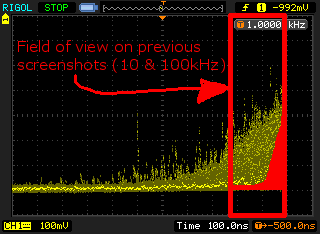

Here is a 5 min "exposure" of the 1 kHz signal from SDG1020.
It's only 5 min, as my scope froze when I tried to save the first time (a 15 min exposure). I had to power off and restart.
Only frequency was changed on the waveform generator (other settings, see previous post).
I had to expand the horizontal time base by a factor of 5, from 20 ns/div to 100 ns/div to capture most of the noise. That also made the sample rate on the scope go down from 1 GS/s to 500 MS/s. Memory depth normal.
Settings Rigol DS1102E for picture file "5mi_1khz.bmp":

Could you describe what happened when you selected "SelfAdjust"? Did it take long? Did the relays click? I wonder if it is required to short the outputs to ground or anything else...
On the first screen captures of yours, it seems that 120mV trigger level is a bit low. Looks like the scope has triggered on lots of the noise/glitches. Maybe a trigger level of 500 or 1000 mV is better and will give a more intelligible picture. (stay above of the noise/glitches and trigger only on the actual rising edge of the trace). Maybe changing the trace from line to dots would be better as well. (for some reason, the trace "dots" of my DS1102E aren't only the bright yellow dots, there is a trail of a few pixels (dim yellow).

@Nixxon,  The self-cal procedure takes about 20-30 s.  During the process, you can hear a number of relays clicking.  Because I was not sure if the cal procedure works for both or each channel, I repeated it twice (once for each channel).  I had all inputs and outputs floating during the procedure.
As for the traces, I only have a 2 channel oscilloscope so what you can't see is the triggering on the Sync out signal from the back of the SDG1020.  The signal is relatively low but even the low trigger level is more than sufficient to trigger correctly IF the signal output is correct.  Even if I trigger on Channel 1 or 2 rising edge, the same result will be seen.  By using the sync out signal, I am trying to demonstrate the jitter with respect to the internal clock as opposed to the jitter from channel 1 to 2 or vice-vera.  If the picture looks unintelligible, that is because  that is how bad the jitter and glitch problem is!  I captured using infinite persistence for only 10-15s at a rate of up to 10kwfms/s.

Maybe you could try some screen captures in persistance mode with trigger on the waveform itself rather than the sync signal. That gives one less source of error.
I have noticed that the sync signal on my SDG1020 is not at the beginning of a waveform. It is rather in the middle of the waveform somewhere.
10kwfms/s is pretty nice. I have read somewhere that the DS1000E series has ~800 wfms/s.

My opinion for measuring glitches and jitter.
Use CH1 for trig directly from signal itself.
Measuring trig out or syncout jitter related to signal is other case.
EV of course. Cars with smoke exhaust pipes - go to museum. In Finland quite all electric power is made using nuclear, wind, solar and water.
Offline nixxon
  • Posts: 342
  • Country: no
Agree. Set scope settings to Horizontal scale = 20 ns/div and Vertical = 100mV/div.
Show one trace only. Trigger on the trace itself and not the sync signal.
« Last Edit: February 05, 2013, 11:05:23 pm by nixxon »
