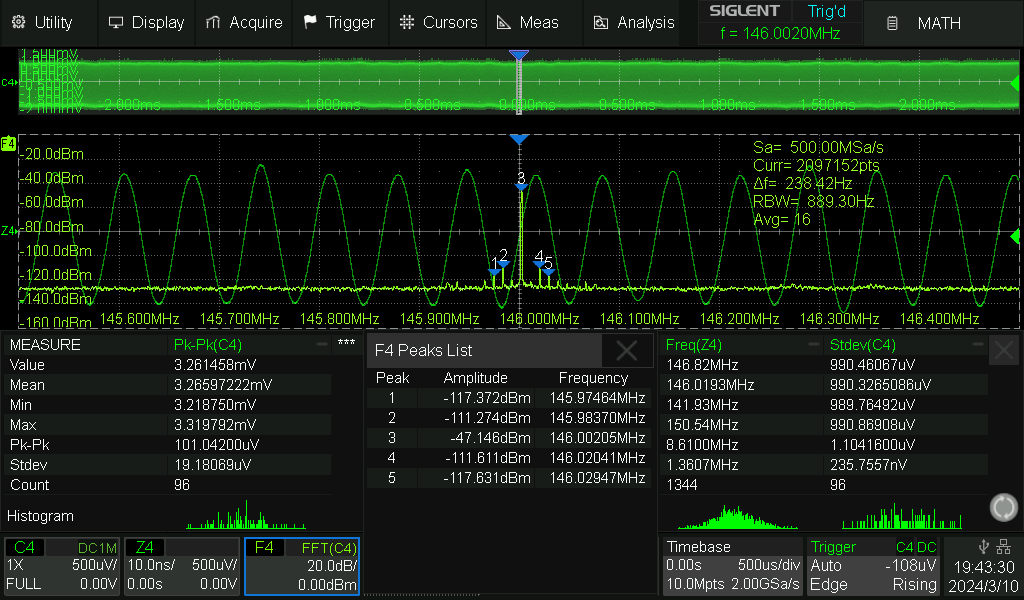

CW Test
For the 1 mVrms demo I had to bring quite a lot of information onto a single screen:
SDS824X HD_SA_CW_146MHz_1mV
The main window at the top is showing the 146 MHz signal at a timebase of 500 µs/div. We need that slower timebase to get sufficient data for a 2 Mpts FFT. Of course we can’t see any details there, hence there is the zoom window below, where the signal is displayed at a timebase of 10 ns/div. We can see that the vertical position is not constant across the screen width, which hints on the noise that gets very noticeable at such low signal levels.
The zoom window also contains the FFT which reveals some weak modulation due to noise and we can see the corresponding sidebands indicated by markers 1, 2, 4 and 5, whereas marker 3 corresponds to the main signal.
Below we have two windows nested: the advanced measurements together with the Peaks List, for which I’ve freed up some space by removing measurements 2 and 3. We can see that the amplitude measurements in the time domain still work reasonably well, at least Stdev (= AC-RMS), whereas the peak-to-peak amplitude cannot be accurate – once again because of the noise.
The signal frequency measurement is not accurate as well and all automatic measurements have a high variance, as can be seen in the measurement statistics and histograms, yet the 7-digit trigger frequency counter is still rock stable and pretty accurate. Of course, it is 2 kHz off, which is equivalent to 13.7 ppm, but that’s because the time base of the SDS800X HD has 25 ppm tolerance, which is pretty much standard, while Siglent’s higher end DSOs starting at the SDS2000X plus provide class leading 1 ppm timebase accuracy.
The peak table shows the various signal amplitudes, but we are mainly interested in Peak #3, which is indicated as -47.146 dBm at 146.00205 MHz. Surprisingly, the frequency is exactly the same as the trigger frequency counter, hence absolutely correct relative to the SDS800X HD timebase, also the amplitude is pretty much spot on (should ideally be -47.0 dBm).
At this point I should mention that the Peak table is automatic and we only set the search parameters, i.e. threshold and excursion. This is in contrast to the Markers, which can be preset on peaks or harmonics, yet each marker can be set individually to any desired frequency by the user. For the measurements here, Peak tables have been used exclusively.
There is no point to further look at the time domain for weaker signals, because they will get heavily distorted and eventually buried in the noise anyway. Yet I don’t change the arrangement and only move the zoom trace out of view.

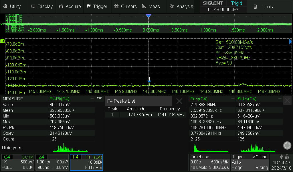

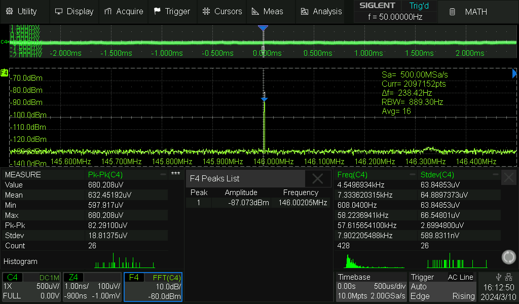

Next, we try 100 µVrms:
SDS824X HD_SA_CW_146MHz_100uV
The main window at the top shows mainly noise for the 100 µVrms signal at 245 MHz bandwidth. The zoom window with the FFT displays a clean spectral line, hence we only get a single peak marker.
The advanced measurements below just try to measure the noise, even though the Stdev measurement still isn’t too far off – just a coincidence?
Since such a weak signal cannot be properly triggered anymore anyway, I’ve used AC-line trigger instead and the trigger frequency counter just shows a constant 50 Hz now. FFT doesn’t need a triggered signal.
The peak table shows the signal amplitude as -67.316 dBm at 146.00205 MHz. The amplitude is still pretty accurate (should ideally be -67.0 dBm).

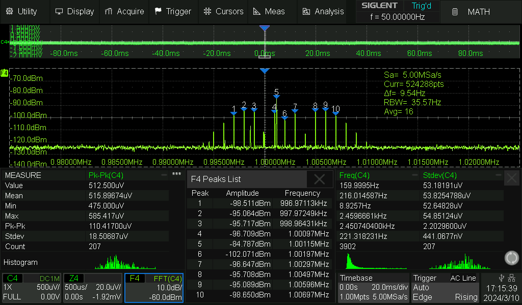

For the modulation tests, I did not feel like trying many different levels again, so 1 mV and 10 µV RMS shall be sufficient for FM.
First I need to repeat what I’ve already stated initially: An oscilloscope is a baseband instrument, not a spectrum analyzer. There is only so much frequency resolution we can get from a 2 Mpts FFT. As a consequence, the expectations shouldn’t be very high when looking at one kilohertz frequency spacing in signals from the 2 meter band.
Modulation: 1 kHz modulation frequency and 5 kHz frequency deviation.
1 mVrms at 146 MHz first:
SDS824X HD_SA_FM_146MHz_1mV
Well, that’s not very convincing. I was forced to use the Blackman window, which is still usable for spectrum analysis with a max. amplitude error of 1 dB. Its resolution bandwidth is not that much better than Flattop hence the picture isn’t very useful and we only get a vague idea of the FM spectrum.
It should be clear that a general-purpose oscilloscope isn’t a test receiver. If we look at bandwidth limited signals, like filtered IF, where we need not worry about aliasing from unrelated signals in the neighborhood, we could just use the “frequency conversion by undersampling” method.
Any ADC acts as a mixer, thus producing a spectrum of ±n * fi ± m * fs, where fi is the input frequency and fs is the sample clock, while n and m are just integers running from 0 to (theoretically) infinity. During normal operation, we don’t want to see any mixer products, which is perfectly possible as long as the input signal and all its harmonics don’t exceed fs/2 and the output of the ADC has a brick-wall filter (then in the digital domain of course, aka Sinc filter or sin(x)/x reconstruction) that removes everything above fs/2.
Yet in some circumstances, we can make use of a certain high-order mixer product, just as in this example, where the effective FFT sample rate is only 5 MSa/s, which is quite obviously way too low for a 146 MHz input signal.
According to the formula given above, we are aiming at the mixer product for 1 * fi - 29 * fs, which is
1 * 146 MHz – 29 x 5 MHz = 146 MHz – 145 MHz = 1 MHz;
Now if we set the center frequency to 1 MHz, we get the carrier at 146 MHz and a resolution bandwidth of only 35.57 Hz, even with just 512 kpts FFT, hence can also clearly see the sidebands and their 1 kHz spacing. 16x averaging has been used in order to get a clean and stable display:
SDS824X HD_SA_FM_146MHz_1mV_5MSa
Be aware that the true center frequency is Peak #6 at 1.00197 MHz because of the SDS824X HD timebase tolerance of 25 ppm.
The following table compares the measured sidebands with the expected ones in dBm:

Filter Demo
There was the suggestion for cleaning up high frequency narrowband signals by means of a bandpass filter. In this case we are talking about the 146 MHz signal from the HAM Test demo.
The narrowest bandwidth achievable at 146 MHz is 40 MHz (126-166 MHz). This appears very wide, but is pretty effective nevertheless. Just look at the noise floor:
SDS824X HD_Math_FFT_BP_126-166MHz_Noise
The screenshot above shows two math channels with FFT plots; F4 is the original signal (which is just the frontend noise for now), whereas F1 shows the result of the filter operation performed in math channel F2. It should be immediately obvious that getting rid of the strong 1/f-noise below 300 kHz alone would help a lot. With the BP-filter, only at 1 kHz the 1/f-noise approaches the level of the original HF-noise (~-120 dBm).
We cannot expect a major improvement for FFT measurements, because the resolution bandwidth there is much narrower than our bandpass-filter anyway. Here is the FFT with the 1 mVrms signal at 146 MHz applied:
SDS824X HD_Math_FFT_BP_126-166MHz_1mV
Yes, there actually is a difference. The original signal is measured ~0.43 dB too high because of the noise, resulting in -46.57 dBm, see F4 Markers List. On the other hand, the filtered version of that signal measures -47 dBm almost spot-on, as can be seen from F1 Markers List. So yes, even the FFT measurements can benefit from a cleanly filtered signal.
Now let’s have a look at the time-domain, where the improvement because of the filter should be even more obvious:
SDS824X HD_Math_BP_126-166MHz_1mV
Advanced automatic measurements have been set up for the amplitudes of both the original signal and its filtered version. The visual difference is quite striking already, and the measurements confirm the improvement: just like with the FFT, automatic measurements are more accurate with filter than without.
We already know that reliable triggering is only possible down to about 400 µVrms, yet it still works with 100 µVrms signals, if we can accept a high failure-rate (look at the trigger frequency counter):
SDS824X HD_Math_BP_126-166MHz_100uV
Once again, the visual difference is quite striking, and even though the automatic measurements for both signal variants aren’t entirely accurate, there is still a major improvement with the filtered version.
