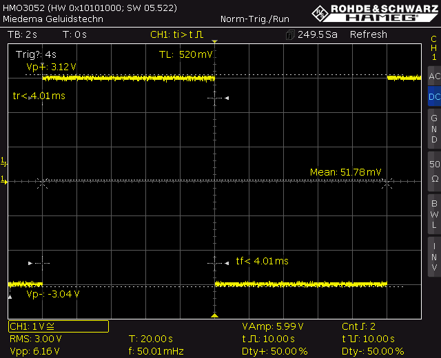

I did a test with my Rigol DG1032Z. I looked at Squarewave and Pulse, 6Vpp, 20second period.
No problem at all:
http://www.miedema.dyndns.org/eevblog/Rigol-DG1032Z-20sec-squarewave.gif
Same waveform with or without termination. (screen shot is without)
So the strange behaviour is not always a "Rigol feature" ....
Firmware of my DG1032Z is 00.01.12.
Regards, Gertjan.

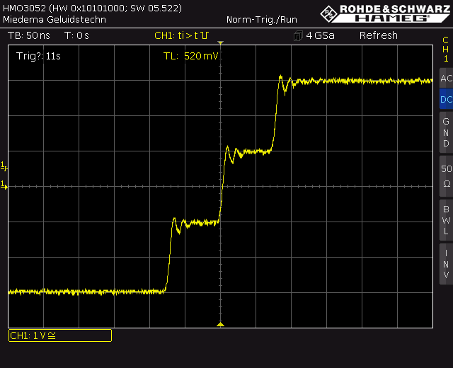

Gertjan,
I think you need to reduce the timebase to the same 50ns/div as the OP before you can tell if you have the same issue/feature or not. Looking at the edges at 2s/div isn't going to show it.
Online Gertjan
  • Posts: 139
Re: Rigol DD1022Z - ugly sq wave transition at very low freq setting
« Reply #12 on: October 22, 2017, 09:37:02 am »
Hi H.O,
Off coarse you are right....
So I checked again with 50nS timebase:
http://www.miedema.dyndns.org/eevblog/Rigol-DG1032Z-20sec-squarewave-tb=50ns.gif
And indeed, same behaviour as the other Rigol AWGs.... :o
I guess I never looked very close at the rise times at very low frequencies.....
edit: I measure a "rise time"of 163nS. The Rigol spec is <10nS @ 1Vpp.
So i looked at 1Vpp generator output level as well. Same staircase waveform. So definitely not in spec....
(But without the "staircase" rise time would be in spec)
regards, Gertjan,
