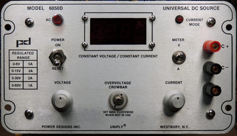

Just finished working on two Power Designs power supplied that I purchased on Ebay.
The first one is a 6050D that was in fairly poor cosmetic shape, and missing some components.
It took quite a bit of work, but I am quite happy with the final results.

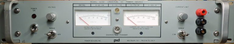

The second unit is a 6150 that mainly needed mechanical repairs and some cleaning.
I haven't seen many examples of this power supply, and still need some information for which potentiometers are used for calibrating the current meter.

Welcome to the forum, Barbouri. Nice job on the 6050D. It looks great. I'll check out your blog for the details. I have a couple of 6050A, so I'm curious to see what the D is like inside.
Yeah, I see 6150 around on occasion, but they are rather rare. I've never worked on one.

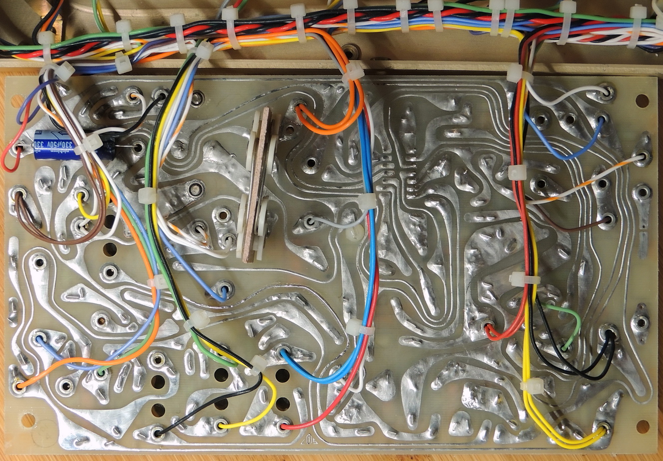

Even though the 6050D in a more recent variant of the 6050 series, I was impressed with the quality of construction and engineering.
My only disappointment was the use of zip-ties for cable management, instead of waxed lacing cord.

It's also interesting that the PCB on the 6050D, despite being much newer, looks like the same vintage as the 6050A.
Where did you get the replacement knobs for the 6050D? Those look pretty good. I'd still like to find three originals for my TP340A.
Looking forward to your 6050C repair.

The knobs on the 6050D are from Digi-Key part #226-3148-ND and are  by Kilo International part#OESA-50-3-5
They do not sit as flush as the originals, but this unit came with only one knob. They are also not as tall as the originals, but in my opinion are a good match.
Unfortunately the recent 6050C has some shiny non-PD knobs on it, so will likely be getting the OESA-50-3-5 knobs for it too.

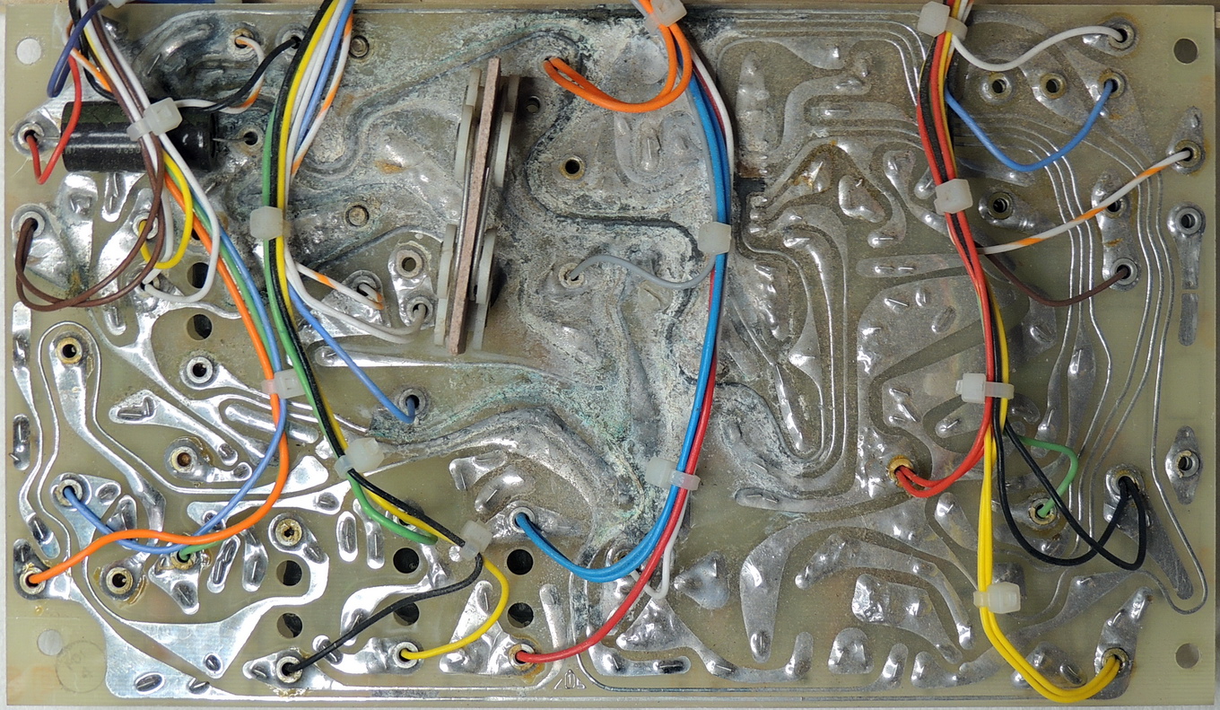

Repairs are progressing on the Power Designs 6050C.
PO did replace the leaking 22,000 uF 16V capacitor, but didn't bother to clean up the electrolyte that dripped down to the circuit board below.
Circuit board bottom after cleaning, repair, and replacing capacitors.
It is currently functional, but I need to do a full re-cap, and a few mechanical repairs before it is finished.

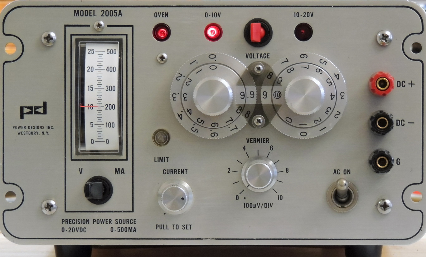

Also added to the bench is a Power Designs 2005A won on auction from Ebay for $26.00 plus shipping.
After an afternoon of cleaning and minor repairs. I still need to find a pair of rear feet for this unit.
I ended up using polarizing film instead of white paint for repairing the digital dial window.
