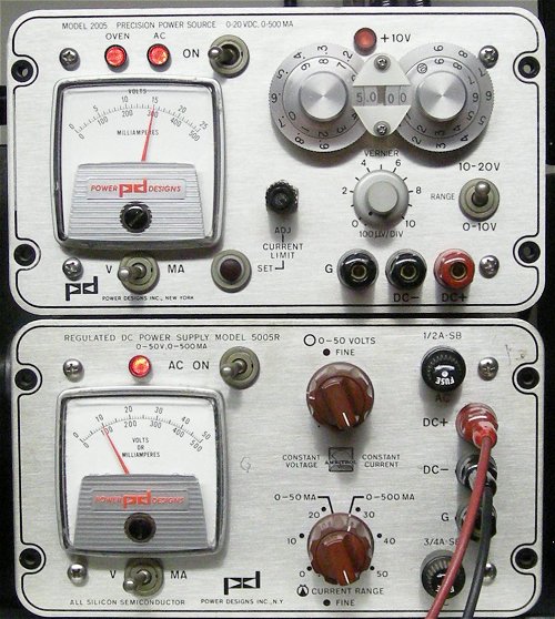

The 2005 arrived yesterday.  After a new power cord and a slight tweak it's dead on at 5.000 volts.  When you get it up to 20 volts it's off by about .02 volts.  Close enough for my use and until I find a service manual.  It took me longer to get three cal and inventory stickers and their goop off the front panel.
They do look nice stacked.
My god that's attractive.... ahem...
Try putting it to 10V on the 20V range (dial reading 0.000) and see if its still 0.02V out. If it is then its probably the 10K range resistor moving out of tolerance (assuming the 2005 is similar in the divider network to my 2020B).

Remember that each voltage is switched in by individual, discrete resistors. There are a million places where that error could come from. If the error is linear with the set voltage, it's a calibration error, just adjust the trimpot (you're supposed to do it at 20.000V). Let both the PSU and the voltmeter you're checking it with warm up (fully turned on, not just standby) for a long time before you do this. If if's not, you'll have to track down which resistor it's from. I too suspect the +10V switch - if you get the same 20mV error going from 10 to 20 and from 0 to 10, check that. Otherwise, open it up and start probing resistors (for each one, you'll have to find a knob position that gets it out of the circuit). I suggest adjusting them by adding a small series resistor or large parallel resistor. The ones that are in there are already quite aged and should not drift too much more, and it's probably best to take advantage of that. Adjust the resistance according to output voltage, not to what the resistor is marked with.
The manual is here from post#10 of this thread :-[. Calibration procedure is there.

Thanks,  I had forgotten about the link to the manual for the 2005 being posted here.  It's only the 10-20V range thats out (across the entire range) so it looks like I will need to check the trimmer and resistor for the upper range.

There is only a zero adjust and a 20V adjust. You dial in the 20 after the zero. If 10V is off after that check the 10k resistor that is shorted by the 10-20 range switch. If 5V is off after that a Deoxit cleaning of the decade switches should get it in tolerance from my experience.
Its almost certainly that 10K 0.1% (R45) range resistor. Pull the RV to S+ strapping out and measure across the resistor. Mine measured high so I paralleled a couple of 10Mohm resistors to it and its bang on the money now.

We cant make that assumption until SLJ calibrates zero and at 20V and then checks 10V on the 10V scale. The 5V is affected by the decade switches and resistors.  The 20V being off means it needs calibrated before you can do any other testing.
Thus my "almost". But if its out in the entire 20V range by the same amount and not in the 10V range at all, then that would be my guess. Its easy to check anyhow.
