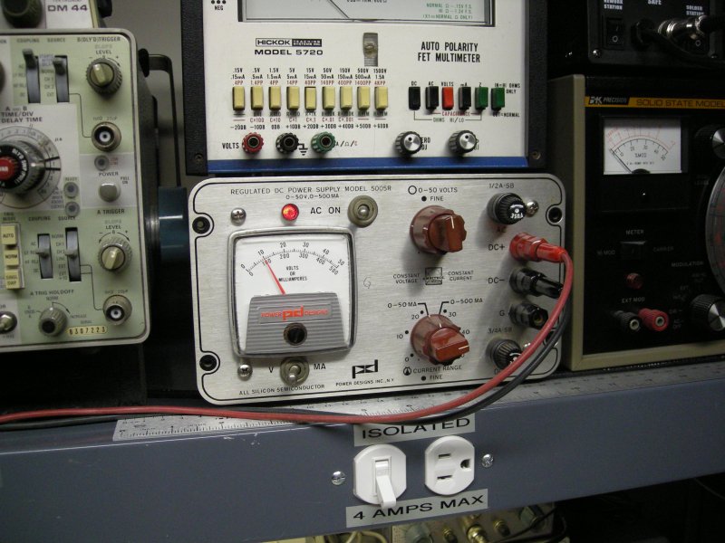

Picked this one up at a swap meet last week for $20.  0-50 V/.5 A
I'm happy.

It looks to be in fine shape and has all original knobs  :clap:.  I presume its Vout is factory stable perfect  :-+

Nice one SLJ :-+

Stable, no AC ripple to speak of, and the meter is accurate.  :)
