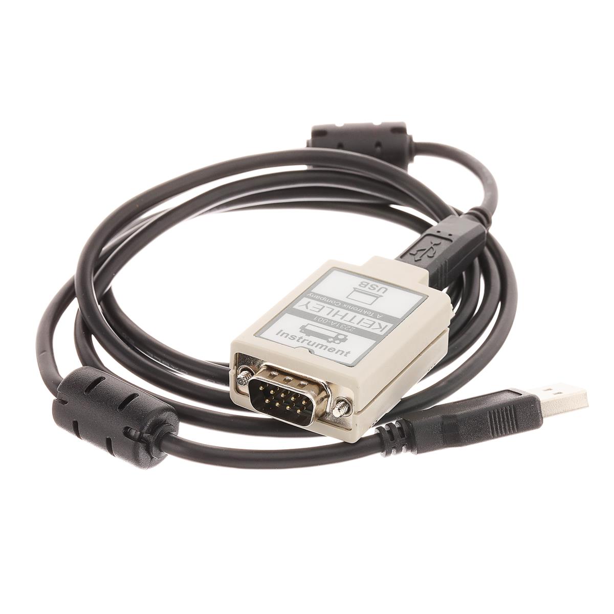

wow.  I was just looking at one of these supplies online.  what a crazy decision to include a DSub and force your users to buy a $97USD USB adapter.  Seriously what the hell were they thinking?
This design doesn't much look like other Keithley stuff, so I'm guessing it's a rebadge or something.  But still.
https://www.mouser.com/ProductDetail/Keithley-Instruments-Inc/2231A-001?qs=DWa7j9kREiEoYVPT6mrqPg%3D%3D
https://www.mouser.com/datasheet/2/403/077101500_USBadapter_8-3358684.pdf
https://download.tek.com/datasheet/2231A-30-3_Datasheet_1KW-61078-0.pdf
Control the Supply and Upload Data to a PC
Use the optional Model 2231A-001 USB Adapter to control the Model 2231A-30-1 via a PC’s USB interface, then transfer readings from the outputs to combine with other test data for a more thorough analysis of DUT performance. The 2231A-001 USB Adapter provides the flexibility to use the supply under either manual or automated control.
So it's not like they expect you to directly use the DSub, and the USB cable is optional or something.

I guess a bean counter objected to having a MAX232 in there to convert to proper RS232 levels, "oh it will cost $1"...
Still rather than pay for the adapter you could make one with said chip and a little effort. The 2231A is a good power supply, I use mine all the time.

I managed to get communication working without their connector. All I had to do was get an FTDI TTL converter (https://www.amazon.com/NITOMTYU-Serial-Adapter-TTL-232R-RPI-Windows/dp/B0CFV96CDD/)  and a DB9 breakout connector (https://www.amazon.com/Breakout-Connector-RS232-Serial-Terminal/dp/B073RGFD3Q/).
The links were just to example items but I'm sure they can be found for cheaper somewhere else.
Just connect RX, TX, and GND on the ttl cable to TX, RX, and GND on the DB9 breakout board . If it doesn't work immediately, swap RX and TX.
