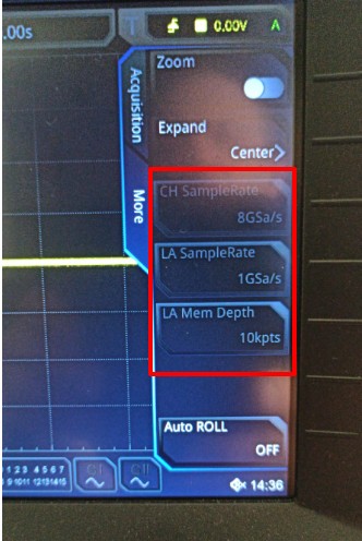

I have RIGOL mso 5072, updated to 5074. But I noticed that some options in the menu are still not available. What can be wrong? Firmware 00,01,03,00,03
these options are not enabled.
can you tell me how to turn it on.
Offline skander36
  • Posts: 789
Re: Hacking the Rigol MSO5000 series oscilloscopes
« Reply #2511 on: April 18, 2023, 10:08:45 am »
I think they are only informative. I don't remember to see them anytime active.
CH SampleRate is changing while the sample rate vary. Also the rest of them while you increase Horizontal scale.
Maybe if you attach original logic probe interface, I don't know.

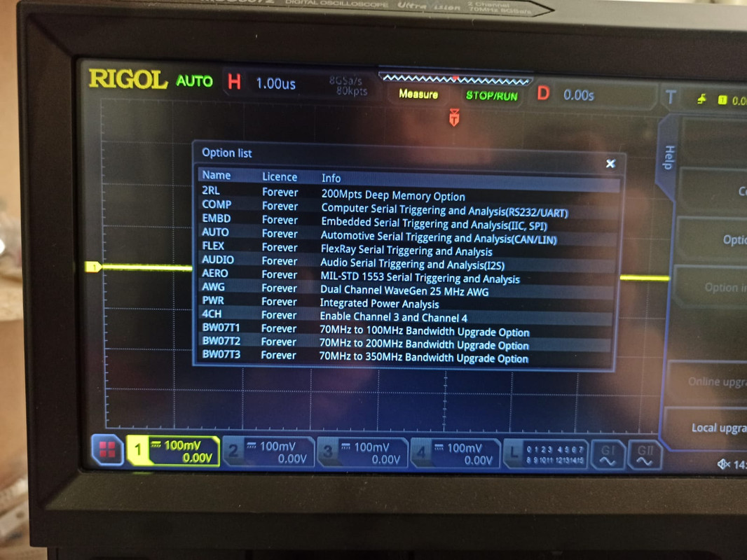

Fairly new here. Obviously, lujji was able to read through this thread and create a patch for the previous fw version even before owning the scope, so I started to read too... I'm only up to mid-2019 when the ideal of using a patch file surfaced after SSH was removed by Rigol... Surely, there's got to be a better way to summarize the knowledge of this thread and how to create patch files without having to read the entire history, right?

Offline albedo
  • Country: pe
« Reply #2515 on: April 18, 2023, 08:31:44 pm »
Hello to all :D. I am new to this forum and honestly it has been very complicated to find information on a specific subtopic in hundreds of posts :-BROKE. I think something should be done about this, maybe synthesize all the really useful info and create a software style manual or documentation  :-+

Tried the patch here. Seems to work OK, will report back if/when something changes, but so far everything good.
I finally had a chance to try it myself and I can also confirm it seems to work fine.
I just patched mine and it works! Thanks!! Now I will slowly go through the analysis with Ghidra and try to work out the process for myself thanks to your help!
