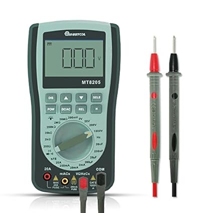

I'm always looking for bargain test equipment, and sometimes I get burnt; hopefully this review saves you from wasting some time and money.
I bought the Mustool MT8205 from Banggood who advertise it as a "2 in 1 Digital Intelligent Handheld Storage Oscilloscope Multimeter AC/DC Current Voltage Resistance Frequency Diode Tester"; it sells for just under $50 shipped.  I love Banggood and have had lots of good experiences with them, but buyer beware: this product is a waste of money at any price.
While it looks good, feels solid, and comes with nice probes and case, it simply isn't useful for making measurements.
Let's start with how it works as an oscilloscope since that's the interesting feature of this device.  When I ordered it, the ad said 200ksps which would suggest it is useful to look at signals up to at least 20kHz...not great, but at good enough for looking at audio and PWM waveforms.  However, as the ad now says, the analog bandwidth is limited to 10kHz.  A 15kHz signal is severely distorted and it won't even try 20kHz.  A 10kHz ramp looks just like a 10kHz sinewave.
You can see pictures on my blog post here: http://www.dalbert.net/?p=613 where I feed it a 15kHz sinewave and a 20kHz sinewave from a Rigol signal generator showing that the bandwidth is indeed limited to 10kHz (i.e. useless).  There are other issues too: there is no trigger control, the signal is always AC-coupled (so you can't measure anything DC), there are none of the controls you'd expect to find on an oscilloscope and it's too slow for virtually anything these days.  The scope feature is a complete bust.
To add insult to injury, the multimeter functionality is useless too!  The readout is only 3 digits and even those aren't accurate!  I hooked the meter up to a lab voltage standard and checked the output with a calibrated 7-digit HP bench meter.  The 10.0000V standard was dead on with the HP meter, but read 9.95v on the Mustool.  What's worse, when I used it to measure 2.5v and then used it to measure 10v again, it took several (I'm talking 4-5) seconds for the readout to gradually climb to 9.95.  Useless.
Summary:
    Large/heavy/manual-ranging multimeter
    Only 3 digits, only 2nd of which are accurate (see 10vdc lab standard)
    Incredibly slow: takes several seconds for voltage to read properly
    Limited to 10kHz analog bandwidth
    AC coupled only
    Oscilloscope has no controls so not even useful as a teaching tool
According to banggood website, DCV accuracy is
DC voltage: 200.0mV ~ 1000V ± (0.75% rdg + 10dgt)
10 * 0.0075 = .075
10 - .075 = 9.925.
So the Mustool is within its stated specs.
And I would never buy a product like this.  If I got it for free, that's a different story.
Offline retiredcaps
  • Posts: 3575
Re: Mustool MT8205 - Useless
« Reply #3 on: July 11, 2018, 06:17:16 am »
3 digits is correct for a meter that looks to be 2000 count.  In the 20V range, you only get x.yz (3 digits).  If your measurement was 1V, it would be a.bcd (4 digits).
Again, while it doesn't read 10 exactly, it is within spec.

Dear fellow eevbloggers (and moderators): I urge you to reconsider before posting comments like "what did you expect for $50".  Obviously the answer is: not to have thrown away $50 on a useless device.  My post was intended to help save others from wasting their time and money and (moderators please note) that sort of trolling discourages people from posting.
There are plenty of high quality, very affordable pieces of test equipment that can be had in the $15-$80 range.  Uni-T, Aneng, and several other innovative Chinese manufacturers make excellent, accurate multimeters; Owon makes some very handy USB oscilloscopes that can be had for under $80 and work extremely well.   Unfortunately, Mustool doesn't appear to be such a company.
RetiredCaps, thank you for pointing out that the meter was in spec; please note that I didn't suggest that it was out of spec, just that it was useless: a $50 multimeter with only 2-3 useful digits is ridiculous these days and the 10kHz bandwidth and other limitations of the "oscilloscope" make it similarly useless.
10 * 0.0075 = .075
10 - .075 = 9.925.
The problem is that $3 multimeters like 830 type usually are more accurate than that in practice.
