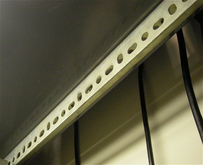

I know you are using shelf brackets and press board but if weight becomes a problem you could add a piece of angle bar stock under each shelf.  This helps prevent the shelves from sagging under weight.   I've seen smaller angle bar stock added to the front of each shelf with the tip of the shelf brackets sticking in the holes.  It's steel so if it's in view you can paint it black or whatever to make it look a little nicer.  Most home improvement stores sell angle bar stock in different thickness and lengths and it usually has pre drilled holes.
Even though I have a commercially made sheet steel riser on my main bench I added a 2 inch angle bar underneath.  I have equipment stacked up 3 high in some places and there is no chance of it sagging.
As far as the rework station, here's how I did those adjustable cubicle shelves: http://www.stevenjohnson.com/soldering/esd-station.htm  (scroll down to "Shelf Construction")
