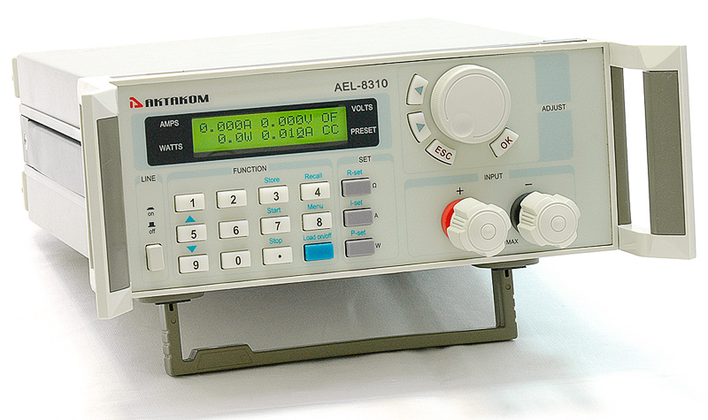

I ran into this today:
https://www.tmatlantic.com/e-store/index.php?SECTION_ID=367
Another Array rebrand for USA buyers.  The newer model is the lowest price so far I've seen for the 372x series.

Re: ARRAY electronic loads
« Reply #67 on: October 01, 2012, 12:40:08 pm »
A whole new design with 250W for the base model  :P At least they addressed the lack of CV and added a shitload of modes
