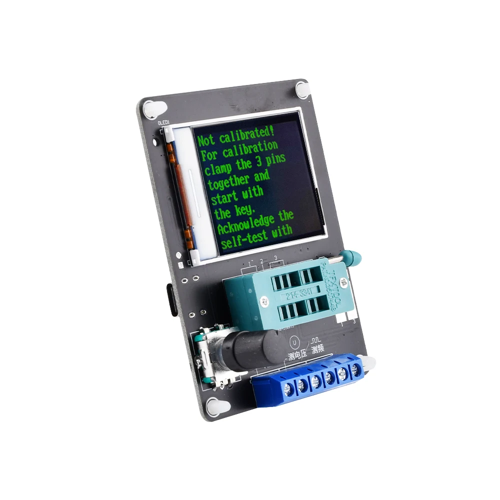

Hi, first time posting here. Let me know if there is a better place to ask this.
I bought a variant of this product recently, mostly to measure transistor gain. I've measured several 2n3094 and 2n3096 components, and they all measure hFE ~ 370. If I'm reading the datasheets right, it shouldn't exceed 300 (and usually be much lower).
https://www.amazon.com/Mega328-Digital-Transistor-Resistance-Capacitance/dp/B07WT9VVZB#customerReviews
Am I missing something? I saw that there can be measurement errors for leaky parts (germanium), but haven't seen complaints about common Si parts.
Offline rsjsouza
  • Posts: 6063
  • Eternally curious
    • Vbe - vídeo blog eletrônico
Re: $20 LCR ESR Transistor checker project
« Reply #9086 on: February 10, 2024, 01:12:41 am »
Assuming the transistors are legit, historically the hfe alone is a parameter that has a wide variability across manufacturers and even within the same manufacturer or the same batch. Also, it is highly dependent on the bias applied to the transistor.
I wouldn't rely much on it, unless you are talking variations of orders of magnitude...

Thanks - the main reason I am confused is I measured ~10 components and they are remarkably consistent, all between 360-380, which differs from the datasheet
You must clear understand that ONLY the original autors firmware installed on the device can to a greater extent guarantee the reliability of the results when measuring transistor parameters. And this is provided that the hardware of the tester is in good working order, the supply voltage of the microcontroller is well stabilized and clean. If your tester has original Chinese firmware installed, no one will give you any guarantees regarding the correctness of the results of testing various parts.

Update: I made a simple voltage measurement circuit for the transistors and it read... exactly the same as the meter.

GM328A up and running on 1.13k   Non removable MCU
Files I changed attached
mega328_color_kit Makefile and lcd_defines.h  This display is mounted the opposite of other older GM328A I had to reverse the settings in lcd_defines.h
How I did it I put on GitHub
https://github.com/carl1961/New-GM328A
