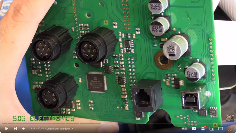

SDG has a teardown here of DDE-2C, where he found it was a dsPIC33FJ256 (256kB flash):
May or may not be the same. If it is, 64 and 128kB versions are also available.
Offline KG7AMVTopic starter

« Reply #4 on: October 13, 2023, 01:18:13 am »
thm_w, the update is about 5Mb so there has to be flash some place else prob up on the display unit.

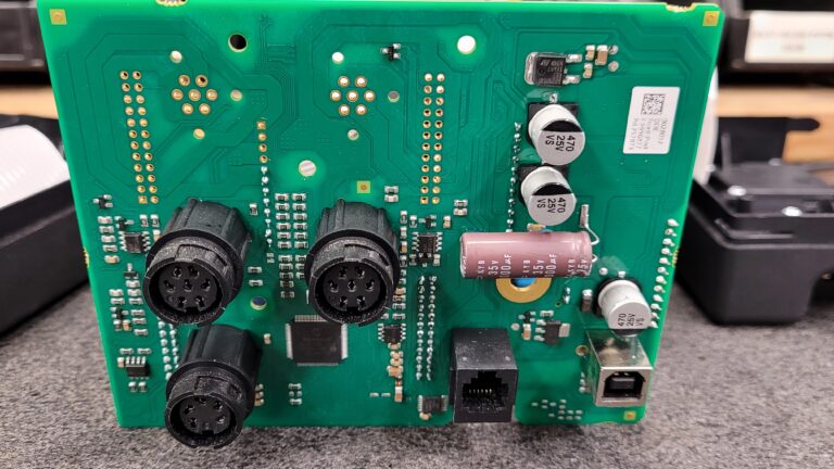

Major Bodge!
SGG Screen Shot Surface Mount Cap
From My Teardown Bodged in Electrolytic Caps. Screams Superior Quality.  NIPPON Japan is OK but the CHANG China?
« Last Edit: October 15, 2023, 10:38:47 am by KG7AMV »

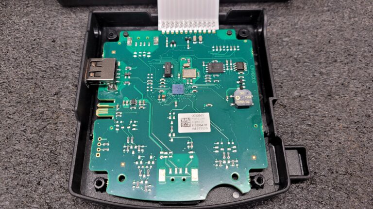

Yea, all the logic for this is in the front end of the unit. SDG did not tear down the front display of his unit.
Teardown Image
Downgraded MCU MK20DN512VMD10 Common BGA144 Package
Unit that actually support the DDE-1C Firmware Has a MK26FN2M0CAC18 a Very Tiny 5.6mm X 5.5mm Exposed Wafer BGA “WLCSP169” Package.
« Last Edit: October 19, 2023, 04:36:13 pm by KG7AMV »

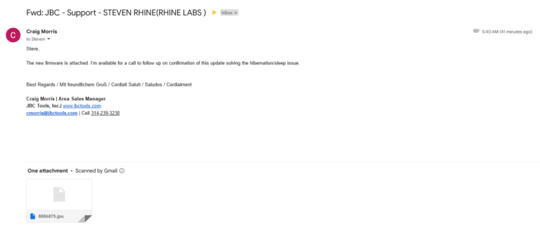

Here is a quick update,
I was delivered 2 Replacement DDE units from the local sales rep personally and the displays were consistent.
The Bad JBC must have changed hardware or something and the desoldering tools would not come out of sleep / hibernate unless the soldering tool was picked up on both units.
JBC's customer service is really poor don't even think of trying to call them in Spain for assistance. JBC will say contact JBC USA and JBC USA will send you to a rep the rep will take the info and send it to Spain for a reply when they feel like it and the US rep's customer service communication skills are horrible.
It took about 2 weeks to get someone in tech support via relay thru the sales rep and they sent a custom firmware up date a few days later it seems to have to resolve the issue.
Current Firmware DDE-1C is 8886867
The Firmware they sent me is 8886875
I only updated one unit and I can reproduce the issue on the second unit and make a video. (Already made one but forgot to plug in microphone oops and interrupted the video during the firmware update) I may just make it public.
« Last Edit: December 19, 2023, 09:34:03 pm by KG7AMV »

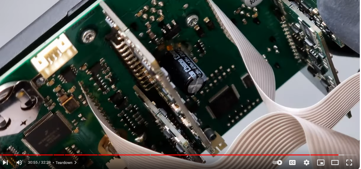

Marco Reps also had a tear down of the JBC desoldering pump. Lovely Chang capacitors
I will have to open mine and take a look..
Also look at the 4 tool unit looks like a bodged and hot snoted CHANG cap in the main unit also. At the price point of this equipment one would expect name brand high end caps Nichicon, Rubycon, Panasonic, Etc.
