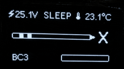

Offline DavidAlfa
  • Posts: 6178
Re: CFW for KSGER/Quicko STM32 Soldering Stations
« Reply #2162 on: October 01, 2021, 07:36:08 am »
Ex.
« Last Edit: October 01, 2021, 09:16:07 am by DavidAlfa »
Offline levi
  • Posts: 8
  • Country: am
« Reply #2163 on: October 01, 2021, 07:42:21 am »
Hello, In my opinion flashing cross on top of the iron will be more informative than the question mark aside.
Offline Tugo
  • Posts: 117
  • Country: si
« Reply #2164 on: October 01, 2021, 08:41:25 am »
How about "X" over the iron you draw?
Offline DavidAlfa
  • Posts: 6178
« Reply #2165 on: October 01, 2021, 09:05:17 am »
This is the final result (the shift is caused by the gif image alignment).
« Last Edit: October 01, 2021, 09:08:19 am by DavidAlfa »

As always. The big NO IRON error has always been completely isolated from the small error.
I properly finished the settings section in the linker scripts, and stored the settings there instead hardcoding it:
I added a new option, de-noiser threshold in system/temperature settings.
Used the existing "Threshold" string. Set to 0 to disable, all the noise will be shown in the screen widget.
This is only applied to the widget, it's completely unrelated to the ADC signal processing and filtering.
A value of 5 means to ignore ±5C differences from the setpoint.
New builds available!  Your settings will be wiped!
« Last Edit: October 01, 2021, 09:52:05 am by DavidAlfa »
