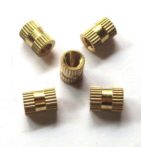

A look into the plunger. The thread is a M4 heat fit insert (mcmaster 94180A353).
After looking at mcmaster page for that heat fit insert, I wonder, the installation tip for soldering iron, I cannot find any information about that, which soldering iron will it fit?
Or did you use other ways of inserting it?
I guess Mcmaster still don't want to ship internationally, I tried last in 2011, but no-go.
Here is some information about those inserts. Since I am merely a hobbyist, take it with a grain of salt.
This is the M3 set the McMaster sells. The M4 is similar. The insertion tip is at the top and the extraction tip is at the bottom. The tip in the center is of the Weller SP40NUS solder iron they sell for this purpose.
For insertion I just use a Metcal STTC 125 tip that I happen to have (with a MX500 solder station). It worked just as good. This is a fixed temperature setup.
As for finding those inserts, you can search under different names such as 'heatfit threaded inserts' 'ultrasonic threaded inserts' 'heat threaded inserts'  'tapered threaded inserts'. For example
https://www.google.com/search?q=ultrasonic+threaded+inserts&es_sm=119&source=lnms&tbm=isch
There is also that kind of symmetrical inserts that you can find on ebay, for example, http://www.ebay.com/itm/New-20pcs-Brass-Knurl-Nuts-M4-8mm-L-6mm-OD-Metric-Threaded-nuts-insert-round-/221526229763?hash=item3393fe0303  They are good for the 4 motor mount holes but not for the plunger because the sharp edge at the front end causes the long hole inside the plunger to clog. You can try filing one end of these inserts to make them conic, possibly this will avoid clogging the plunger hole.
Also note that all the dimensions in my 3D models were tweaked to match the parts I have and the tolerances of my 3D RepRap printer so you may need to tweak them.
PS: considering that these inserts are so easy to use and useful for 3D parts, I am surprised that they are not more popular with the 3D make community and available from vendors catering to hobbyists.

I did a few experiments with the cheap inserts from ebay and they seem to work. Those inserts are designed for molding, not for heat insertion, but tapering one end with a Dremel disk solves the problem. I was able to insert the taperd insert without clogging the plastic hole past the insert which is required for the plunger.
A stock vs. manually tapered inserts (this is a M3, the paste injector uses M4 but it should be the same):
This is how I held the insert while tapering it with a Dremel disk:

ah, good to know, that the shape is important like that.
Found some that sold better ones on ebay, from US, but it seemed like the shipping was kinda expensive ($28-30 for 50-100 pieces).
But anyway, need to get parts printed also.. that can be expensive.
