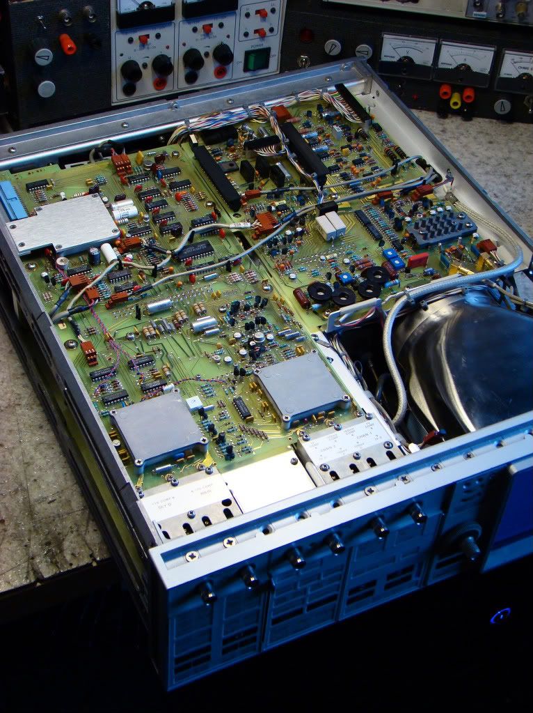

Top of the scope with its sides removed. Z axis amplifier, HV oscillator, expansion PROMs, GPIB I/O (or in this case HPIB I/O), digital processor and control board and shield of the massive CRT.

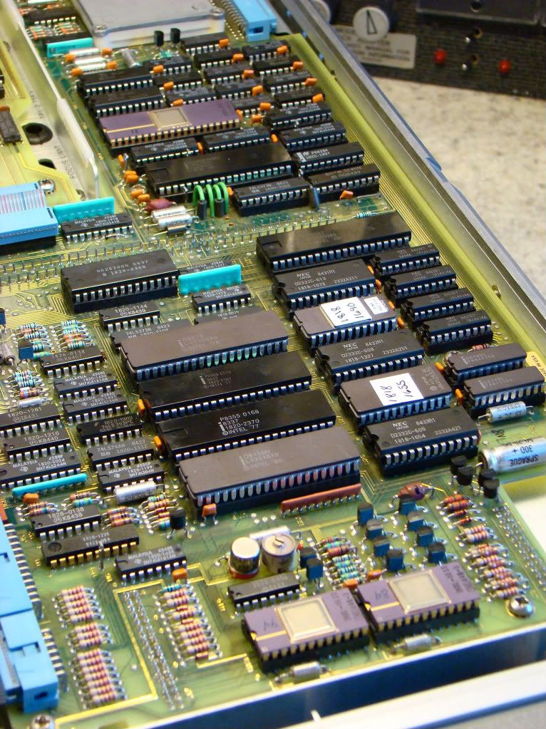

Digital processor and control board. The large metal thing at the back is a custom HP hybrid.

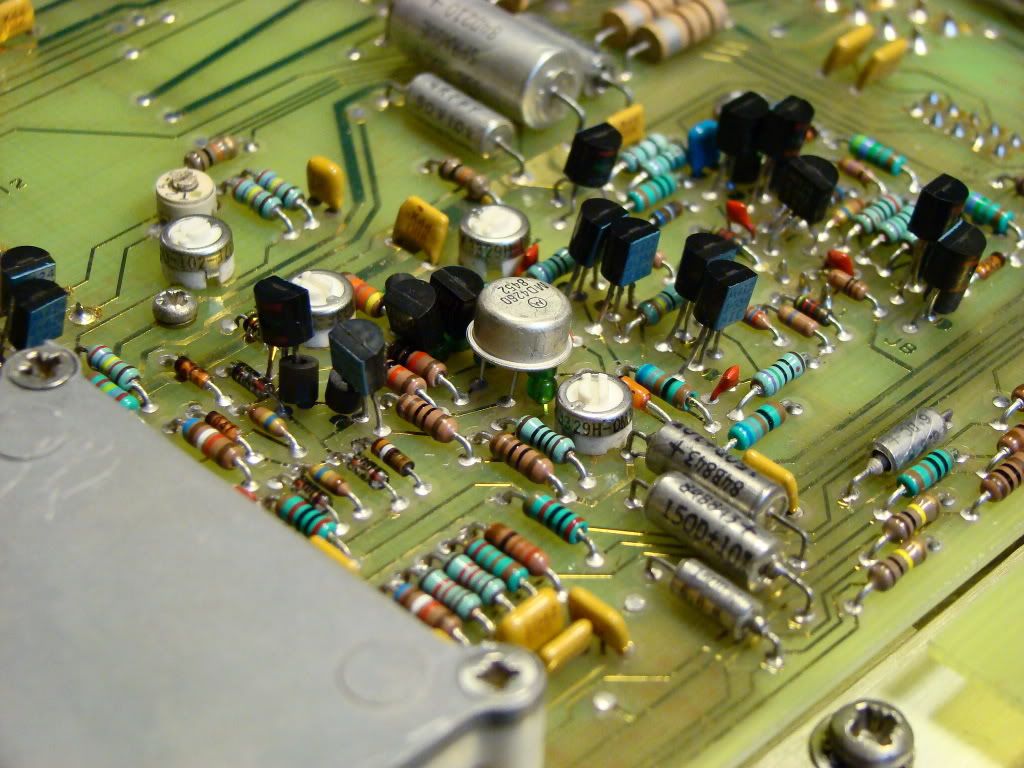

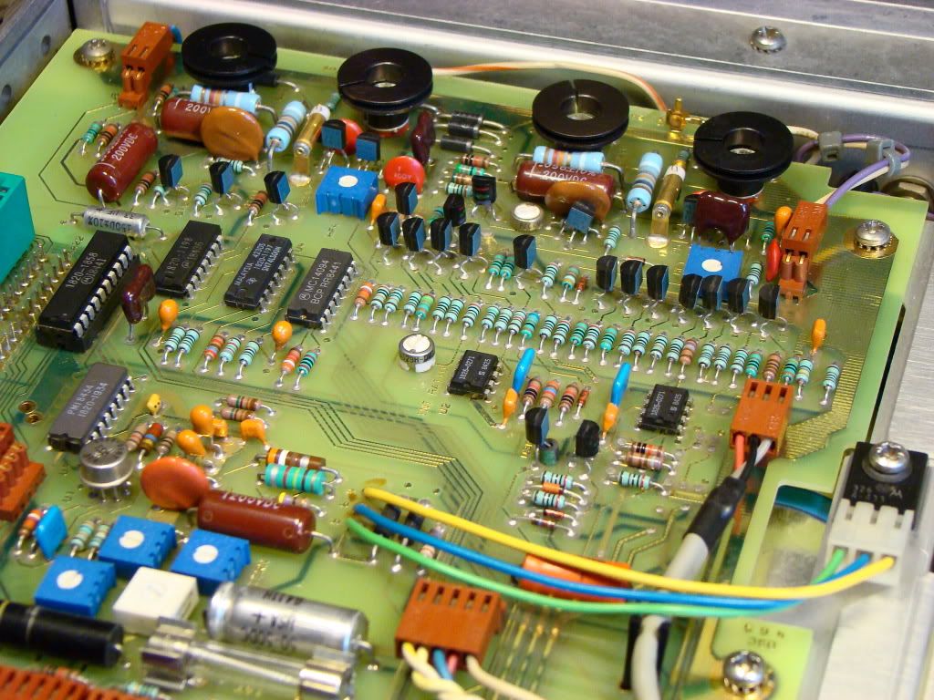

Lower board. Vertical and horizontal preamps, trigger amp, VCO time base, low voltage regulator, vertical and horizontal output amps.

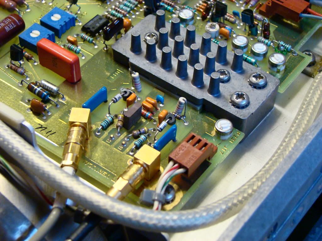

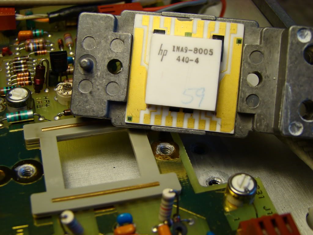

Another hybrid for the vertical preamplifier, lots of HF compensation, gain and offset adjustments here.

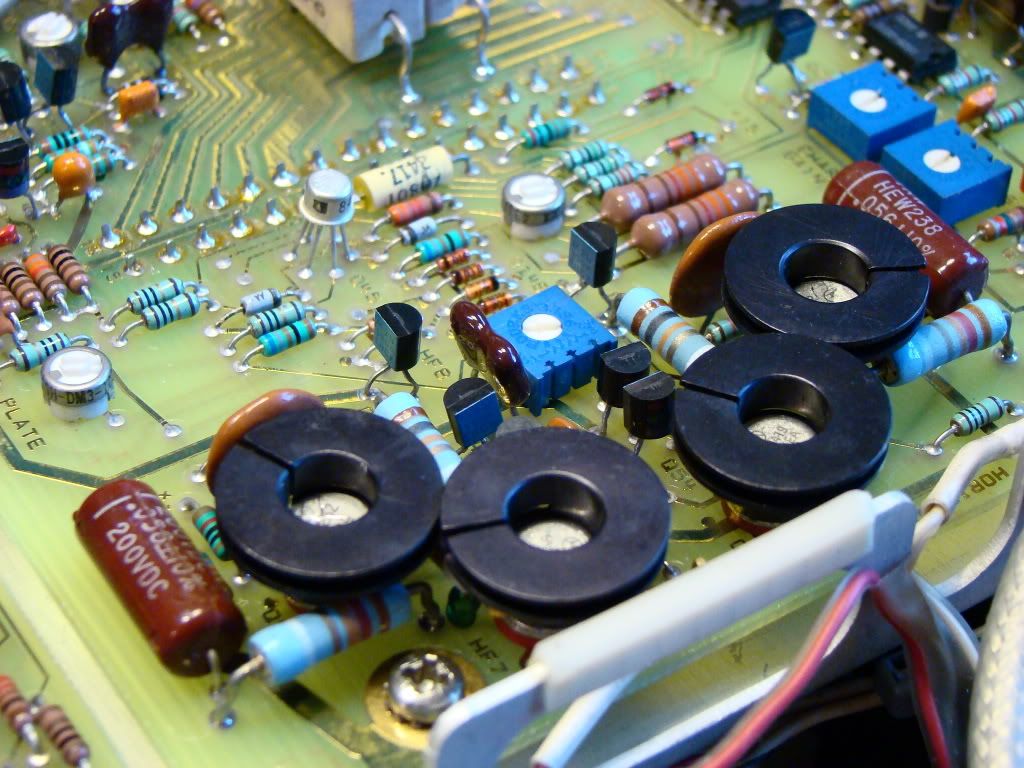

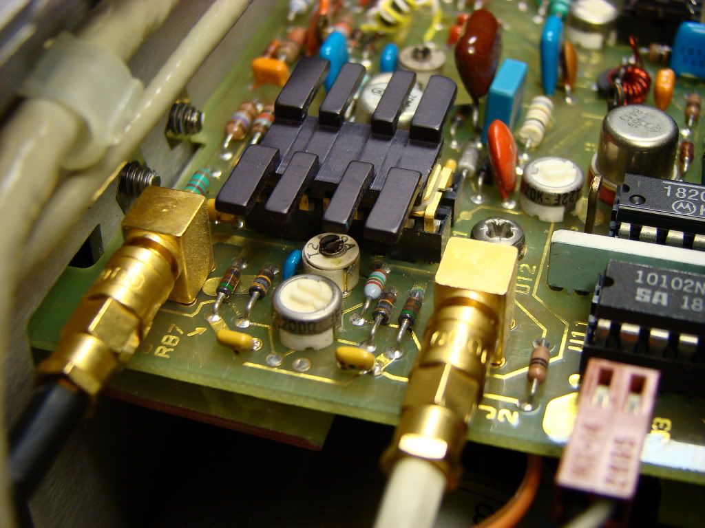

Horizontal output amplifier. The output goes directly to the horizontal deflection plates of the CRT.
Vertical output amplifier. This connects to the vertical deflection plates of the CRT and the digital sampling board.
Vertical output amp hybrid. The gold contacts need cleaning, otherwise still in perfect condition.

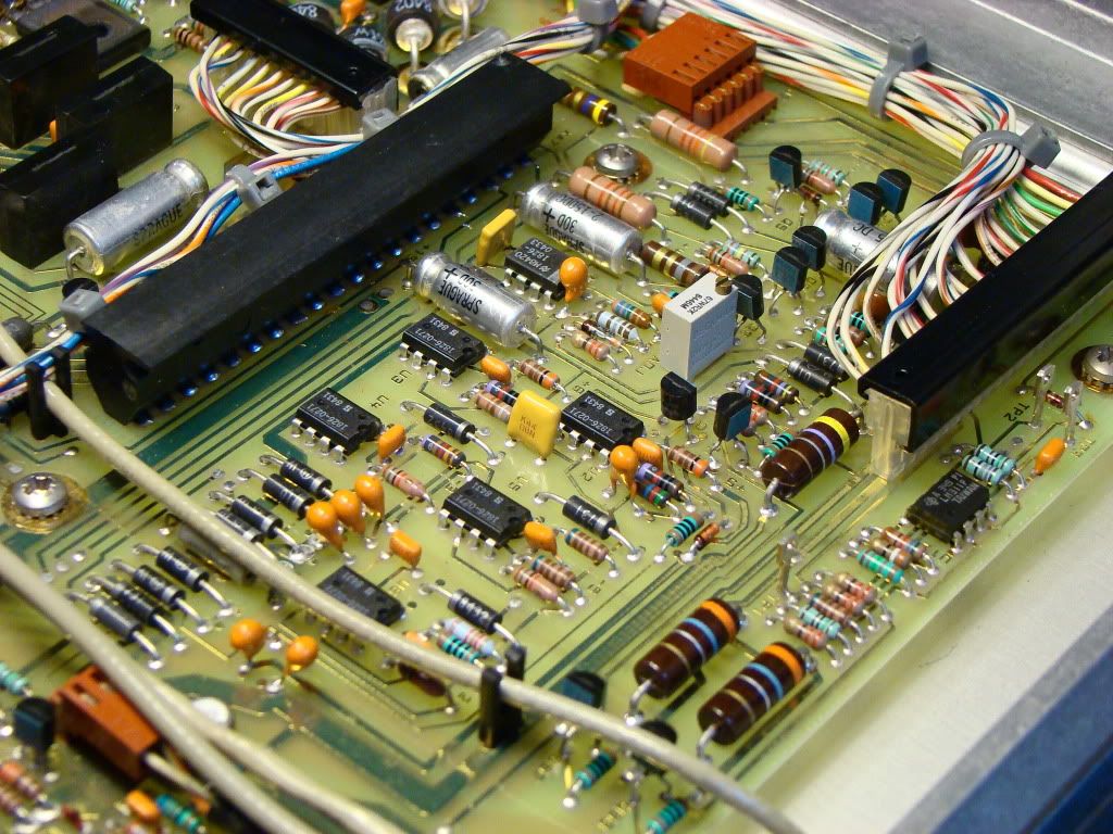

Low voltage regulator circuit. Lots of opamps and 9 big bridge rectifiers (3 below the board) for the 9 secondary windings of the massive 300W mains transformer.

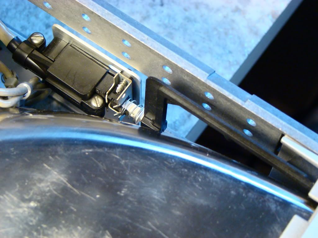

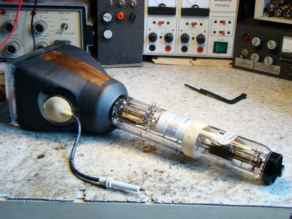

Hughe CRT!!! The deflection plates are gold plated. The anode voltage is 26KV.

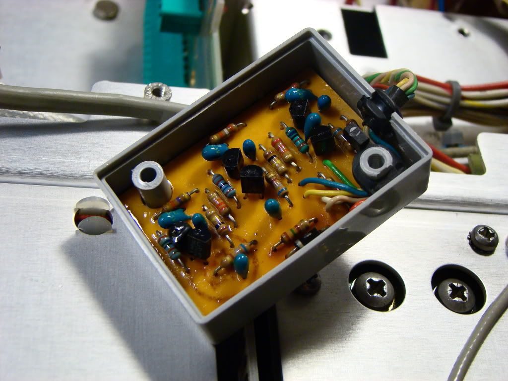

This is the fan driver. Yes, this is what it took to drive a simple brushless fan 30 years ago.
The fan is probably the smallest and loudest fan I've ever heard. It's impossible to have peace with this scope turned on.
And no, the fan CAN'T be replaced since it's very small and very high RPM. There's just no more room in this thing.

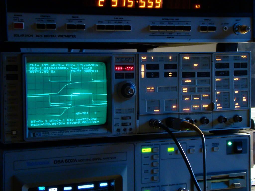

The screen interface is very nice. Individual readouts can be turned on or off by just a touch of a button.
A real lightshow. I tried to make most of the softbuttons illuminate.

Well, most of the softbuttons didn't work because if the contacts used to connect them to the pcb. The contacts are similar to the zebra strips used for LCDs. The hybrid ICs use the same principle. All the strips had to be cleaned. HV power supply was in serious need of cleaning because the dust gathered inside usually causes breakdown. Though the scope can be calibrated trough the front panel without removing the side panels, there are still quite a lot of trimpots and caps inside in need of calibration.
