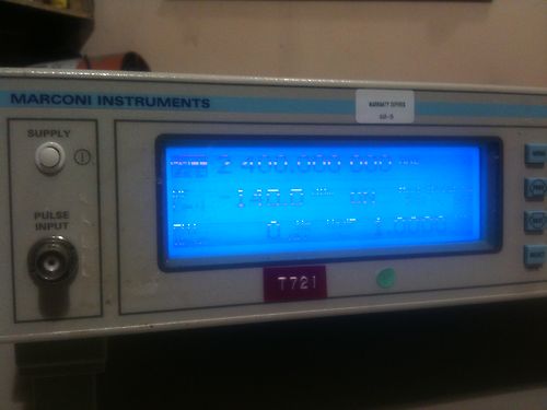

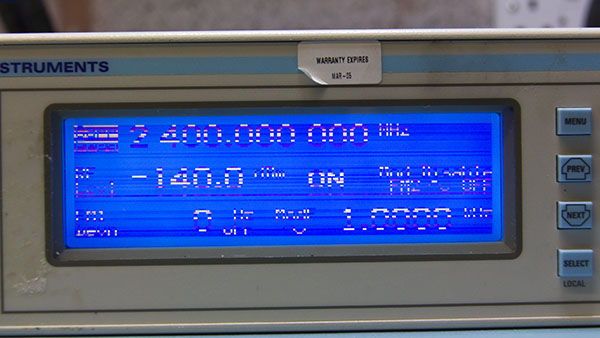

It looked like poor connections on the zebra strip in the LCD, an easy fix (I thought!) so I bought it.
Ok, got it home and powered it up. The original description was certainly correct - the display was not happy. However it worked well enough for me to do a quick check of the generator and all seemed fine apart from the LCD which was good news. The generator was fitted with options 04 (OCXO) and 11 (pulse modulation and high +25dBm output).
After a while the display seemed to improve but it was still a bit difficult to read.

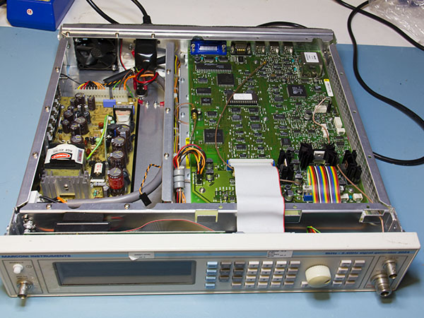

OK - time to crack it open :)

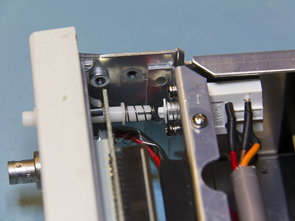

The first problem is that someone has been here first and not put the unit back together correctly - if you watch Dave's video there should be an aluminium plate screening the PSU. Ho Hum, at least they left the screws for me. Time to have a look for any more damage.
Hmmm, broken mains switch....
... and someone's "had a go" at the back of the N connector.....
... and there are only three screws holding the display in....
...but otherwise it doesn't look too bad.

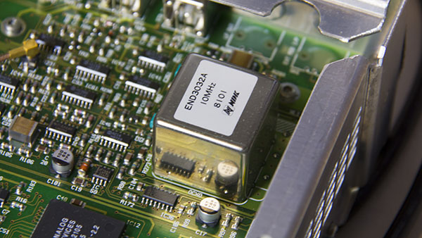

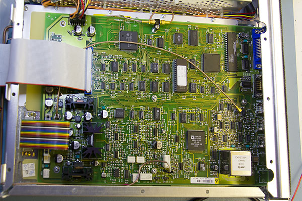

The main board is almost exactly as in Dave's teardown except for the OCXO in place of the TCXO in his 2023. Option 11 swaps out the attenuator unit for one with a higher power RF amplifier but that's hidden in the RF section. I'm not planning on opening that unless there's a clear need.
A closer look at the OCXO, it's an NDK unit but I can't find a datasheet anywhere for it.
Looking at the date stamps on the various ICs and the stored calibration date it would appear to have been built in Feb 1998.

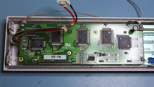

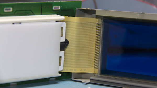

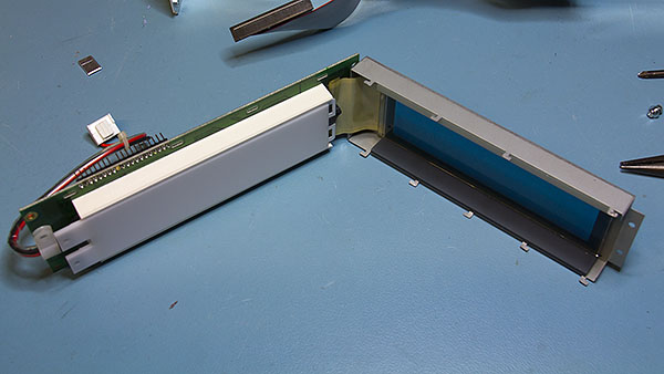

Moving on, to the LCD and I wasn't quite as happy as I had been. The problem seems to be the row drive connections as whole rows are not displayed or are not displaying correctly but, although there's a zebra strip (the grey block in the bottom right half of the display) it's only for the column connections. There's no zebra block for the row connectors but these use a flexible PCB strip.
Here's a close-up of the connector. It's bonded to the PCB and to the LCD itself but it's clear that whatever I do is not going to improve the connections. I did try a bit of pressure against the PCB end up and down the actual contacts but it didn't make any difference.
At this point I was a bit hacked off with myself for buying the sig gen - I've looked for replacement LCDs without much luck for previous items, so I was a bit doubtful whether I could locate one for the Marconi. All too often equipment has a custom panel, however this looked generic - an Optrex DMF 5010 so I ploughed on into Google.
On the positive side I found a data sheet fairly easily. On the less good side there are few hits from suppliers - not even hits from the "we'll quote you anything" brokers. The only place I found with stock had a MOQ of 60 (which appeared to be the entire stock) - I might have considered it at the right price but £25 each before shipping and VAT wasn't the right price :( Even ebay couldn't help :o

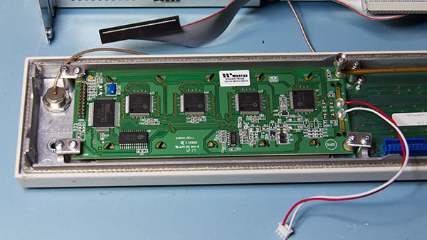

More Googling and things brightened up a bit. The Optrex board has a T6963 controller so I figured if I could find a panel with the same resolution/display area and controller it might work - in the end I found one quite close to home at Rapid Online and not all that expensive.
It's not an exact match though, it has an LED backlight, not CCFL and it's smaller at 180mm rather than 200 and about 8mm less deep, but it has a compatible controller (the RA6963) and the same pin out so I though it was worth buying one.

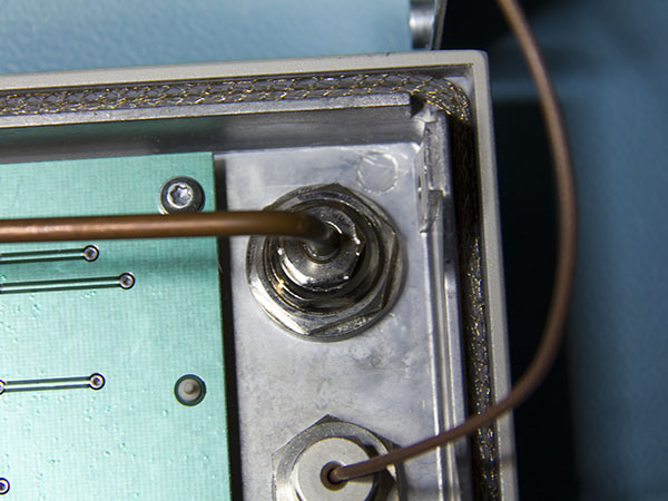

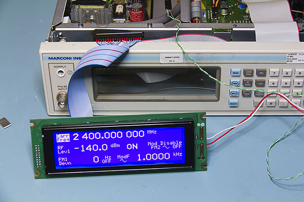

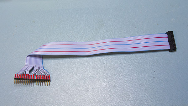

The first problem was to get it connected - the Winstar panel has a 2x10 pin connector, the Optrex one a 1x20. I didn't want to alter the original ribbon cable - generally if non-original parts need to be fitted I try to make things as "reversible" as possible so the plan was to use a piece of single row PCB header strip with ribbon cable soldered to make a plug to fit the cable IDC socket.
This didn't quite work as well as I'd hoped - the strip isn't really designed to have a cable soldered to it and even keeping soldering time to a minimum and the iron temperature as low as practical the pins almost immediately became loose. You can see in the photo that they're uneven. Fortunately it worked well enough without having to come up with another solution.
Next was the LED backlight supply. This turns out to be very easy as the CCFL inverter board is powered from 5V. The Winstar data sheet says that the LED has a VF of 3.5V and a forward current of 80mA, so with a 1.5V drop a 18ohm resistor should do nicely.

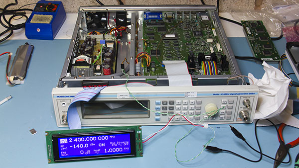

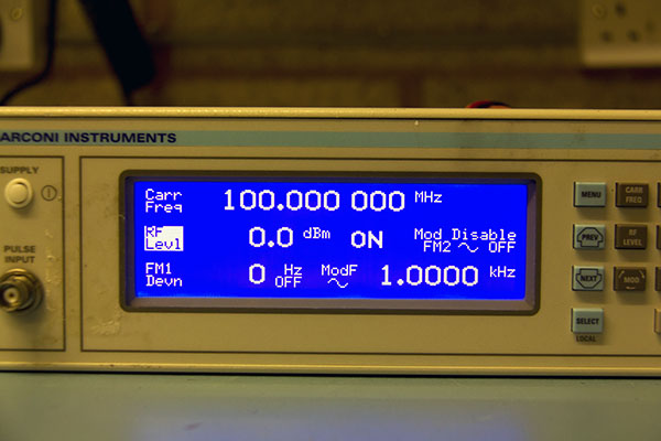

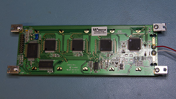

Connected it up and....
Bingo :) :) It works!!

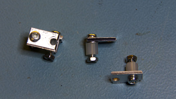

The next thing was to fix it in securely. I found some tiny aluminium plates, about 10x15mm in the junk box - absolutely no idea whether they had a purpose in life or were offcuts from something else but they were perfect to make small brackets to carry the new display. Two holes drilled 8.5mm apart to make up the horizontal difference and a 6mm threaded spacer to offset the panel a bit - here's what the result looks like.
and here they are attached to the display ready to go into the front panel
Finally here is the display mounted in the front panel and a shot of the new display in place.

A tip -- when soldering cables to pin-headers in the way you did, plug the pinheader strip into a matching socket.  This will help sink the heat away and preserve the alignment (straightness) of the pins while soldering.
The following users thanked this post: Uunoctium

As for the hotseal connector I've found that many times the problem is
where the connector is glued on the pcb. In the past I've "repaired" a few of them,
used a clean and round tipped soldering iron at 160°C, making a little pressure
on the adhesive connector where it is glued to pcb, moving the soldering
iron tip along the conductive strip, if you do this while the lcd is powered
you can see the line affected going on and off when you touch it.
But there is the risk is to damage the tape and once perforated no hope
to repair it anymore...
Thanks - now you mention it that seems the most obvious thing to do and I'm kicking myself for not thinking of it.
In the past I've "repaired" a few of them, used a clean and round tipped soldering iron at 160°C, making a little pressure on the adhesive connector where it is glued to pcb
I'd applied a little heat (hot air gun set at 150°C) to the strip to see if I could get the adhesive to flow but, as I said, this didn't alter much at all. Because of the design of the display it's not possible to apply heat and monitor changes while it's powered up - the frame covers everything and needs to be closed for the zebra strip to make contact.
As for the LED supply I had intended to replace the whole of the original board but that would really need a PCB making up. Also I didn't have any high current 1mH inductors so I just took the CFL inverter module off and replaced it with a bit of stripboard with a connector and two 36ohm resistors in parallel - I wanted a bit more power rating than 1/4W as the dissipation was about 0.12W and a single 1/4W resistor was getting slightly too warm.
This is the original CCFL inverter/Fan PSU board
An post modification it now looks like this.
If necessary the inverter can easily be put back together with the connector.

A bit of fairly straightforward fault finding followed: there was no modulation but trying AM caused a fixed increase in output amplitude and in FM a fixed shift in frequency so it looked as though the modulation circuits were being fed DC but were, themselves, working. Trying external modulation worked so it looked as though the LF generator was the cause of the problem.
The modulation signal is generated by a DSP (overkill?) then goes through a 20kHz low pass filter and a couple more op-amp buffers, this is the circuit (click on image for full-sized version)
Everything is together in this area of the board by the OXCO, the DSP is a Analog devices ADSP-2105 with an AD1856 serial DAC, the op amps are a couple of SOIC TL074's
It was fairly easy to follow the signal through to find that IC207d was hosed, signal present on the input but nothing on the output. A quick replacement:
Not completely happy with the soldering but I'm still getting the hang of these SMD things (yes, I know SOIC hardly counts :)
Finally checking the output shows all is well.

I'm pretty sure D647 is drawn backwards and if this is corrected then the whole bias system makes sense because the bias current in the top section will be several mA (biased from R602 up near the top LH corner of the full schematic)
So the whole circuit will be more balanced in terms of bias at around 5mA for both top an bottom :)
Doubling up SW10 on the 18.75MHz range will increase this bias by a couple of mA. Not sure why they are doing this but maybe this reduces the RF loss slightly. Seems odd to do this on the lowest frequency range...
I think you're right, here's the PCB:
D618 and D619 are the two vertical diodes in the centre. The cathodes are marked for most diodes on the silkscreen and these two are joined anode to anode as on the schematic.
D647 must be the unlabelled horizontal diode in the centre of the picture  - its cathode is connected to the junction of D618 and D619, not its anode as shown in the diagram so I think that you're spot on in your diagnosis.
