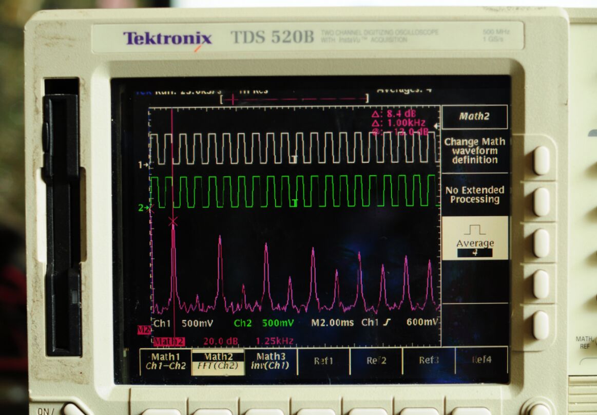

Conversion Tektronix TDS500 to TDS700 color oscilloscope
« on: February 02, 2018, 04:11:33 pm »

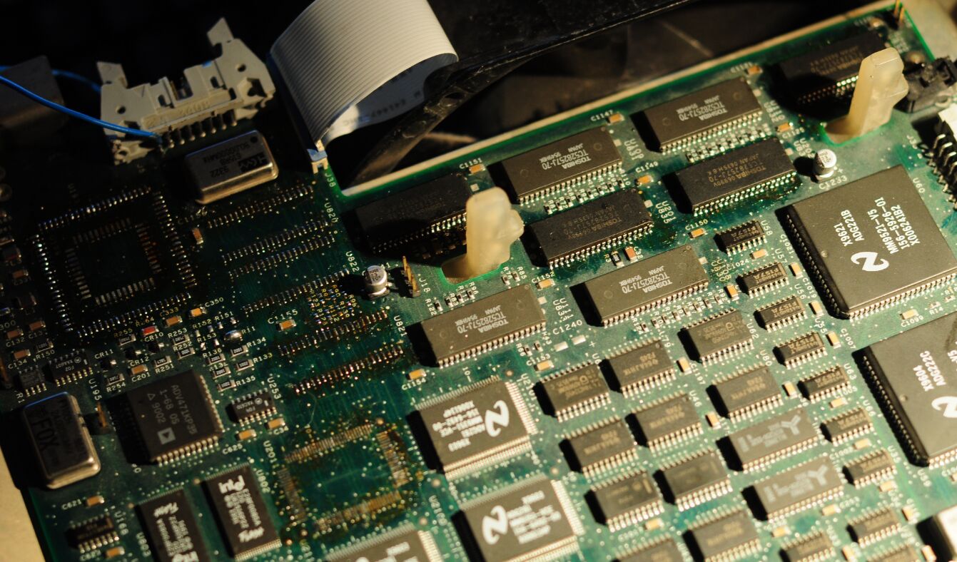

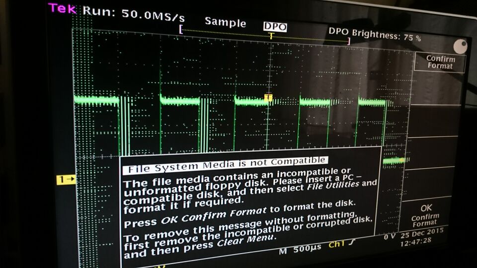

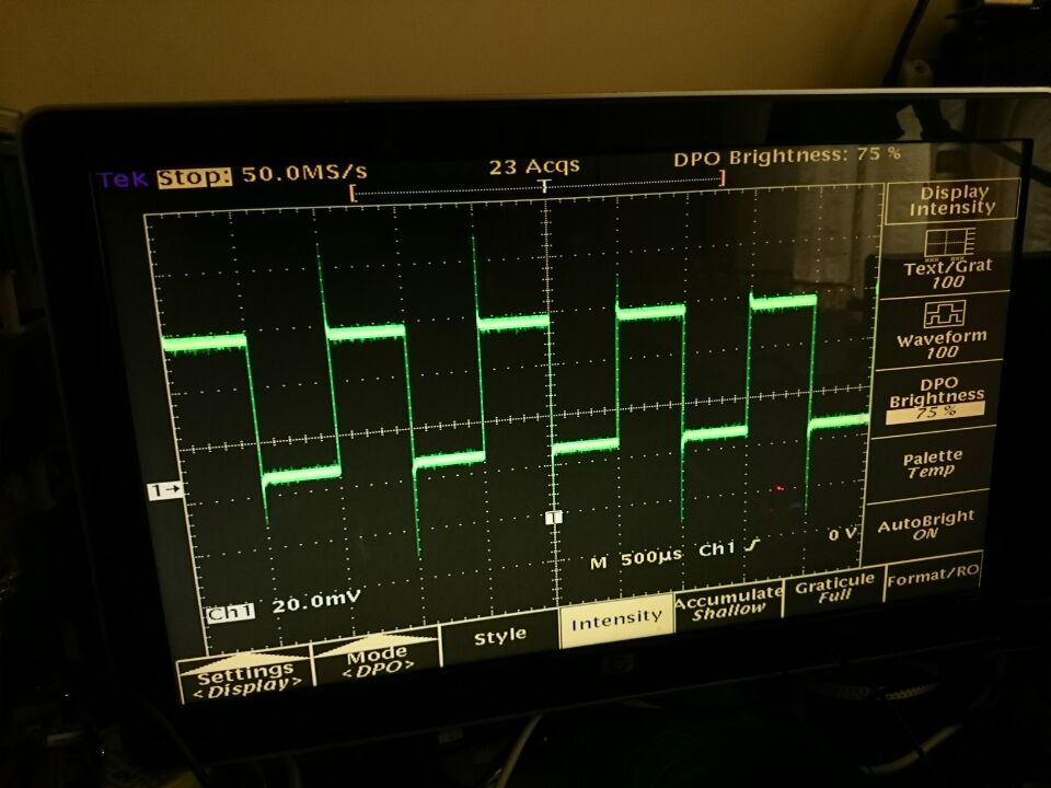

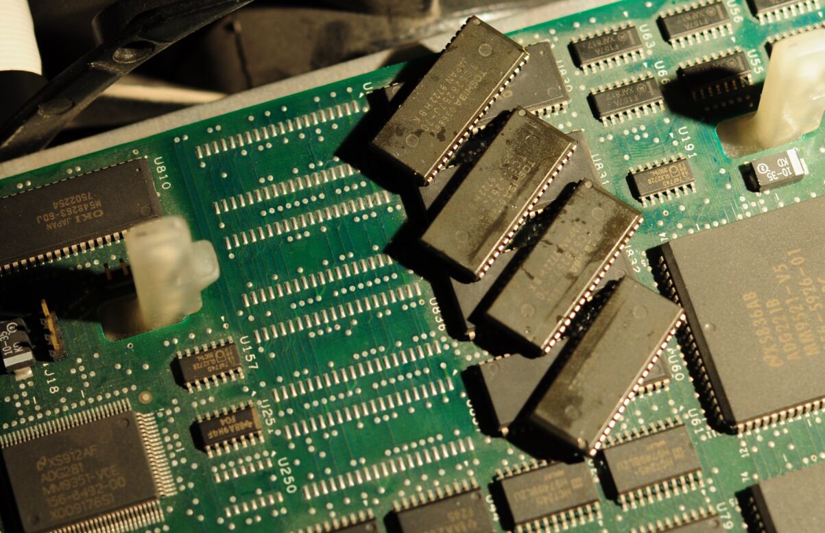

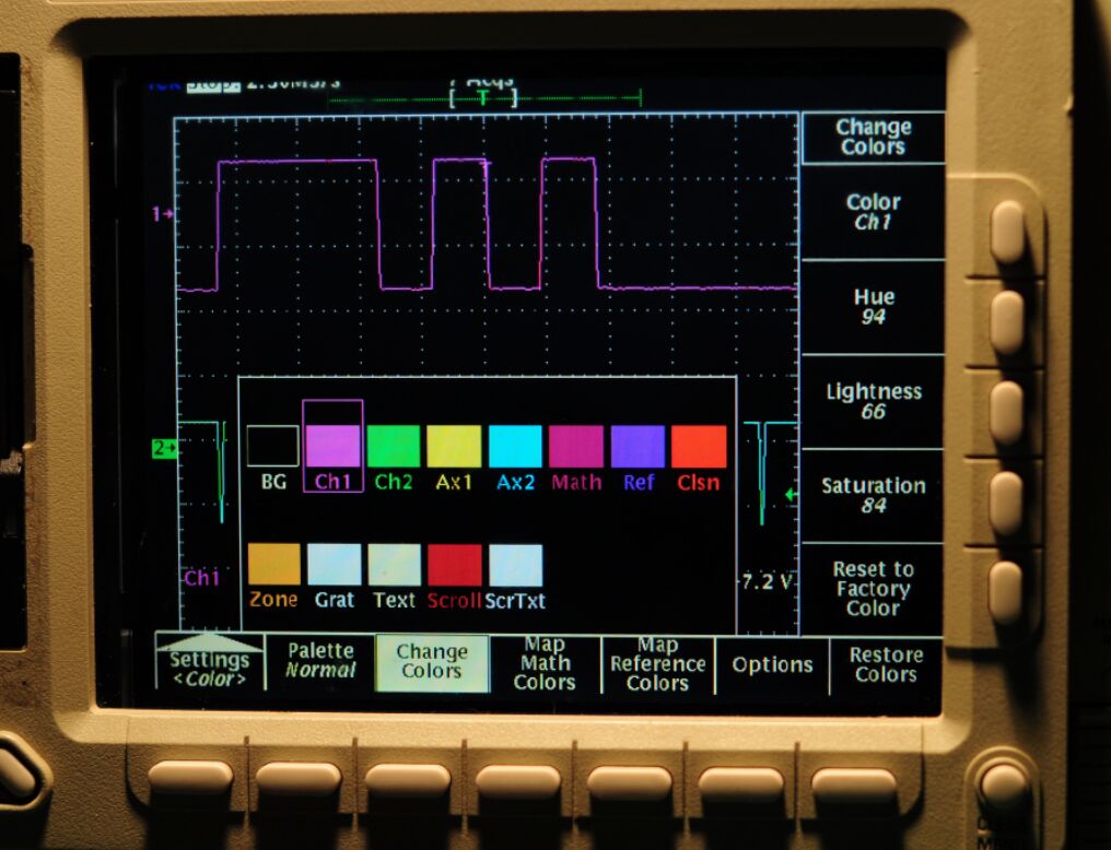

In model TDS500B/C/D has been successfully tested.
TDS500 and 700 series, in the same model, they have the same firmware and acquisition system, and similar processor board.
Only need to add and change some components, you can change TDS500 series to TDS700 series.
Before you upgrade, you should first install the color LCD monitor via the VGA out connector.
(A similar project (Simmconn Labs) to this topic, he uses FPGA reads display memory, and "color" the data. This solution is too complicated and expensive. :-BROKE)
TDS520B -> TDS724A
TDS540B -> TDS754A
TDS520C -> TDS724C
TDS540C -> TDS754C
TDS580C -> TDS784C
TDS520D -> TDS724D
TDS540D -> TDS754D
TDS580D -> TDS784D

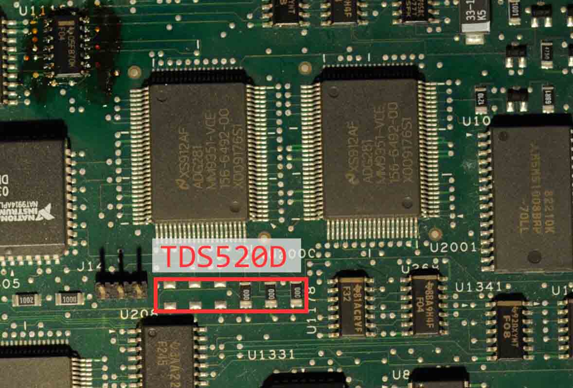

For TDS500B series(All changes are on the processor board).
remove:R12(model ID) R151 & R152 & R153
replace:U251 74F04 to U250

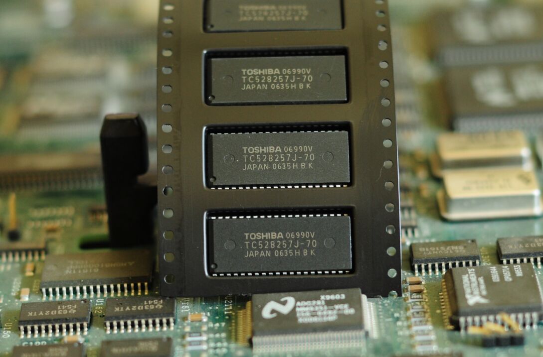

install:U837 & U835 & U836 & U834       TC528257J-70   Video RAM
For TDS500C/D series(All changes are on the processor board).
It has been a long time since I finished this work. I have forgotten which resistors I changed (for the model ID).
The following two pictures are used to compare their differences, please try it yourself. :palm:
install:U834 & U835 & U836 & U837       TC528257J-70 or M548263-60J   Video RAM
Soldering SOJ packages is a bit difficult, make sure they are soldered reliably. Otherwise there will be a vertical line or flashing display.
enjoy it.  :D

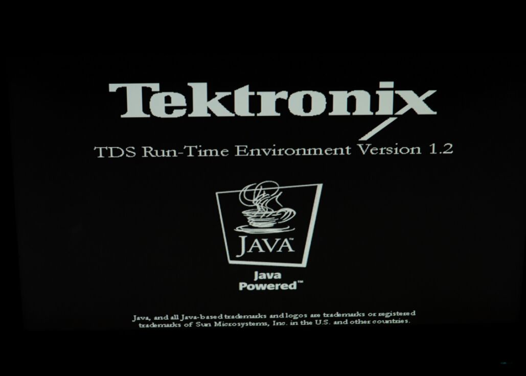

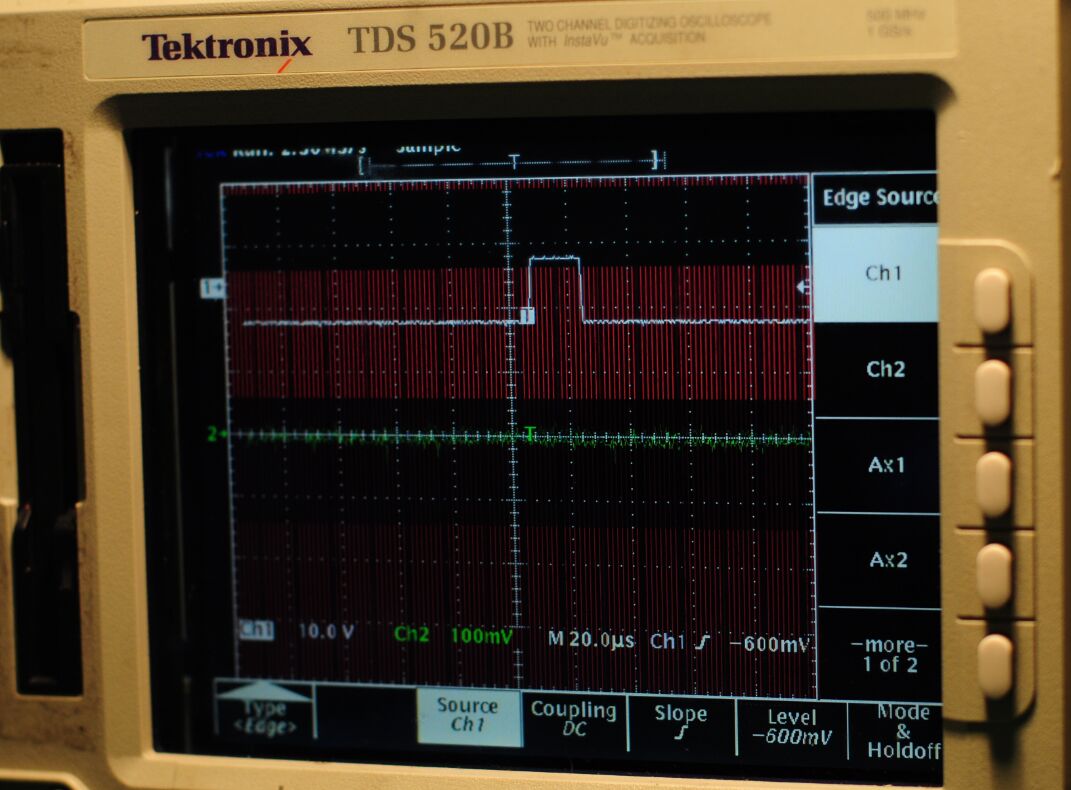

I did a conversion of my TDS540D to TDS754D some weeks ago.
I can state the modifications zxase258 wrote to be partly correct, but maybe not complete.
Adding the VRAM - soldering was easier I thought.

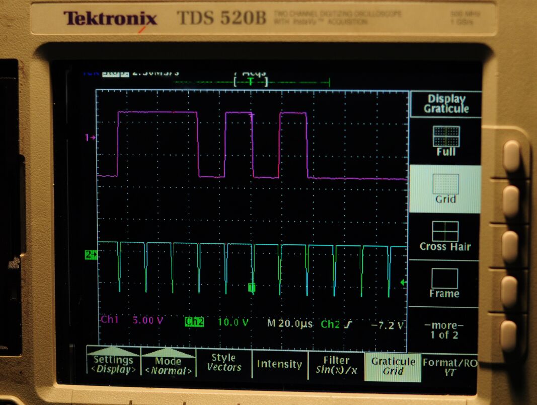

Swapping U251 to U250 - rubbish on CRT (like lost sync, ic handles some picture timing signal, see service manual), no picture on VGA [timing critical part, my replacement ic was some nanoseconds too slow  :-[ ]
Swap back 250/251 - i belive it was white blank on CRT, but colour scope screen on VGA.
So far, fine.
But the scope boots up with one minor error about missing or wrong VRAM registers. Think there is some further action needed.
Maybe its missing the circuitry for the NuColor shutter system, a QFP and 3  VRAM-like footprints in the video section are not populated. Factory 745D have them populated.
serial boot debug:
dsyPM011RegMem ................. ***FAIL*** ..error details:
ERRORID: 163 diagnostic test failure dsyPM011RegMem ** addr = 0x75ed808  exp data = 0x7f00  actual = 0xff00
Failure in first PM011 vdramal register
Apart from that and after replacing a brick CAL-EEPROM and recalibration, the scope works fine with a 19" color screen via the rear VGA port.
Lucky me, so I can read the screen without my glasses, which I often set off while debugging :-DD
greeting, induzer   :-+

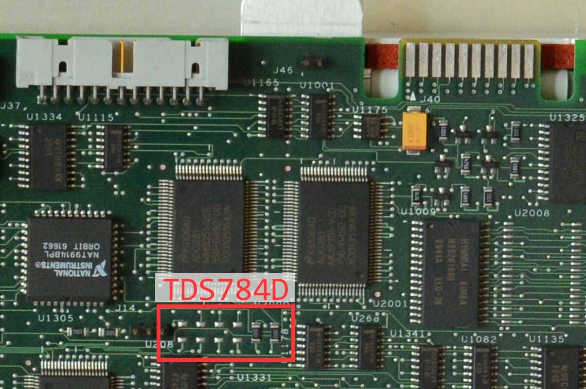

Had a quick look at the schematics.
It's definite the missing frame buffers VRAMs U820 to U822 and the ASIC U2011 (National ADG281)
U822 is also called PM011, see my fault code in the last post. Missed that until now  :-[
So the following Parts need to be modified for 540D to 754D conversion (all on CPU board):
- CHANGE the ID resistors like shown in picture and table
- INSERT U834 & U835 & U836 & U837 + U820 & U821 & U822 == TC528257J-70 or M548263-60J   Video RAM
- TRY REMOVE U251 == 74F04
- TRY INSERT U250 == 74F04 (use fast ic or save U251)
  (crt picture, see my earlier experiences)
- INSERT U2011 == ADG281 == MM9351-VCE
If you can live with error an selftest and are happy with external screen only, leave U2011 & U820 & U821 & U822 open.
As far as I can speak for my own scope, it does not affect the meaurement.
Maybe someone will proof that I got confused while playing around with U250 / U251 for saving the internal screen functional. :-//
induzer :-/O
« Last Edit: February 28, 2019, 10:55:48 pm by induzer »

Okay! I've substituted the TC528257J-70 vram chips with TC528267J-60 and it works just fine. The TC528267J-60 chips where half the price on ebay. As for the ASIC I haven't been able to get one yet. The scope powers on in 754 mode with the built in CRT displaying Text on white background with no waveform, and the VGA out displays full color without error.
It does fail the processor self test when run manually but everything else seem to work fine. I guess this might have something to do with the missing ASIC chip. Maybe if someone here has a dead board they are willing to de-solder one of the ASICs and send one my way? Ill buy! Plus beer if your in the DFW area.
I guess I would also need U193. Lots of NOS tlc34075 on ebay from what it looks like!
I should also add that moving U251 to U250 causes the internal display to go out of sync while doing nothing for the VGA output. So for now I'm just going to leave it at U251. The Internal display is white but the VGA output is still in color. LUCKILY! Putting the jumper resistors back to the 540C config allows it to work fine even after adding the addition ram chips!
« Last Edit: March 08, 2019, 01:51:10 am by PerpetualWalnut »

According to my tests, the ADG281 is not a required component and it is connected to the TLC34075. The TLC34075 is only used to generate the sync signal required by the NuColor LCD shutter. Even if you do not install ADG281, TLC34075, and VRAM associated with TLC34075, the oscilloscope can PASSED self-test

Maybe someone could verify this new test I've done.
Connected a color external display (DELL) to my TDS540C (black and white) via the video connector.
When I boot, both displays show the same thing except during 1 or 2 seconds, the external display shows different colors. Then the external display shifts to black and white but my question, is there a way to block or disable the firmware so the TDS540C with external display becomes a TDS754C ?
Thanks, Albert

Got some promising results - I'm able to use an external VGA monitor in colour (TDS784) mode while preserving the original TDS580C internal B/W display.
What did I do:
Thanks to madao, I've received a ADG281 ASIC, and some VRAMs (TC528267J-70) from an American ebay seller. Following most of this threads instructions, I soldered the ASIC and seven VRAM chips to the CPU board, replaced U251 to U250, and removed the ID resistor to change the model to TDS784. This works and results in a non-synchronized internal display (as someone pointed out before). Placing U250 back to U251 brought the internal display back to sync, but didn't display a useful picture (as pointed out before). Since I didn't replace U190 by U193 (TLC34075, the RAMDAC for the NuColor internal display), the Display self test results in a failure indicating U193 (go figure :)).
Now, what happens: U199 provides the VGA output for all (colour and B/W models), this works. U190 provides the internal display output in B/W models, and doesn't if a colour model is selected. Turns out, its colour palette registers never get written by the firmware in colour mode (why should the fw do so, since this chip isn't present in colour models). So the palette register have some random content after power on, resulting in an unusable display. Anyway, this leads to simple fix: Remove U190 pin 16 (\WR) from the signal WDAC1*\I and connect this pin in parallel to U199 pin 16 (WDAC2*\I). Now both RAMDACs get written with the same contents, so U190 outputs the same video contents as U199 does to the external memory. In a second step, remove FSYNC/VIDEO*\I from pin 25 (red output) and connect this signal to pin 26 (green output).
Voila: The internal display shows a useful picture with the monochrome palette selected from the menu (the external monitor shows all traces in green in this mode). One can edit the colours to display the traces at different brightness levels.
As said before, the ADG281 and three VRAMs aren't required for this to work, one requires them if a real NuColor display is to be connected. In this case, one has to replace U190 by U193 also, move U251 to U250 and populate U260. Since I don't have a NuColor display, I cannot verify this.
