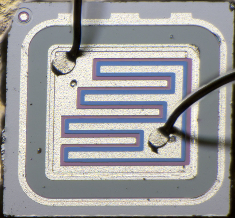

A new 2N3055! This one is built by Sescosem.
Since I didn´t find a datasheet I don´t know what TVCD means.  :-//
There is a heatspreader in the package that takes up almost the entire area. A relatively large amount of solder was used to attach the die to the heatspreader.
The transistor has a MESA structure and is covered with a transparent protective coating. At the lower edge you can see that it wasn´t cut out of the wafer a clean as they do it today.
The MESA structure is clearly visible.
There are some relatively deep holes on the MESA edge. The etching process of the MESA structure does not seem to have been very accurate.
In the upper left corner you can see an impressive manufacturing defect. A large trench has formed parallel to the MESA structure. The trench is so close to the active area that the metal layer in this corner became very narrow.
The surface of the transistor has no unusual structures. Under the outer metal surface, the contact area to the silicon seems to be somewhat larger than necessary. Towards the base-emitter interface, its edge can be seen a little.

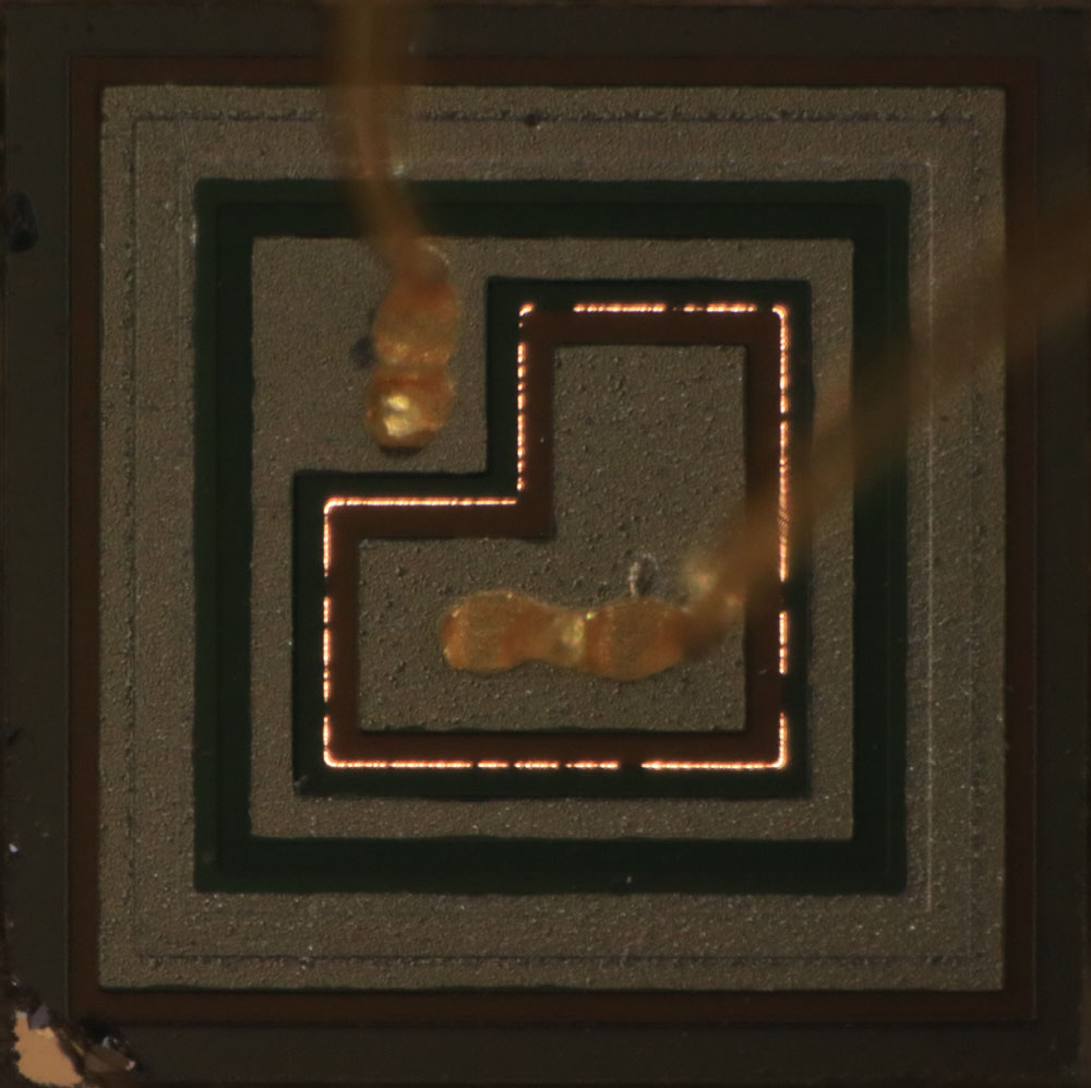

For an epitaxial transistor, the breakdown of the base-emitter path occurs relatively late at -15V. This can probably be explained by the fact that this is an early model of an epitaxial transistor. Compared to modern transistors with their much more clean processes, the concentration of dopants had to be chosen lower in the past.
In the picture above, the current increases as follows: 5mA, 10mA, 20mA, 30mA, 40mA, 50mA, 100mA, 200mA, 300mA. The luminous effect is distributed fairly evenly across the junction.

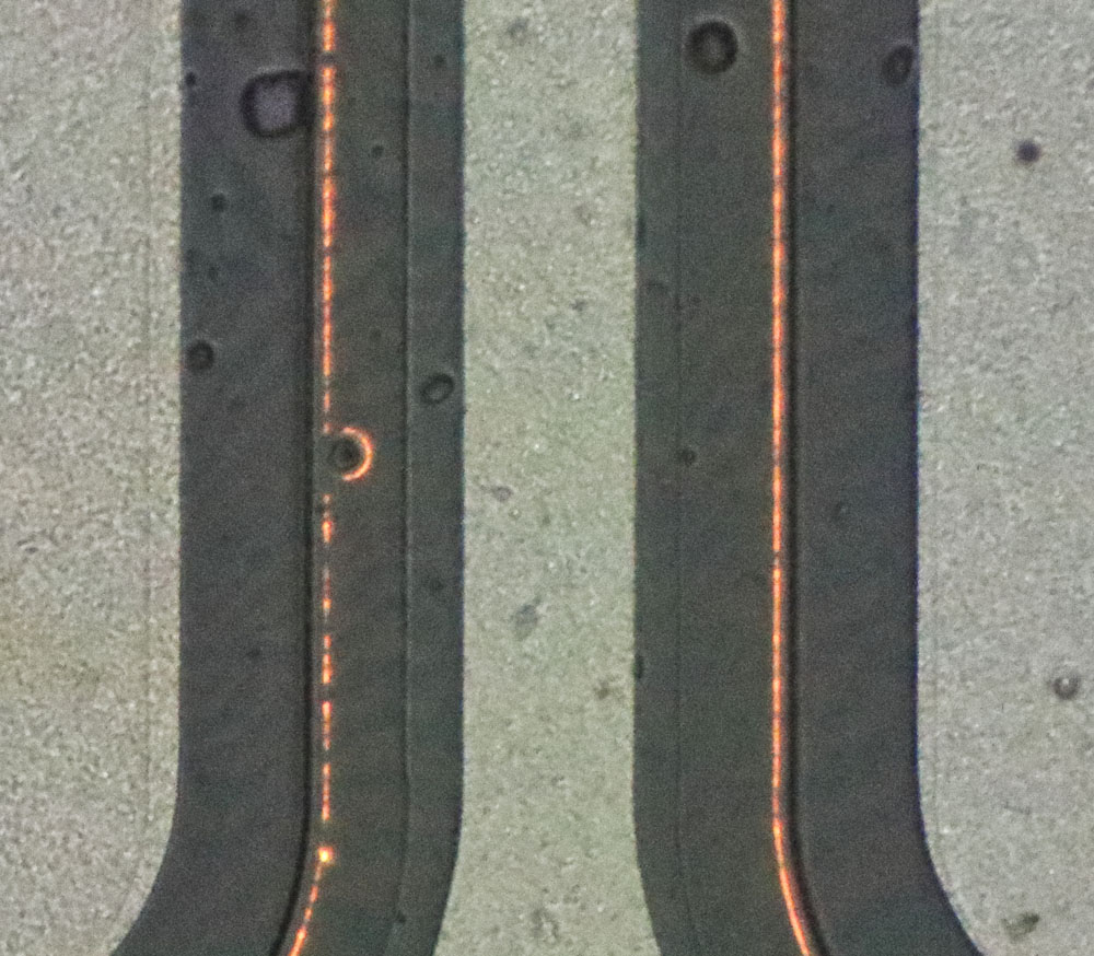

Operation in the breakdown shows a strikingly large disturbance in the junction. The current flow you can see here is 100mA, 200mA, 300mA, 400mA, 500mA.
The semi-circular glow forms around a round disturbance near the junction. Many optical artefacts are merely impurities on the surface of the transistor or the protective coating. Here, however, there is actually a disturbance in the active area. It is impossible to be sure what is happening in this area. In any case, the junction has expanded to the right. It could be that the circle contains the emitter doping that has entered the base area due to a weakness in the manufacturing process.
In the lower area on the left side there is another disturbance, which is only noticeable by a relatively bright dot. This is probably a minor irregularity as seen in the BUX22 built by ST Microelectronics (https://www.richis-lab.de/Bipolar07.htm#defect).
The prolonged operation in the base emitter breakdown ultimately destroyed the junction in the lower left corner.
In detail, you can see that the surface on the edge of the outer metallisation has also been etched in the form of the MESA structure.
The path along which the current has concentrated after the junction has collapsed is clearly visible. Both on the side of the base and on the side of the emitter, a path can be seen that leads to the junction. The metal layer has melted on both sides and cracks can be seen in the surface between them.
Due to the damage, the contact area in the passivation layer is now also more clearly visible. Inside the recess, the silicon has melted a little. Presumably it has entered into an alloy with the metal layer. Where the passivation layer begins, the current path appears greenish. Following this, the current path narrows and the current density increases. According to the optical appearance, the material is more damaged in this area. The emitter area seems to be less damaged, perhaps because of the higher doping.

I hope you weren't using a bench supply (CC/CV with big capacitor on the output) for that test...were you?  :horse:

That wasn´t the problem. The problem was to much heat. I try to take the pictures without a bulky heatsink. Most of the time that works quite well but sometimes I´m too impatient and even a few watt generate a lot of heat...  >:D

I know, for the initial failure it's just straight up heat; I mean the subsequent melting. >:D

I assume concentrating the power at such a small area would melt the structures independent of the bench supply.
...but yes, it was the cheap one...  ;D

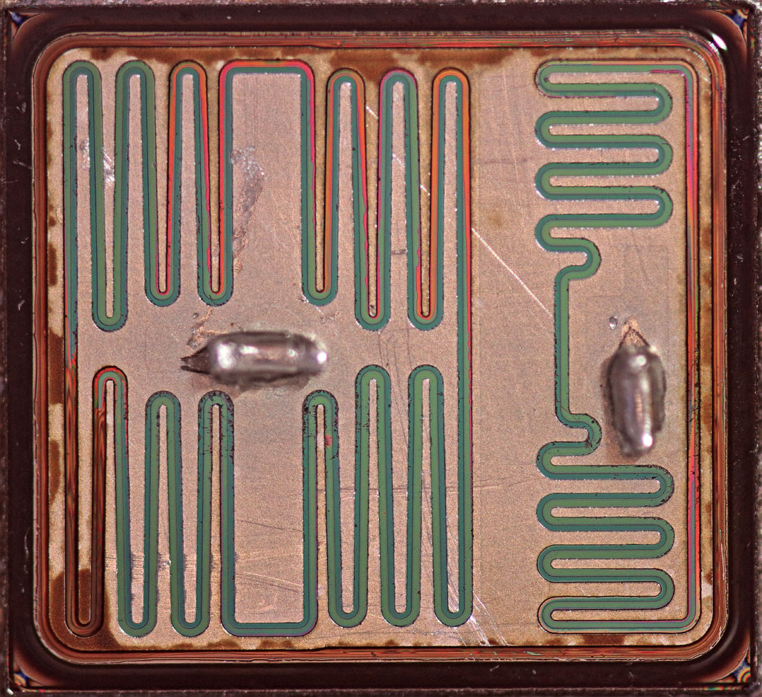

The BUX37 is a Darlington transistor with an integrated free-wheeling diode. The present model was produced by Thomson Semiconducteurs in 1980. The transistor blocks up to 400V and conducts up to 15A. If the case temperature remains below 100°C, up to 35W can be dissipated. The current gain is at least 20.
In the package there is a large heatspreader. Channels in the heatspreader allow excess solder to flow off.
The dimensions of the die are 6,0mm x 5,5mm. A transparent varnish protects the transistor against environmental influences. The particles on the protective varnish were created while opening the case.
It is obviously a MESA transistor. From the outside to the inside, parts of the surface have turned brown.
The protective coating can be removed relatively easily, allowing an unobstructed view of the structures.
The driver transistor is located in the right area (yellow), the transistor of the power path is integrated in the left area (red). The free-wheeling diode and the resistors are not visible here. A more detailed description of the structure and operation of such a Darlington transistor can be found within the documentation of the SU111 (https://www.richis-lab.de/Bipolar59.htm).
Under the thick protective coating, there is obviously an additional thin passivation layer on the transistor. Either the coating itself has turned brown or there is contamination underneath. Brown degradation of the silicon seems rather unlikely.
The outer edges of the transistor are very rough. It could be that the surface has been scored for singulation. In the valley of the MESA structure an additional step can be seen.
Some spots give the impression that the degradation has penetrated into the area of the semiconductor and not only has changed the protective layer. However, it could be that the passivation has changed especially at edges and that is why it looks like this.

I wonder how they implemented the diode. P-region buried under the emitter contact, perhaps?  There's a faint outline under the emitter metal, but that could just be connections.
I wonder if a parasitic SCR (PNPN) breakdown mode could be activated, say with large dV/dt, or forward or reverse avalanche...
I assume that's the same as with the SU111:
https://www.eevblog.com/forum/projects/transistors-die-pictures/msg3585647/#msg3585647
I don't see an SCR but with that much p and n you can never be sure.

Ah, right, they could use the base layer; which also implements the B-E resistor, assuming the resistivity and geometry of the layer works out (which seems to be the case). Nice. :)
Any PNPN behavior would be driven by lateral motion, which is probably a very long shot over the width of this die, yeah.

These integrated Darlingtons are really a piece of art. A simpel looking piece of art but nevertheless a piece of art.  8)
