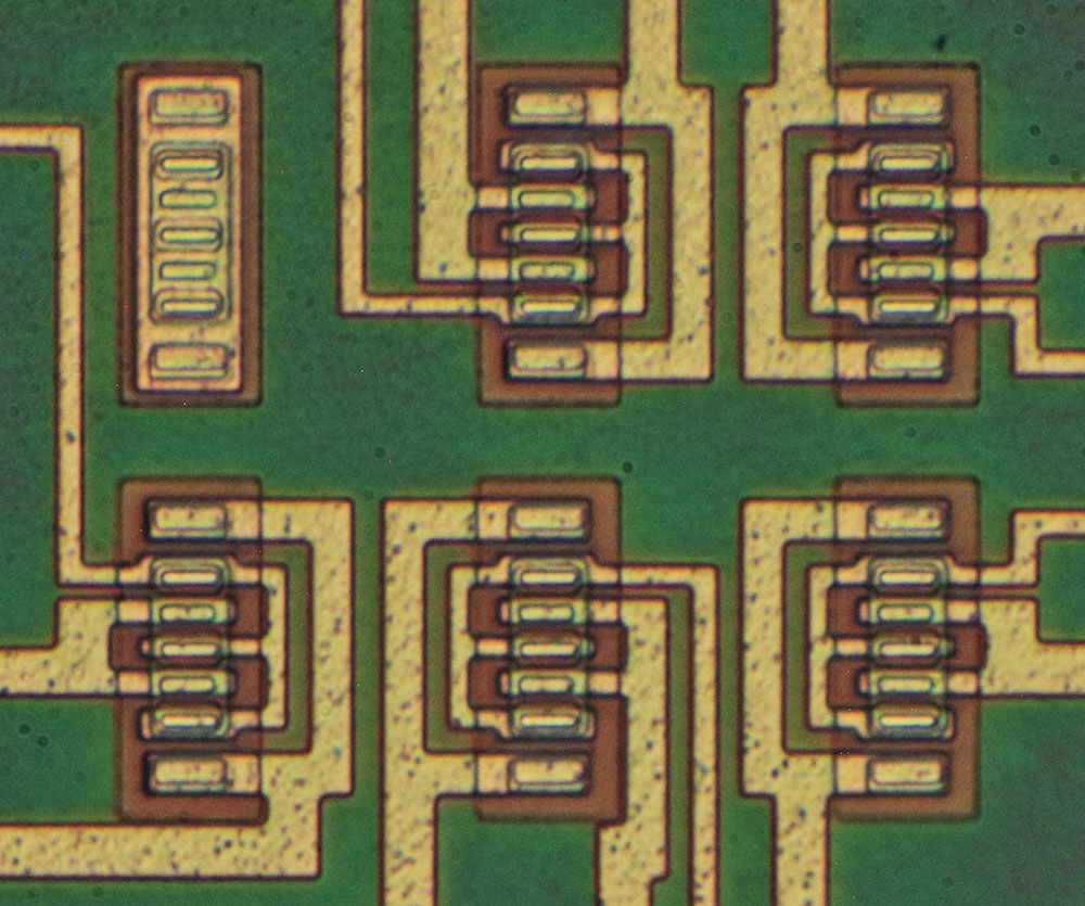

SL3127, a fast transistor array built by Plessey Semiconductors. There are five transistors with a ft of 1,6Ghz at 5mA collector current. The maximum collector emitter voltage is 18V. The base emitter voltages differ no more than 5mV.
There is a substrate contact which you have to connect to the most negative voltage of the transistors. You can also use a more negative potential. That reduces the leakage current and the parasitic capacitance. Maximum collector substrate voltage is 55V typ. (but only 20V min.!).
The die is 1,1mm x 1,0mm. WH047B is the internal name. There are a lot of structures to check the process quality.
There are six transistors. The unused one is shorted with a metal strip. There is also an unused substrate contact. With a different metal layer you get a different circuit.
The brown area is the collector area (n) isolated from the green area (p). The collector potential is connected at the top and at the bottom of the transistor. It looks like there is an area around the collector contact. That is probably an area with higher doping for low resistance in the collector path.
Base and emitter are a little strange. There is a big rectangle which is connected to the emitter pin by two vias. There are three base contacts which seem to contact three smaller areas in the emitter rectangle. Such an arrangement only makes sense if it´s a perforated emitter like structure.
https://www.richis-lab.de/Bipolar79.htm
 :-/O

The SL3145 and the SL3127 share the same datasheet.
The SL3145 gives you 5 transistors too. It´s packaged in a smaller package (DIL-14 vs. DIL-16). To reduce the pincount there are two emitters connected for a differential stage and the substrate is connected to these two emitters.
No surprise: The die is basically the same as the die in the SL3127 but the metal layer is different. The SL3145 uses the upper substrate contact, the transistor in the middle of the upper line is shorted and the transistors in the lower right corner are connected together (connections of collector and emitter are quite similar to get a good matching of the differential stage). The internal naming is WH047A (vs. WH047B).
https://www.richis-lab.de/Bipolar80.htm

The substrate is connected to another emitter, rather.
A likely application for this arrangement (also CA3086, LM3086 etc.) is the substrate-emitter transistor serves as current sink, the common-emitter pair is the diff pair on top of it, and the other two can be used for whatever, maybe cascode or follower at the diff amp collectors.  (Another monolithic pair would be needed for PNP current mirrors, if using that type of design.  Would be handy if they put PNPs into the same package, but alas.)  Gain depends on bias (no external resistance between emitters), so this is useful for mixers and variable-gain (OTA) circuits as well as plain old amplifiers.
Correct, that was a mistake on my side. Sorry!
The five transistors are ideal to built mixer stages, "Gilbert-Zelle" in Germany.
https://de.m.wikipedia.org/wiki/Gilbertzelle

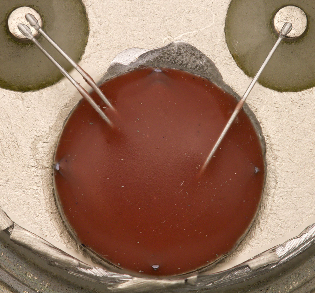

The Gleichrichterwerk Stahnsdorf had built a MJ3001 too.
There is the red potting we often have seen in "eastern" transistors.
In the SU111 they used two different bondwire diameters (https://www.richis-lab.de/Bipolar59.htm). In the MJ3001 they used only one diameter and two of them for the emitter contact.
The die is orientated in a way you are able to bond the wires as good as possible.
The die looks like the die in the SU111 (https://www.richis-lab.de/Bipolar59.htm). It´s quite possible they used the same die here, perhaps a different bin of the SU111. The SU111 can conduct the same current as the Motorola MJ3001 (https://www.richis-lab.de/Bipolar60.htm) but the maximum Vce is a lot higher (400V).
The edge of the die is a little different. In the SU111 the MESA structure left a small strip that is removed nearly completely in the MJ3001. Just in the corners there is a little "tower" left.
https://www.richis-lab.de/Bipolar81.htm
 :-/O
