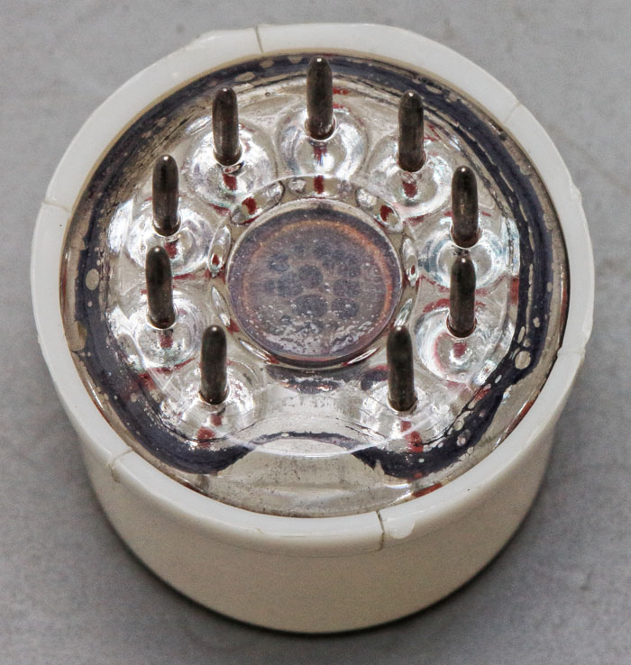

Thanks! Would be a good solution for a RMS detector. The more modern version is the LT1088:https://richis-lab.de/LT1088.htm
The wires were soldered to the connector pins... ...but that tin ball doesn´t look good.
