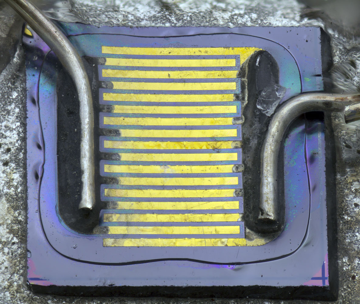

We had these KT808AM built 1984 and 1986. That was the new design of the KT808.
Here we have a KT808AM built 1982.
In this KT808AM we see the old transistor design.
They had some problems with the bondwires. One of the wires got bent accidentally. While this happened the wire was torn off the die.
There seems to be a thin transparent coating on the die.
The edge length of the die is 5,0mm. It´s significant bigger than the die in the newer KT808 (4,3mm).
It´s no surprise older datasheet state a ft of 2MHz while newer datasheets speak of 8MHz.
At the edges there are blue traces probably marking the area where to saw the wafer.
There is a uncommon MESA structure around the transistor.
The bondwires are soldered to the metal structures.
The structures are quite dirty...  ???
Yeah, lights on!
Some more pictures here:
https://www.richis-lab.de/Bipolar67.htm

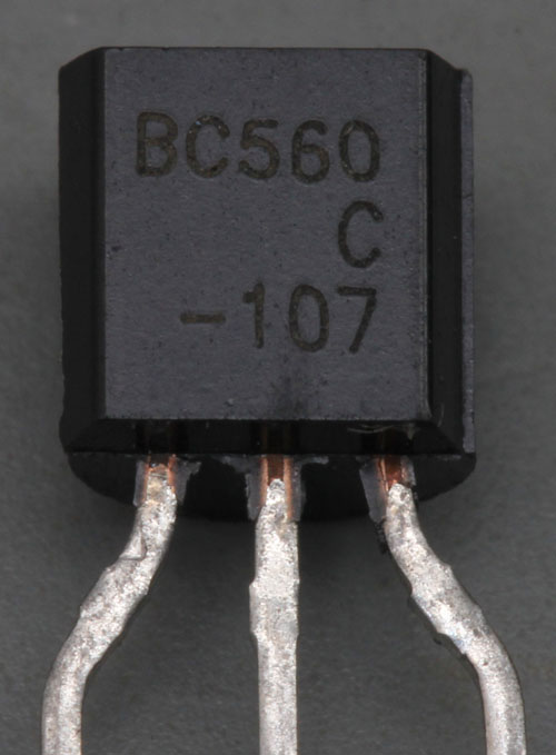

Fairchild BC560C
0,33mm edge length, same as the BC550C. The structures are the same too.

You can bolt it on a heatspreader with an additional plate.
It looks quite similar to the KT808AM we had last time (https://www.richis-lab.de/Bipolar67.htm).
A nice clean die.
On the lower edge the silicon is splintered.
A alignment aid?
You can distinguish the emitter and the base area. The distances between the electrodes and the pn-junction varies quite a lot.
And now base emitter breakdown (starting at -7,5V):
20mA
100mA
200mA
1A
