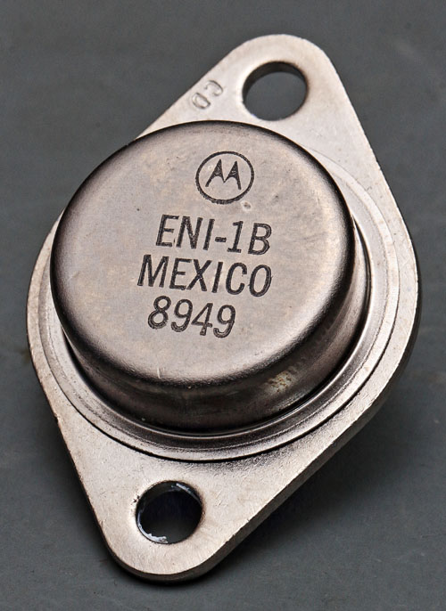

The Motorola ENI-1B seems to be a special transistor for the RF amp manufacturer ENI. It was found in a plasma generator but I can´t tell you more.  :-//
Perhaps Motorola did some binning. Perhaps they just gave it a new name.  :-//
A nice big transistor with a big heatspreader and a big die.
And a nice bondwire!  :-+ 8)

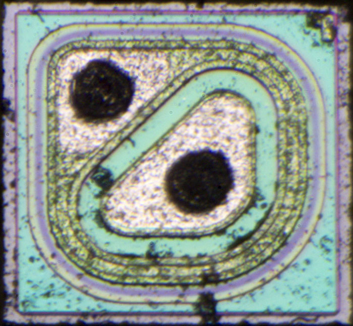

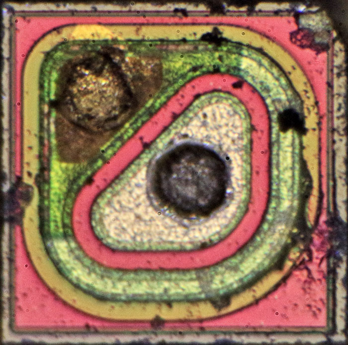

I have added two transistors built by CDIL (Continental Device India Ltd.):
CDIL BC550C
With an edge length of 0,31mm the CDIL BC550C is a little bigger than the Philips BC550C (0,26mm x 0,27mm).
Yes, it´s a small transistor.  ;D
https://www.richis-lab.de/Bipolar39.htm
CDIL BC560C
Although pnp transistors have often worse specifications than npn transistors the CDIL BC560C has the same edge length as the CDIL BC550C.
Yes, also a small transistor.  ;D
https://www.richis-lab.de/Bipolar52.htm

« Reply #381 on: April 21, 2021, 01:19:12 pm »
Yeah, I wonder about that, according to datasheets, their collector-base capacitances are identical. Their die geometries seem to be the same or very similar. Perhaps, they tried to make matching devices? If so, they succeeded. Or, may be, N-devices are only smaller when it comes to fets?
Offline NoopyTopic starter
  • Posts: 1881
    • Richis-Lab
« Reply #382 on: April 21, 2021, 04:15:19 pm »
Philips BC550 and BC560 were different in size...  :-/O
Edit: It looks like the BC560 has a smaller "base contact frame" and so more active area than the BC550.

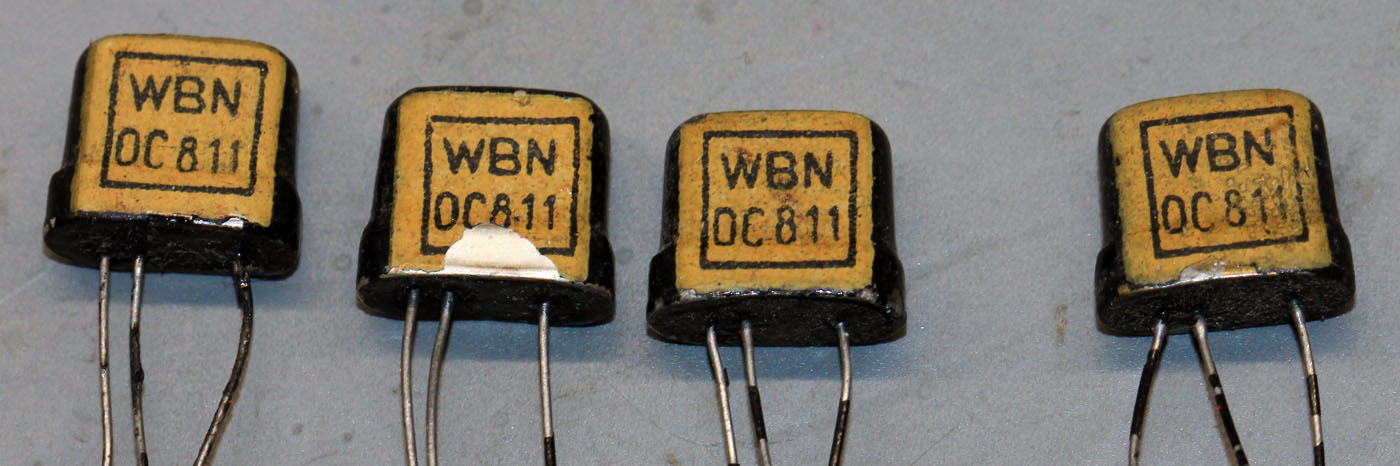

OC811, the first junction transistor built in the GDR.
20V / 15mA
The usual construction...
In some of the OC811 it seems like they had problems with the production quality.  :o
https://www.richis-lab.de/Bipolar53.htm

Ah, hand soldering, good ol' days :). In the USSR we had a rumor that only women were hired to do the final assembly (i.e., attaching bond wires). Also, I was told they were not allowed to open windows in the facility as that would half the yield due to impurities in the air and drafts. Do you know any anecdotes about semiconductor production back in the day?

I have heard of erratic low yields in one of the old american semiconductor companies. Most of the time everything was perfect and sometimes the yield was really low. It took them some time to realise the root cause was a farmer who from time to time sprayed herbicides. His field was located besides the factory. The chemicals made their way through the air supply and killed the devices.  :-BROKE

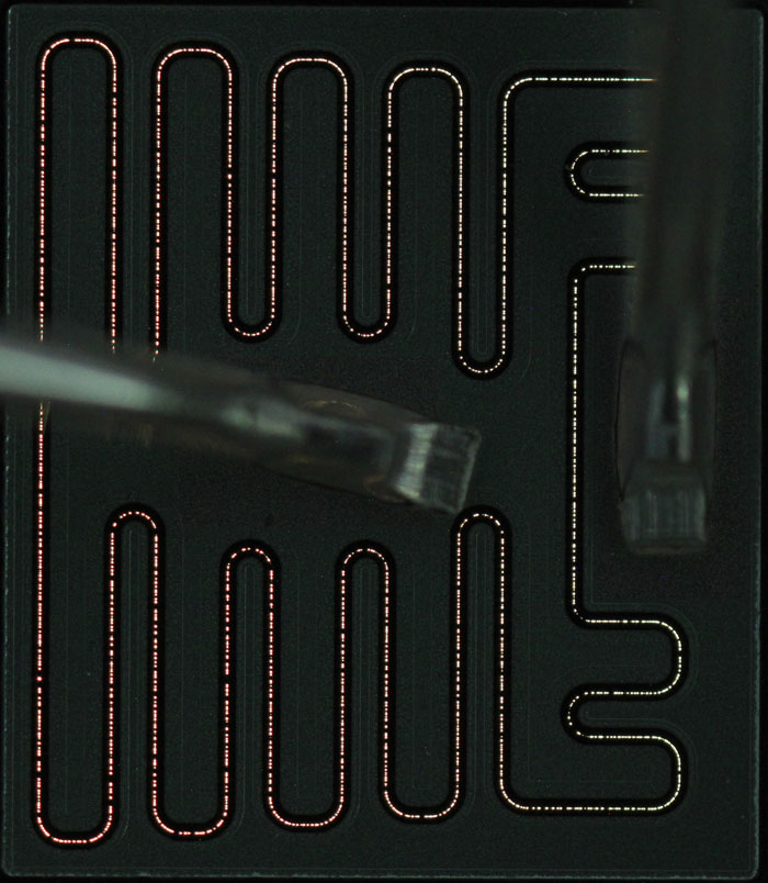

The structure is interesting. The left brown area is the p-doped emitter. The following green are is the n-doped base. In the next pictures we will see that this is the base-emitter-junction.
Before the base contact there is a small brown p-doped layer certainly above the base area. Why that? Looks like a pinch resistor to increase the base resistance. But why would they increase the base resistance? Perhaps the resistance is equalising the electric stress on the transistor area?  :-//
That´s the base emitter junction!  8)
(13,5V / 20mA)
Do you remember the counterfeit BUX66?
If we remove the metal layer we get a better look at the strange structure around the base area. As already described in the n-type base area (cyan) there is a p-type ring (light green) just behind the pn-junction. I still don´t know why.  :-//
https://www.richis-lab.de/Bipolar42.htm

It seems a theoretical possibility that uniformly distributed base resistance reduces formation of current hot spots and improves SOA.
A local increase in current increases voltage loss across Rb and reduces Vbe.
Sounds plausible.  :-+

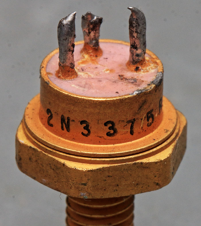

Today we will take a look into a RCA 2N3375.
The 2N3375 is very similar to the 2N3553 (https://www.richis-lab.de/Bipolar22.htm) but can conduct more current and dissipate more heat  (0,5A/1,5A vs. 0,33A/1A and 11,6W vs. 7W).
The pins are embedded in a pink ceramic.
You have to grind carefully because the 2N3375 contains BeO.  :-/O
The pins were soldered to the ceramic which carries the transistor.
Here we have the BeO which isolates the transistor from the package.
The flat makes it easier to align the ceramic.

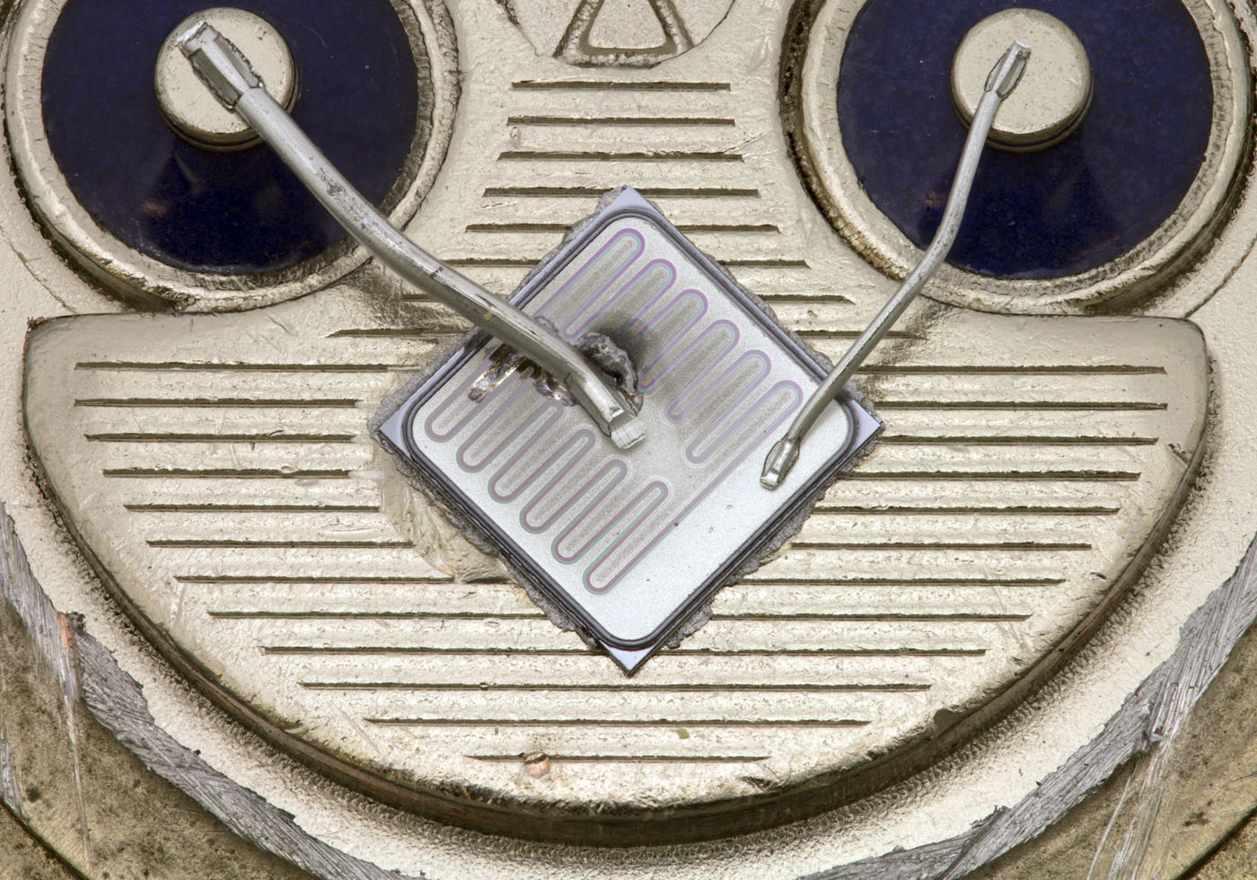

The die is the same as the die in the 2N3553. The higher power capability of the 2N3375 is just caused by the different package.
Here we have only one bondwire but the bondwires are welded to the carrier three times.
Perhaps the 2N3632 (1A/3A, 23W) which is on the same datasheet contains two of these dies. The datasheet states two times the base-collector-capacity...
Gold solder.  8)
More about the multi emitter design can be found here:
https://www.eevblog.com/forum/projects/transistors-die-pictures/msg3286140/#msg3286140
https://www.richis-lab.de/Bipolar56.htm
