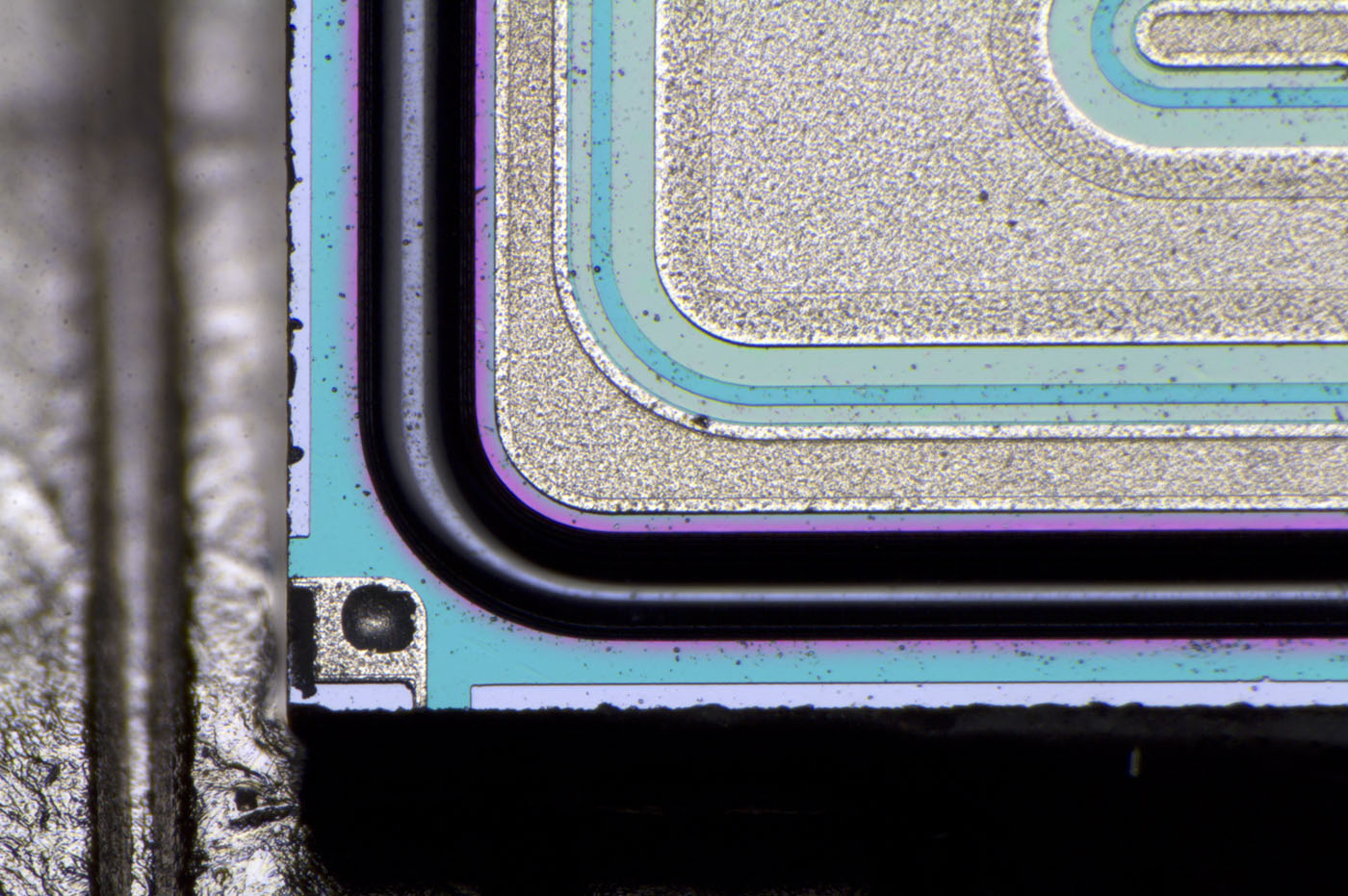

« Reply #328 on: March 01, 2021, 07:08:47 pm »
The BUX66 is a pnp power transistor capable of isolating up to 350V and conducting up to 2A, 5Apeak.
They did quite some binning:
BUX66 150V
BUX66A 250V
BUX66B 300V
BUX66C 350V
This BUX66 built by Motorola seems to be quite new: 2005.
There is some silicone like potting on the die but the amount of potting is quite different in these two transistors.
Some damage due to the depotting...  :'(
The die is 3,6mm x 3,0mm.
It´s a MESA transistor with a nice trench at the edges of the die.
The structure is interesting. The left brown area is the p-doped emitter. The following green are is the n-doped base. In the next pictures we will see that this is the base-emitter-junction.
Before the base contact there is a small brown p-doped layer certainly above the base area. Why that? Looks like a pinch resistor to increase the base resistance. But why would they increase the base resistance? Perhaps the resistance is equalising the electric stress on the transistor area?  :-//
That´s the base emitter junction!  8)
(13,5V / 20mA)
Looks like a very uniform transistor structure.
0,8A  8)
https://www.richis-lab.de/Bipolar42.htm

« Reply #329 on: March 02, 2021, 04:52:39 am »
Today I´m pretty sure that´s a conterfeit part:
- 2005 Motorola was already ON Semiconductor.
- In the "Motorola Semiconductor Master Selection Guide 1994" there is already no TO-66 package left.
- Up to now I found such a white potting just in the conterfeit BUX22 (https://www.richis-lab.de/Bipolar09.htm) and in the Inchange 3DD15D (https://www.richis-lab.de/Bipolar05.htm)
- The strange additional "ring" between base and emitter was also only found in the conterfeit BUX22 and in the Inchange 3DD15D.
 >:D

« Reply #332 on: March 02, 2021, 05:12:17 pm »
This BUX66 definitely looks like a big good transistor.  :-+ Nevertheless it is a conterfeit part... But maybe good to use.  :-//
Testing these transistors would be very interesting but would need a lot more time and equipment.  :-\

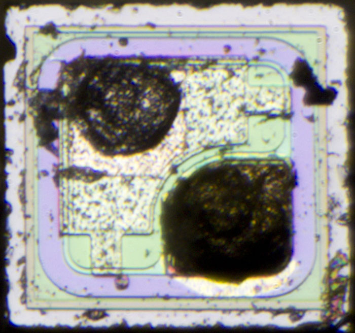

« Reply #336 on: March 11, 2021, 06:20:59 pm »
Today something new: Rohm DTC114, a digital transistor.
The die is 0,35mm x 0,35mm.
Well that´s quite clear.  :-+
Interesting point: The resistors have a different color. They probably used a special material to get the high resistance in this small area.
https://www.richis-lab.de/Bipolar45.htm

« Reply #337 on: March 11, 2021, 10:43:54 pm »
Y'know, I don't think I ever tested one of those for Vbc.  I suppose the resistors are on top of oxide, not diffused into the collector, so that wouldn't matter.  I wonder if amorphous or poly-Si, or metal or what?

« Reply #338 on: March 12, 2021, 04:17:20 am »
I had the same opinion. Probably it´s some lower doped polysilicon. I assume the resistance of metal would be to low.
One would need to curve trace Vbc vs. Ibc to see the resistor... ...or not...  :-/O

Well the power transistor is a big MOSFET.  ;D
In the corners there are free squares. That looks like electrical field steering but I don´t think that is what these structures are for.
