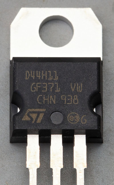

I have taken a look into different *44H*-transistors.
D44H11
Decapping was a bit hot...  ::)

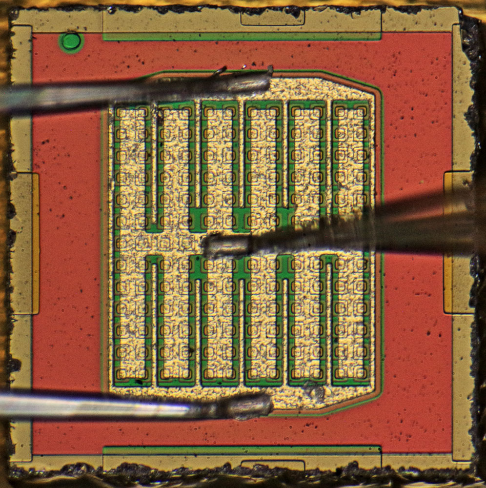

D44H8
It seems the D44H8 (specified for lower voltages) is the same as the D44H11. Perhaps ST does some binning and the higher quality is specified for higher voltages...

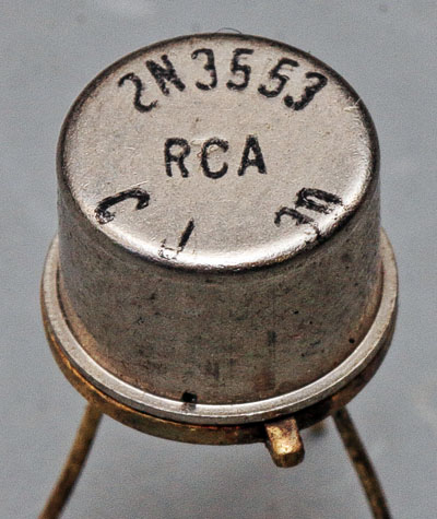

Do you know the 2N3553?
RCA first sold this Power-HF-Transistor in 1966.
The 2N3553 combines a ft of 500MHz with a continous collector current of 0,33A (1A peak, 40V).
Two bondwires for the emitter and two bondwires for the base. Probably that´s for low inductance and good current distribution.
The 2N3553 uses a multi emitter structure for low base resistance and fast switching.
RCA had this design patented: US3434019A

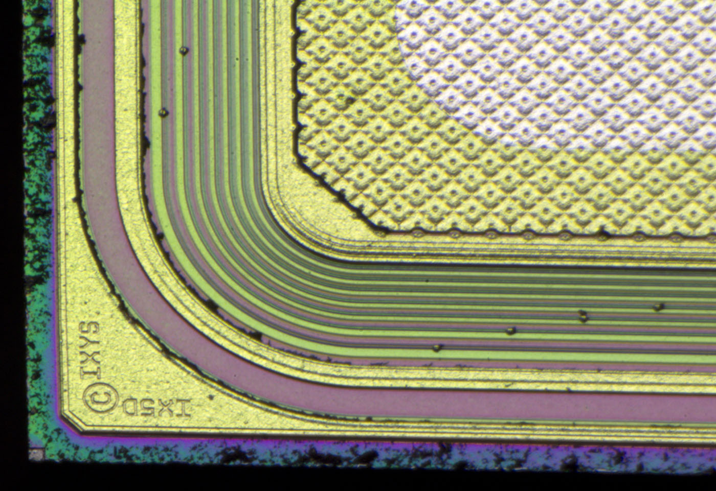

Today I have a IGBT for you: IXYS IXGH48N60C3D1
Different packages but same internal construction / dies.
On the left we see the IGBT. On the right we see the freewheeling diode.
The IGBT is 7,2mm x 6,1mm
Potential steering to manage the high voltage.
In the gap between the two metal areas you can spot the traces conducting the gate current under the emitter area.
