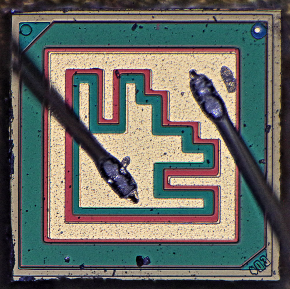

« Reply #204 on: September 10, 2020, 08:15:31 pm »
Today I have a 2N1613 for you:
https://www.richis-lab.de/Bipolar20.htm
The 2N1613 is the first planar transistor worldwide and it´s still produced today.  :clap:
This 2N1613 was built by Telefunken.
A small die (0,7mm x 0,7mm), nothing special...
 :-/O
Now you can find me on patreon: https://www.patreon.com/richis_lab
Do you like my pictures?  ;)
The following users thanked this post: RoGeorge, serg-el
Offline RoGeorge
  • Posts: 6675
« Reply #205 on: September 11, 2020, 07:06:13 am »
Is all the yellow inside a gold plating?  It might justify outside, so the terminals won't oxidize, but why would gold plating be used inside the transistor's case?
Offline NoopyTopic starter
  • Posts: 1881
    • Richis-Lab
« Reply #206 on: September 11, 2020, 07:22:13 am »
I assume that´s all gold plating.
I further assume that they used gold platingt to assure a good bonding even if the package is stored open some time before attaching the die and closing the package.
Offline T3sl4co1l
  • Posts: 22324
    • Seven Transistor Labs
« Reply #207 on: September 11, 2020, 04:29:28 pm »
Might be a combination of bonding and contamination.  If it's bare metal, it's likely to spatter when spot-welded together.  Gold, copper, silver and alloys would be fine as a filler, spot-brazing it as it were.  Maybe just convenience as to putting it everywhere?
If the layer is very thin (as gold tends to be these days), it might not be enough to act as a filler; it might diffuse into the base metal, leaving little or no advantage for bonding purposes.  (It might simply be that a clean and smooth enough interface, with a well controlled welding process, doesn't spatter.  I'm sure this is relevant to later production; I have more than a few TO-39s that are full tin plated, so either would've been bonded like that, or bare and plated afterwards.  Hmm, and at that, most of them are smooth but a few Philips 2N4033 are starting to whisker..!)  If it was a heavier layer of gold, it could serve this way though.
It's interesting that only the base seems to be gold plated, which doesn't really go along great with either theory. :-DD
