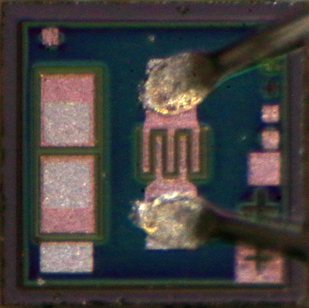

Offline NoopyTopic starter
  • Posts: 1851
    • Richis-Lab
« Reply #166 on: August 07, 2020, 08:24:39 pm »
With "Perhaps I should try it again..." I wanted to say "I have to do that instantly!"  ;D
I took the 2N2857 with a maximum collector-base-voltage of 30V:
https://www.richis-lab.de/Bipolar16.htm
Beginning at 57V(!) the current through the collector-base-junction reaches 10µA.
=> 50µA
You can see a small glow in the upper right corner of the base rectangle.
=> 100µA
The lower right corner starts to glow a little.
=> 250µA
Now we see the corners!  :-+
=> 500µA
The left corners start to glow.
=> 1mA
The electrical field is highest in the corners of the rectangle and so the corners are illuminated first.
=> 2mA
=> 3mA
Then the right edge is lightening up.
=> 5mA / 75V
I can´t go any higher. Probably with more power loss (>375mW) the 2N2857 would die anyhow.
It seems the area under the emitter contact is dark. The emitter isn´t connected but perhaps/probably the emitter contact somehow affects the electrical field.  :-//

The emitter most definitely affects things -- C-E has a lower breakdown than C-B, effectively the C-B leakage is multiplied by hFE so runs away at a lower voltage (Vceo vs. Vcbo).  In the transition region between these two extremes, breakdown depends on e.g. B-E resistance; and breakdown can become exceptionally noisy, so much so that it can effectively switch "on" in a fraction of a nanosecond!
(I've observed avalanche switching in every transistor I've tested; the width of the region (in terms of what range of R_BE works reliably) varies, with most epitaxial parts being poor.  2N2369 is the classic, but 2N3904 also seems to do well.  Power transistors don't handle any more current before burning out, perhaps because avalanche only occurs in a small part of the whole junction, and isn't able to propagate over the full width.)
If the glow persists in Vceo or Vces mode, I wonder if it has any physical significance -- sufficient light output could perhaps cause the junction to ionize much sooner, and more broadly, than it would due to carrier diffusion alone!
I just did a short test of Vceo.
At ~45V over emitter-collector and ~10mA you can´t see any light.
I would have guessed to see at least some glowing...  :-//
Perhaps the breakdown ist more chaotic and distributed over the whole die... That would be a good explanation for  more noise... Just speculating...
Have to try Vces but no time left right now.
I assume the collector-base-junction will glow in that case but since a lot of current is flowing to the emitter I won´t be able to raise the current high enough to make the glowing visible before the transistor dies.
