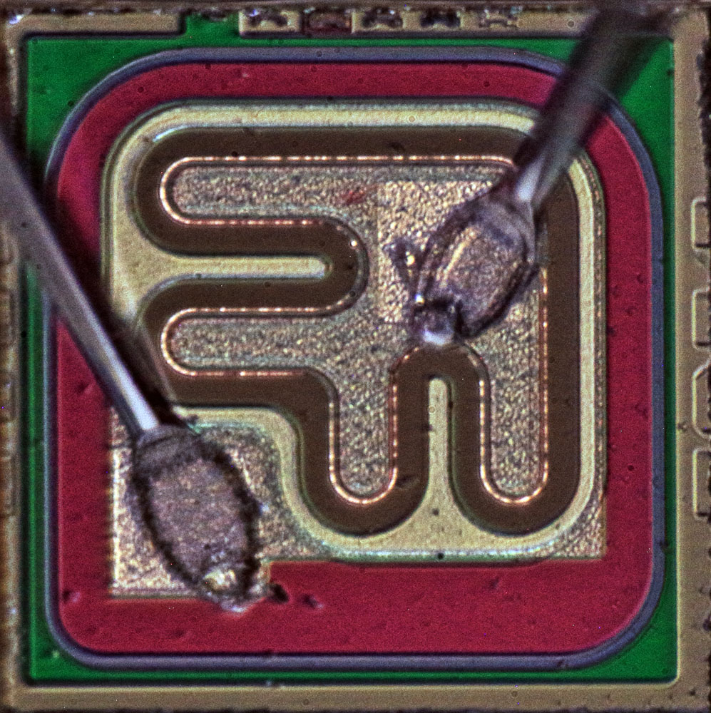

And I just have to show you this one:
You see the breakdown of the KD501-base-emitter-junction with increasing current.  8) ;D
Does anybody know why Tesla integrated this step at the edge of the die?

The BE breakdown video is great ?
I'm working on a PHD where this effect plays a role. May I use your video in my thesis ?
Just speculating, is this a MESA part ?

Thanks!
Of course you can use it in your PHD.
If you need something special (higher resolution, different angle,...) just tell me.
Sounds reasonable!  :-+
Looks exactly as on book drawings
