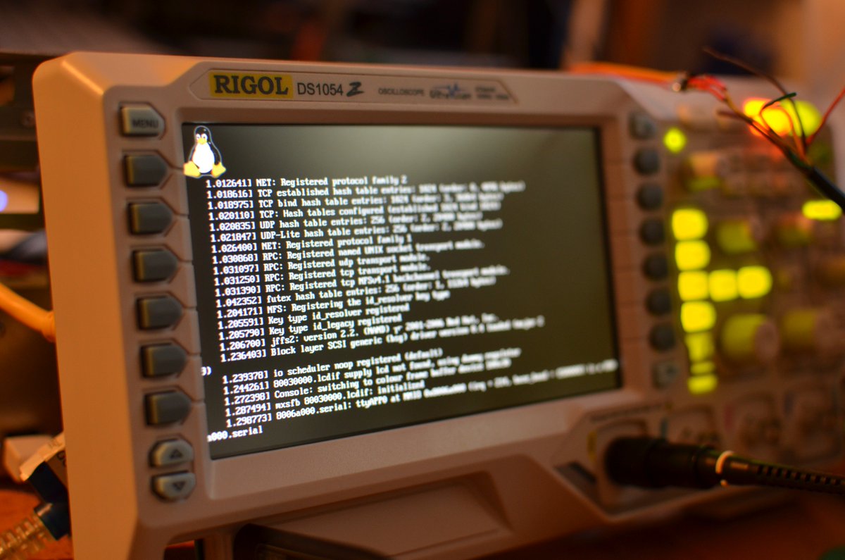

What I have today![](https://pbs.twimg.com/media/C3q_XQlWMAECEmq.jpg)
I can boot Linux, which means we have:
- USB
- LCD/Framebuffer
- Ethernet
- Frontpanel LEDs
- Frontpanel buttons
u-boot is here:
https://github.com/tmbinc/rigol-ubootI load u-boot via JTAG/OpenOCD and then boot from USB-storage, I haven't yet looked into writing u-boot to flash. I'm not saying that Linux is the ideal choice, but it's a good test vehicle to validate that the hardware works.
There's a lot of things to figure out - including the whole "scope" part, the FPGA pinout, the FPGA<>iMX communication.
