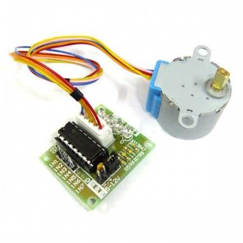

Got it. Here is the assambled vacuum motor v1.
Watch the motor in action;
*Yes it sucks
*No vibration, seems stable in full power
*Too much noise
Definitely it needs proper testing, optimisation & upgrades. So I ll stop working on the vacuum motor at this point now, and as I mentioned in the previous post, now its better to pivot the effords towards LARA M0 with no cleaning functions but the electronics hardware inside, to be created as an algorithm development platform.
I couldn't decide on what the description of it should be.;
*LARA M0: The vacuum robot that does not suck
*LARA M0: Non-Vacuumer Vacuum Robot
*LARA M0: DVRAADP (Dummy Vacuum Robot As A Development Platform)
Do they all suck and/or do you have a better suggestion??

Can anyone suggest a proper cliff sensor for the LARA M0?
An example image;

A cliff sensor would be any downwad looking proximity sensor which is able to operate mostly independently of floor surface finish. Time of flight IR may be overly precise, long ranegd and costly for this use, a reflection sensing (measuring level of returned IR light) could work but might be overly affected by black vs shiny surfaces. A SHARP type IR which internally focuses a returned spot to a different place on an array and uses thisposition to utput a voltage indicating range might be the best choice, you'll want a ring of them positioned in multiple places both to compare readings across all and avoid reversing over cliffs.
Cheapr versions (because if I were building this I'd want a whole ring of them) of this sort of thing:
https://uk.farnell.com/sharp/gp2y0a41sk0f/sensor-distance-analogue-output/dp/1618431
