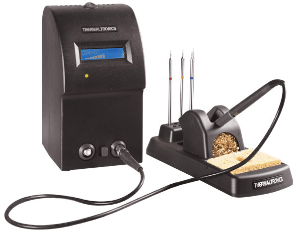

Offline AndersAnd
  • Posts: 572
Re: DIY Metcal 13.56 MHz RF Supply
« Reply #254 on: October 11, 2013, 05:35:14 pm »
while working on some magic-8-ball type of addition to the code (hey, i try to predict the actual tip....), i noticed some quite dramatic differencies between original Metcal cartridges and their Thermaltronics equivalnt. While i have only 3 types of equivalent Thermaltronic tips, the trend is quite visible!...
Hi mamalala and everyone else,
This is a great DIY-project which I have been following for a long time. :-+ I just haven't signed up until today.
I'm a great fan of the Metcal soldering system after having tested several high end systems at work before we decided to buy Metcal MX500 soldering stations for everyone to replace outdated Weller stations. Everyone agreed MX500 was by far the best system tested compared to Pace, Weller and a few other brands I can't recall. Only problem after some time was that a lot of Metcal tips died prematurely, so they couldn't heat up at all. This is however a big issue since the Metcal tips are quite expensive, but we did get all the dead tips replaced under warranty by our distributor. Not sure if Metcal has since fixed this issue, as I don't work there anymore and it was about 15 years ago.
Anyway enough about that, the reason for this post was I wanted to inform you guys that Thermaltronics is also sold rebranded as EasyBraid:
http://www.easybraidco.com/hand-soldering-c-3-l-en.html
http://www.thermaltronics.com/products.php
As you can see the EasyBraid rebranded soldering stations are still named 9000S, 5000S and 2000S series respectively, just like their Thermaltronics equivalents.
I found out about the rebranded Easy Braid systems while browsing the DigiKey website. DigiKey sell both Metcal and EasyBraid but not Thermaltronics.
EasyBraid at DigiKey: http://www.digikey.com/suppliers/us/easy-braid.page (you might have to disbale AdBlockers at DigiKey.com for this page to show up)
EasyBraid is also sold at Amazon.com: http://www.amazon.com/s/ref=sr_st?lo=tools&keywords=EasyBraid&rh=n%3A228013%2Ck%3AEasyBraid&sort=-price
And at eBay
From USA (by http://gokimco.com): http://stores.ebay.com/Kimco-Distributing/?nkw=Easy%20Braid
From Germany: http://stores.ebay.com/ukpartsdeal/Sound-Vision-/?_nkw=EasyBraid
Thermaltronics doesn't seem to have a lot of resellers (yet?), so it's nice there's other sources like Amazon and a huge distributor like DigiKey for (rebranded) Thermaltronics tips, hand pieces etc.
EasyBraid Tips <-> Metcal Tips Cross References: http://www.easybraidco.com/cross-references.php?competitor=4
Thermaltronics Tips <-> Metcal Tips Cross References: http://www.thermaltronics.com/references.php
EasyBraid EB9000S
Exact same picture as the below except for the brand sticker, looks like they have just photoshopped another name on:
Thermaltronics TMT-9000S
Newer picture, looks like they have changed the design of the handpiece holder:
« Last Edit: October 12, 2013, 06:07:52 am by AndersAnd »
