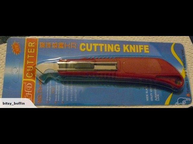

I've also tried scoring with a blade and breaking, which didn't work much better.
I think that scoring and breaking is your best option for a clean cut, but you REALLY have to score fibre based boards DEEP, and you must do it on both sides.  I bought some "hook knives" from China, this is the knife that the taobao vendors etc use to cut up blanks, and it does work pretty well (when I can find it, when I can't I just resort to a normal craft knife, but takes more scoring passes).
Start the score with the tip, then switch to the hook and rip it down.  Clamp the pcb with a ruler along the score line.  Also works good for acrylic sheets.

« Reply #6 on: February 24, 2014, 09:38:50 am »
It's really keeping the photoresist intact that I'm trying to get at.  Scoring and snapping PCB material works fine, but it does tear the resist very easily.
I use Kinsten boards exclusively and have to say I get good result just scoring the board with a Stanley knife and a new blade. I cut from the copper side without removing the plastic protective sheet and run it through multiple times so you are not having to snap to much fr4. Holding the board over a nice sharp edge and pushing down on the board with a steel rule right on that edge makes it that little bit easier.
A flat 2nd cut file then makes short work of the remaining ruff edges
Some things don't always work out perfect the first time you try them but repeated attempts help you get "the knack"
Ok you're right, it does work fine.  I mustn't have had a sharp enough blade or something last time I tried it.
This time I use a new blade, then on the start of each new cut I touched up the blade with a diamond file so it was sharp as new.  Just broke down a 300x150 into 100x75mm without any tearing.
Thanks for showing me the error of my ways...  :-+
