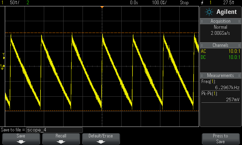

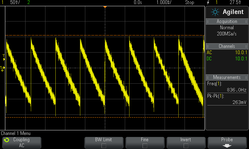

Offline amyk
  • Posts: 8334
Re: Batteroo testing
« Reply #91 on: December 22, 2016, 12:20:43 am »
The efficiency is pretty bad, but so is the line regulation; I wonder if the latter is deliberate, and they were thinking all along about battery gauges?
It looks like a variable-frequency converter. The ripple is not surprising given it basically has no output filtering.
Offline Fungus
  • Posts: 16883
« Reply #92 on: December 22, 2016, 12:20:43 am »
Wow! That's switching at a really low frequency. Efficiency and ripple will be a total disaster at <10kHz with such a tiny inductor. It should really be working in the MHz range(!)
( I'm off on holiday in a few hours. Looks like I'm going to miss all the fun.  >:( )
« Last Edit: December 22, 2016, 12:25:04 am by Fungus »

Offline amspire
  • Posts: 3802
« Reply #96 on: December 22, 2016, 02:33:25 am »
To get decent efficiency over a wide range, you have to set a minimum pulse width - say 5% - and then below about 5% load, the frequency is varied. So you can get kHz switching frequencies - and big ripple at low currents. Double the current and the ripple will probably halve.

Offline EEVblog
  • Posts: 38055
« Reply #97 on: December 22, 2016, 04:42:50 am »
I'm pretty sure Batteroo said it was 1.5MHz somewhere?
Offline EEVblog
  • Posts: 38055
« Reply #98 on: December 22, 2016, 04:44:42 am »
They are probably relying heavily on capacitors at the battery input in the 'DUT' for filtering, but there could be anything from nothing to hundreds of uF and no clue to what quality caps they are either.
You mean those same capacitors in the product that help prevent the pulse current from causing the dropout voltage problem that Batteroo are so proudly sprout as the key to why their product will be so useful?  :-DD
Offline amspire
  • Posts: 3802
« Reply #99 on: December 22, 2016, 05:17:30 am »
We can work out the output capacitor value from Frank's waveforms. With 100 ohm load, the output current is 15mA. The voltage drops about 200mV in about 150uS.
So C = 150uS x 15mA / 200mV = 11uF. So they will be using a 10uF multilayer ceramic capacitor. Probably what you would expect given the space.
