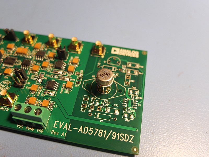

Christmas presents  ;) !
Cheers
Alex
Offline Galaxyrise
  • Posts: 531
Re: Ultra Precision Reference LTZ1000
« Reply #1201 on: December 25, 2015, 04:25:12 am »
I have build my 4x LTZ1000 with focus on minimal long term drift. Based on recommendation from Bob Dobkin R2/R3 is 100k, die temperature to 45°C (12k/1k). For zener current change from 5mA to 7,2 mA I have no opinion.
Hi Andreas, reducing the zener current sensing resistor from 120 to 100 Ohm would increase the current from 5 to 6mA. It is just I have already some 100 ohm Bulk Foil resistors, that is all. Also I use "non-A" version so the additional 7.5mW dissipation should not be a problem. If required I'll just increase the temperature a bit. I may use a metal can LM35 to accurately measure the case temperature of the LTZ1000.
Curious where these current numbers are coming from. I thought the datasheet values result in ~4mA, not 5.  Even taking into account the Vbe rise from reduced temperature, I'd still think 100R is around 5ma.  (This is consistent with measurements I have made of my own LTZ1000, too.)
Remember that the datasheet lists +-10C temperature variation! So 12k:1k isn't reliably 45C (unless you've measured your own unit to be sure, of course.)
Measuring the temperature coefficients of mine is something I did this holiday, and I had a bit of trouble with it.  (I need a proper climate-controlled box...) I got -2.57mV/C for Q1, -2.1mV/C for Q2, 5.5C self heating (4mA zener current, non-A version, not quite in free air) and 55ppm/C for the reference voltage.  Is that consistent with other people's measurements? My gut is that I got the TC of Q1 off by about 10%.  I was using Pin4 as the die thermometer, so if the other numbers seem off by 10% it would be confirmation of my suspicion.
I am but an egg
Offline plesa
  • Posts: 965
« Reply #1202 on: December 25, 2015, 09:35:16 am »
Cheers
Alex
Santa has pretty recent LTZ1000:) What resistor you are going to use?
I measured 4x LTZ1000 and difference between them was 2K, of course you needs to measure Vbe. All are in region 42-44°C with 12k/1k.
I did not measure self heating but I'm curious to measure it, maybe I will buy another LTZ1000 to measure self heating for 4mA to 16mA zener current.
« Last Edit: December 25, 2015, 09:59:55 am by plesa »
Offline Alex Nikitin
  • Posts: 1291
  • Femtoampnut and Tapehead.
    • A.N.T. Audio
« Reply #1203 on: December 25, 2015, 10:59:08 am »
 Digikey Santa was very quick, I've ordered the chip on 22nd and received it on 24th! I've found some 110 Ohm W/W Ultrohm, may use that, or 100 Ohm Bulk Foil.
Cheers
Alex
« Last Edit: December 25, 2015, 11:01:42 am by Alex Nikitin »

and now the money shot:
around $80 per square inch component cost within the "inner circle".
LTZ1000A is now on board.
So ready for further tests.
With best regards
Andreas
