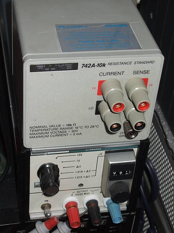

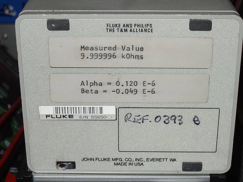

Not to push the Calibration Club thread further off-topic, here I would share some data on my new toy - the Fluke 742A-10K Resistance Standard. I also will copy the photos here.
It appears that the HP3458A resistance measurements have considerably larger temperature coefficient and/or drift without ACAL that the Fluke. I've run overnight test (OHMF, NPLC100, OCOMP ON, DELAY 1) and in the morning the HP3458A did show about +2ppm from the value yesterday afternoon. The temperature variation in the lab was not much and the internal temperature of the meter did change by about 1.2 degree C. Yesterday at 2pm, after ACAL ALL with the internal temperature 38.4C and the resistor temperature 24.9C the measured value was 10.000058K . This morning at 8:40am the measured value was 10.000078K (+2ppm), internal temperature was 37.2C and resistor temperature was 23.0C. After ACAL ALL the HP3458A measured 10.000060 (internal temperature 37.3C, resistor temperature 23.0C).
At least it looks like just after ACAL the measurement values are consistent. I will repeat the measurements at some intervals (possibly weekly or bi-weekly) to see the measured value changes in time .
I also measured the 742A with the Keysight 34465A meter, the measured value just after ACAL was 10.00007K (NPLC100, OCOMP ON)
Cheers
Alex

... and the resistor temperature 24.9C
It looks like you got a stable Fluke resistor.
How did you measure the temperature of the resistor?
Will you open it up and show us the inside?

I've measured the temperature with a thermocouple attached to the resistor's side.
And I won't open it. There are photos of the internal construction of this Fluke already available here on the forum and as I plan to use it and have no particular reason to open it, I'll pass.
Cheers
Alex

Alex,
I purchased a used 742A that was missing the alpha/beta coefficients. I emailed Fluke and their response was that they only keep records for 5 years. Whether or not that was true, I never got the data. I hope you have better luck.

Alex,
At least it is possible to measure these coefficients if you have a bridge or a meter with a sub-ppm resolution and short term stability, and a temperature chamber. According to the manual for 742 the measurement is done at 18C, 23C and 28C and the coefficients are calculated from the measured values. I may try to verify the coefficients for my 742A-10K after I'll get it back from calibration, however it might be not that easy  ::).
I've run HP3458A + 742A-10K overnight and it appears that the meter has a much larger tempco than the resistor. The change was about +5ppm for about -5C change in the ambient temperature and a fresh ACAL ALL in the morning only changed the measured value by -1.5ppm. The internal temperature of the meter dropped from 38.8C to 34C overnight. If we believe the Alpha and Beta printed on the resistor the value change from 27C to 22C should be only +0.15ppm . So this HP3458A has about -0.7ppm/C tempco on the reference resistor after ACAL. I need a temperature stabilized chamber for the meter (or for a bridge)  :palm: .
Cheers
Alex

Here is the graph for the 25C-29C measurement of the 742A-10K.
Cheers
Alex
P.S. I've added a graph with calculated from Alpha and Beta coefficients Resistance values v Temperature in 18C-30C range.
