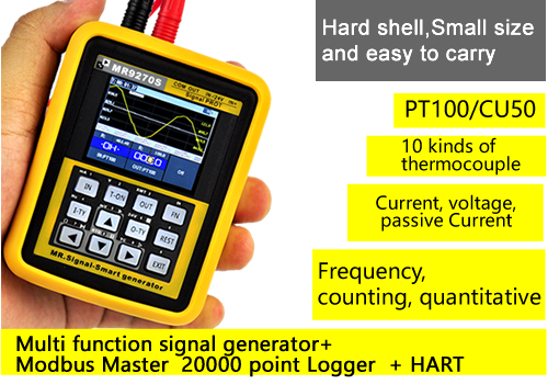

I am a retired Avionics Tech and now a "hobbyist" currently converting my machine and welding shop to CNC. I also work with various experiments that require lots of monitoring and measurement. I also use thermocouples a lot. I just ran into one small project that brought into question the accuracy of one of my meters. I have a Fluke 16 Multimeter which has been my standard. But projects keep getting more complex and interesting and I do not want to be designing on top of research that has a bad measurement.
I have a set of gage blocks for a standard in my machine shop, It seems about time to get something for my electronics workbench.
These Mr. Signal multipurpose Calibrators caught my interest.
I am not expecting NIST precision and accuracy, just something to keep me accurate enough from creating problems from a bad meter or thermocouple.
The top of the line model has Modbus, something of which I know nothing about but I expect to run into it eventually with some of the projects I am taking on. These seem to be geared for industrial instrumentation which is the direction I am headed.
The cheaper versions would suit my needs fine. Prices are from about $90 to $170 USD shipped from China.
http://www.lanyigs.com/en/
Does anyone have any thoughts or experience with these?

Friend of mine was playing with one of these, I'll ask for feedback.
Perhaps good idea for you would be also getting some used bench  DMM, such as HP/Agilent 34401A or Keithley 2000 from ebay. You can snag working used  one for 250-350$ no problems. Get it calibrated (plenty of places can do it for 50-150$) and you will cover 99.9% of needs for usual tinkering and electronics design.

I'm afraid for commercial product, especially if traceability is needed these little Mr.Signals, nor Fluke 16/Rigol stuff would not be suffice. Most of calibration labs would not want to guarantee traceable calibration for such tier gear as well. Even if lab accepts Mr.Signal for calibration with data, cost of such would be more than 100$. (which is a must to establish stability/predictability, one calibration does nothing but useless pretty numbers). So after few calibrations, you would already invest comparable money than actual traceable instrument, such as old Fluke DC standard/standard resistor or calibrator.
It's not the end of the world though, as there are some old "vintage" but still capable equipment on used market, such as Fluke 731's, old Fluke 5440 calibrators, etc, if you patient to wait for good deal and ready to deal with heavy items shipping/pickup.
Here are photos of insides from my friend:

I decided to work this into my budget.
I built a battery pack for my Rigol DS1054Z and the only meter I had handy was an analog with a 10 Amp scale. My reading was 225mA which did not add up after watching the battery capacity on the charger. The actual reading was between 470 to 500mA which made more sense.
While not NIST traceable, I hope to trust the spec sheet for this. The specs are all an order of magnitude more than I need and should keep me from wasting time from bad readings.
I think this is a better investment for my lab than a $100 signal generator since I am not doing any Audio or RF work.

Reading about this device I would give you a mechanical analogy that seems appropriate to me.  This instrument is like buying standard size drill rod and using it as a reference.  Think of that relative to the fact that you have a set of gauge blocks.  But also spend time thinking about the precision you will need in your electrical endeavors.  You probably trust your gauge blocks to less than 0.001 inch, (I'm still Imperial for this sort of thing).  Or roughly one part in one thousand.  This is somewhat better than most of your hand held meters will claim in accuracy.  Which is more than good enough for most purposes.
Do you need one part in a thousand accuracy in your reference?  Probably not for your stated purposes, though most volt nuts would sneer at such a low level of precision.
