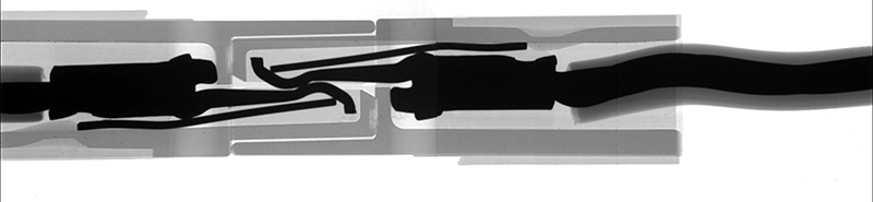

Thanks for explaining the benefits of the PIDG terminals. Do they really need the special crimp tool from TE, or can they be crimped using generic tools meant for insulated terminals?
Ehhhhh the "correct" answer is always the tool and the terminal must be matched. In my experience the PIDG are ok with normal tools, but TE's ultra-fast faston terminal line just doesn't work at all so don't accidentally buy those (they have a flat edge on one side so it doesn't work with generic tooling).
When I pulled them both to failure, the Pressmaster failed at the strain relief while the AMP failed somewhere in the main crimp (does that mean with vibration and age the Pressmaster will fail earlier, who knows). I can't remember the numbers off the top of my head but both of them were way over the mil-spec tensile strength, it was really uncomfortable pulling ~35kgf on 16 AWG wire, and the strength is basically the same as the wire only without any crimps.
Pictures are a PIDG red terminal 320559, looks pink in my photos. I managed to buy a couple hundred terminals cheap on eBay so I'll have to do a bit more experimenting for science...I just hate "wasting" them ahahah.

I’m still kinda surprised, and still suspect they were not crimped correctly.
I agree that if crimped correctly, it should be solid. Most likely the best way to crimp in this case would be a crimp in the middle of the terminal cup so the end of the wire is flared and can't pull out beyond the crimped metal. Those Anderson connectors were quite tight though. It took quite a bit to disconnect them, so add several feet of wire, someone yanking on the wire with an instantaneous force, etc...  and they'd pop out.
Technically speaking though, over time, doesn't the wire/connector develop corrosion, and, as the wire wiggles (say due to many removals), the connection becomes intermittent?
Over the years I've seen various connector type failures. One was gold pins on a connector that when soldered on the PCB developed (per the term used at the company) gold embrittlement in the solder. This (and maybe a combination) of the female connector having non-gold contacts caused the voltage to vary. This varying voltage caused alarms in the unit because it would sag beyond the firmware alarm trip point.
For the most part though, any connector that has properly crimped pins should last, so I don't disagree. I just see crimped pins and the first thing I think of: this is another failure point and I can eliminate it by soldering the crimps.

One should not be guessing at how it should be crimped: if you want a reliable crimp, you do what the manufacturer says.
Anderson PowerPole (most likely the ones in question) normally use a closed-barrel crimp terminal, and Anderson is crystal clear on how to crimp it: using their tool, with the indents centered along the crimp barrel. (They also list soldering as a non-preferred alternative to crimping. But not both.) And they have pull test specifications.
Are you saying that the retention force of the contact was enough to let a firm yank pull the wire out of the crimp? As in, the contact retention force was higher than the pull-out strength of the crimp? If so, then that means the crimp was nowhere close to properly done. That’s not just not in the ballpark, it’s not even the right city!
Huh? Are you talking about the mating surfaces of the contacts, or about the crimped contact-to-wire interface?
Corrosion of the mating surfaces depends on the application, contact plating, environment, and contact design.
A proper crimp is gastight, so there is absolutely no movement of the wire relative to the contact. If the wire is wiggling within the crimp, then it’s not just not in the ballpark of crimp force, it’s not even in the right country!
A crimp connector that is properly selected for the application, with correct wire and tooling selected, assembled to manufacturer specs, should not become intermittent.
Corrosion within the crimp itself means it wasn’t gastight, which also means crimp force was too low.

The proper tooling, used according to the instructions, makes it quite hard to mess up a crimp. The things you describe (inconsistency, pins that easily break) sound like you didn’t have the right tooling at all.
One way to reduce birdcaging is to use sharp cable shears to cut wire instead of diagonal cutters or anything dull. Diagonal cutters tend to disturb the stranding far more than shears. Since switching to shears, I’ve found it much easier to crimp without wayward strands.

And if you absolutely have none of those alternatives available, I'd sooner solder (only) to the crimp terminal than to crimp to solder-tinned wire.
In theory this might be feasible but you'd have to dip the entire terminal in the solder along with the crimp, which might cause other problems. Might be ok for basic ring or spade terminals, never tried it.
I've also wondered if soldering the litz wire into a ferrule and crimping to that would be the best compromise. Asked NEW about it and they basically said "interesting, give it a try and let us know how it goes".
Hah. At least for smaller (pin-sized) litz, I've seen shops just dip the loose end in the pot -- tin the wire, then shove it into the board for a second (and final) soldering step.  Avoid fraying the strands (or I suppose wrap them with a fine strand before dipping) and it works out fine.  Needs a relatively large PTH of course, since some fraying is inevitable.  Usually it's done as part of a lead frame operation: like mounting the e.g. transformer on a mounting base (sheet of FR-4 with holes drilled in it), with blobs of gel epoxy to secure wires on it.  Also an alternative to pinned bobbins, just take the wires out and shove them through holes separately.
Ferrules should be fine, give or take if they're nickel plated I guess, heh.  Disappointed NEWT didn't have anything to say about it.  (I forget if we asked them about ferrules back in the day..)
Would imagine the crimp wire-in-board terminal thingys would do well enough too; I don't know that I would trust those to tin through (clearing out the enamel) if using litz with a fairly ordinary wave soldering process, but if you can spend some time "soaking" them, that would still be fine.  (Customized selective solder, perhaps? Run the wave slower, if everything else is fine with it?)  Pre-tinning of course does nothing, as you'd glom up the snap-in clip parts and not be able to assemble them in the board, or at least any better than as ferrules.
At PPoE, we did industrial (up to sausage-sized) cables by crimping, dribbling in some liquid rosin, then dipping the whole lug, usually with a clean-up step blasting off dross / rough solder with a sanding disc.  Not exactly ideal, but I'm not aware of any that came back to the service department with charred lugs.  (Granted, that might only be a 1/1000s failure rate, hardly exemplary as industrial production is concerned.)
Regarding solder vs. crimp, my understanding is, the crimp has to pinch and stretch -- specifically, not just crush, but to hold in compression, necking down and thus squeezing the strands out lengthwise just a little bit, and the strands spring back against that force, acting to push them back into the crimp, sealing it tight.  It isn't, and doesn't have to be, a cold weld; in fact the strands can move in the crimp, it's not necessarily a problem for the lug and wire to have mismatched thermal expansion for example (but, probably not a good thing if they are very different, lol).
Thus, if we make a very loose crimp (that isn't actually holding tension against the strands), it's better to fill it with solder, because it's not a gas-tight joint, and the solder will make the bond, like a tight-fitting solder pot.  There's nothing wrong with solder pot terminals, in and of themselves.  We have a soldered joint, and all the limitations thereof (creep, fatigue, corrosion).  If you have terminals but no crimper, you can still do them with pliers and a soldering iron in this way -- badly, but you can likely make something that fits wires into a housing, and maybe that's good enough in a pinch.
If we fill a proper crimp with solder, we get the worst of both worlds: the fatigue and creep and corrosion of a soldered joint, without the natural movement (potentially) of the crimp joint; the soldering heat may also relieve some of the stress in the crimp joint, or by melting tin plating (when applicable), change the volume in the crimp, and thus the stress in a more exaggerated manner.
So that's why you don't crimp AND solder.
Then, what about litz?  It's enameled, so there's a three-layer mix in the crimp cross-section: the barrel around the outside, then the matrix of copper and enamel.  This will crimp just fine when cold, but when heated, the enamel breaks down and flows out, relieving stress.  Whether that's bad, depends on how much is relieved: it seems to be enough to fill with solder, but, I mean obviously it's a solder wick, that's not saying a whole lot; possibly it's enough that strands could in fact come loose, but I can't say I've ever extracted strands from a terminal while the solder is molten.  But that might also simply be because the strands are stuffed in there with enough congestion that they can't really pull out
It could also be that not enough stress is relieved by melting the enamel, to loosen it.  We're not talking much strain here (<1%?), but a fair amount of enamel (several percent by diameter?), so I doubt this is the case.  It seems plausible in the tin-plating case though.
But, I think for most applications, they're just not strenuous enough to be a problem: the soldered joint, the vast strand count, and the fact that the cable some inches behind the terminal remains stiff (from the enamel melting together), accounts for most of the strain relief, plus a generous layer of heatshrink does a bit more; and applications may simply be well enough secured, or low vibration, or clean environment, that the stress response (creep/fatigue) and corrosion concerns just don't manifest.  Basically, you aren't usually running litz cables around for general cabling use, they're mostly at the terminals of a component and there's no slack length to couple vibration and handling into heavy flexing.  The situation might be suboptimal in a broader sense, but further optimization may not even be perceptible (in terms of production yield and product quality/reliability).
You definitely don't want to tin AND THEN crimp, as the tinned end will have a substantial fraction of solder inside it, and the whole thing will mush down, getting severely strained and fatigued, while not holding nearly as much springback force as the crimp needs to be sealed against.  The cracked, loose mass may be mechanically pinned (you can't yank it out, maybe even without breaking the wire), but it will be far more susceptible to fatigue and corrosion.  This can be cured (or, probably not completely, but partially perhaps) by remelting the joint after crimping: apply flux, then heat it up; there may be enough excess solder to make a reasonable solder-pot joint, but probably some extra should be added to get a nice fillet.  Plating around the lug ring can be unaffected (or at least, not blobbed up; usually the plating does change on heating, oxidizing or thickening the intermetallic layer), so it bolts down as good as new.

I'd make the opposite argument.  I was a natural at soldering the minute I picked up an iron as a child, but I still have to read the instructions and practice every time I need to crimp something smaller or more delicate than a PowerPoint connector.
Spring tension? I don't think any crimp tool in existence relies on actual spring tension to adjust the crimp force. Springs are used in the mechanism, but as far as I know, the actual force adjustment is some kind of limiter or end stop that you move. The springs are just there to return the tool to the open position and to hold some other parts in place.
I'm talking about PowerPole connectors specifically here, where hidden springs are used to maintain contact between the mated terminals:
Guess why I felt compelled to X-ray that one...
Oh OK, I didn't realize you were talking about the connector itself.
But what does that have to do with crimp vs solder? In PowerPole, both crimped and soldered contacts use the identical housings, so whatever the effects of the spring, they aren't specific to the termination method.
This critique is 100% about the connector design, and not about crimping vs. soldering.
I dunno. The wire on the right seems to be kinda wonky, maybe from being flexed?
What's the answer?

What's the answer?
The contact is OK as long as the connectors are in line with each other, but the spring tension wasn't high enough to keep them together when the connection is flexed a bit.  It's easy to see how that can happen given the ample amount of free space.
The same thing can happen regardless of whether it's crimped or soldered, so it's not useful as a way of arguing for either method.  But since the subject of PowerPole connectors was raised as a possible answer to the OP's question, it's potentially relevant.
One user error that is present is the fact that both leads extend past the crimping areas far enough to touch the shells.  That tends to constrain the ability of the contacts to follow the spring forces to some extent.  I didn't know to watch out for that until I took the X-ray.
Well no, actually they weren't. They were discussed tangentially only. OP was not asking for alternatives to Faston-style terminals, only for brand recommendations of such terminals.
Were the contacts in the x-rays the open or closed barrel type? If they're closed barrel, which is what those look like from the silhouette, then that's not the conductor "brush" sticking out, but just the end of the contact. See the photos of both styles in https://powerwerx.com/help/powerpole-assembly-instructions and https://www.qsl.net/lcares/manuals_files/Powerpole-Rev0.pdf
FWIW, the instructions say to strip 5/16" (7.9mm): https://www.andersonpower.com/content/dam/app/ecommerce/product-pdfs/PP-Pak/1s1112.pdf
